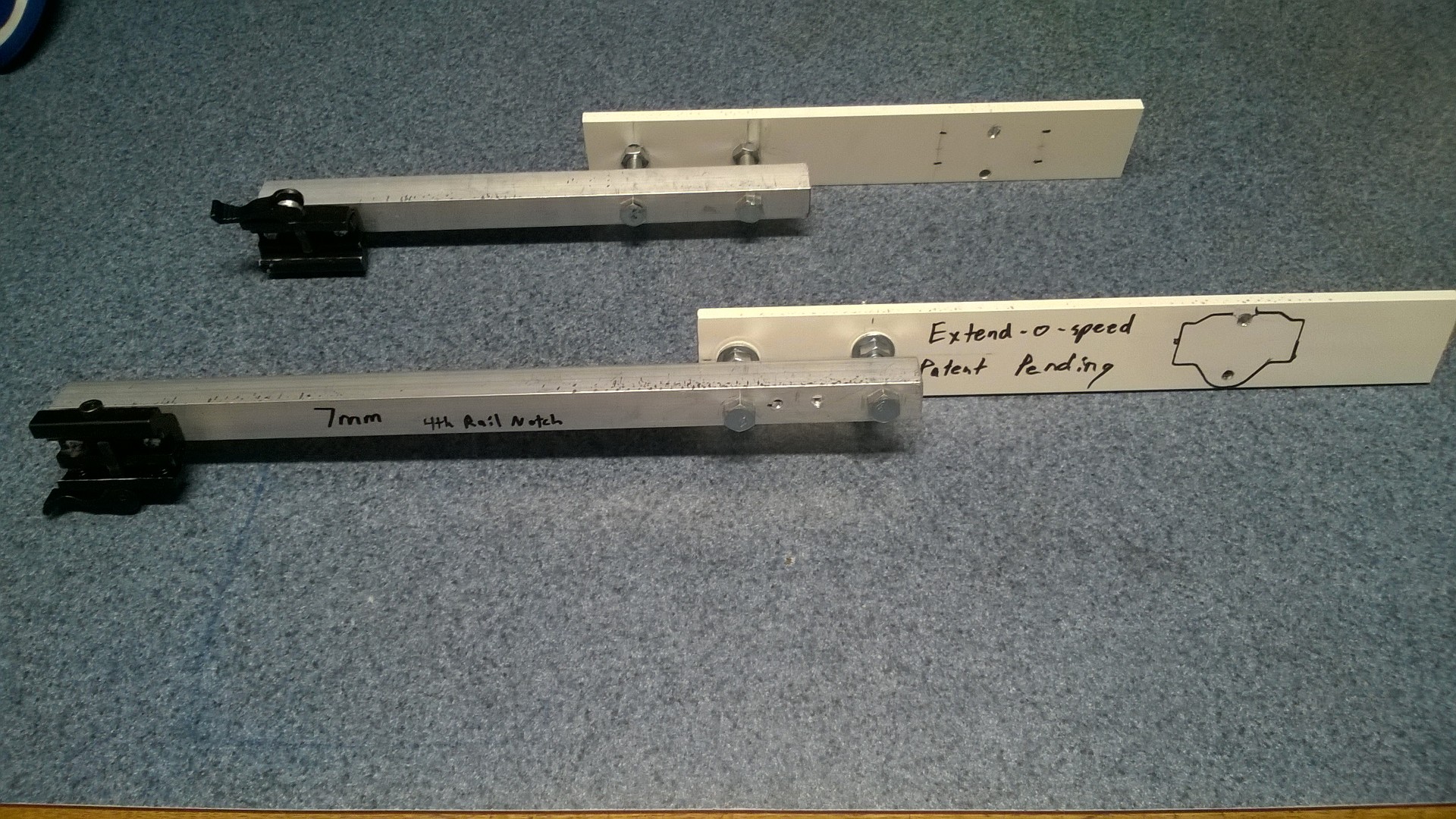

It definitely has my attention but I’ll be waiting for some of the follow up reviews and not be the first one to jump on it this time.
And yeah but the MPA doesn’t play with picatinny to my knowledge which is what I had invested in prior to the acra movement.

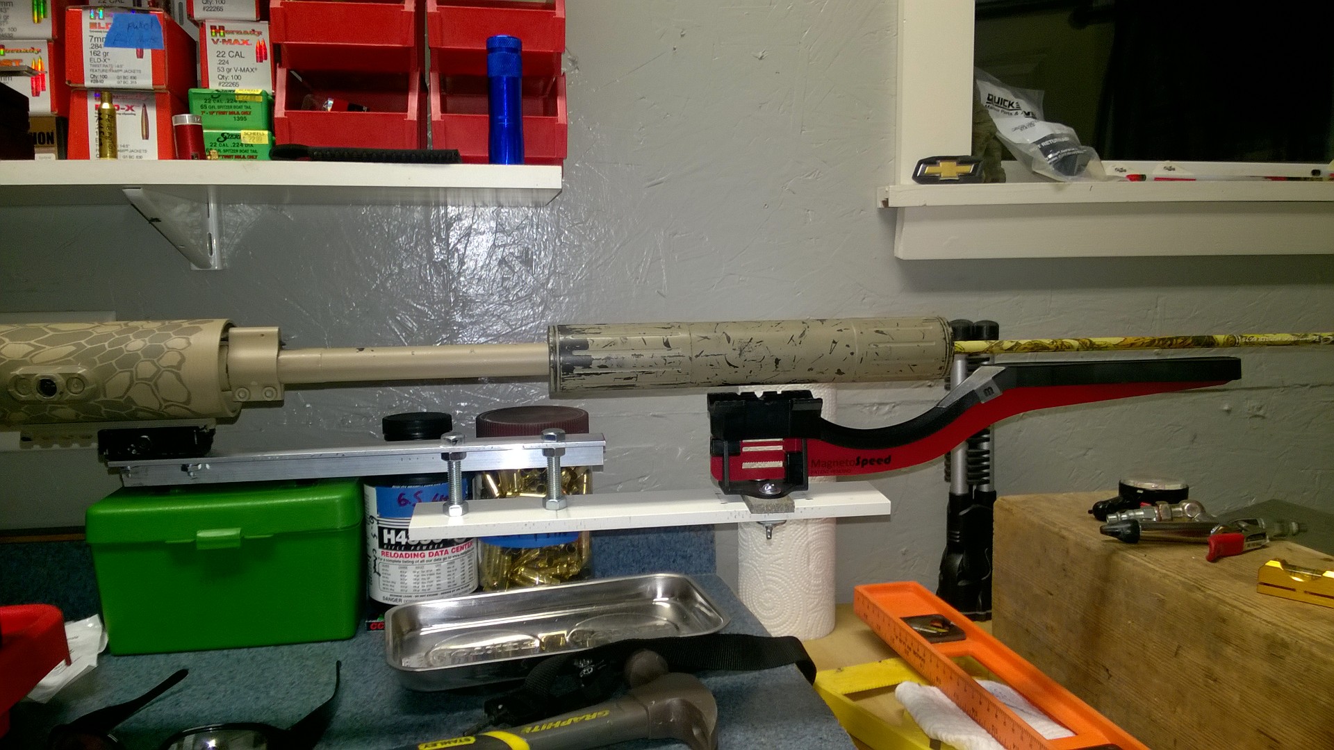

Does it work with the Sporter model or just with the V3?
We sell a Sporter compatible Version and a V3 compatible version. The differences between the Sporter and the V3 is the display mount given that the sizes and shapes of the displays between the Sporter and V3 are drastically different. There is also a different bracket that the bayonets attach too. Aside from those two pieces, the Sporter and the V3 versions are the same. You can also purchase those compatible parts separately if down the road you want be compatible with both the Sporter and the V3.

I see it's easy to adjust the bayonet up and down, and of course for barrel length, but I'm not seeing how you might adjust it side-to-side, which would be useful for rails on the side of a handguard, or those that are not perfectly in line with the bore.
Great question! To address this, we've designed the the slide mechanism to rotate about an axis that is concentric with the carbon tube. By rotating the assembly (and bayonet) around the carbon tube, you can adjust it's alignment for different picatinny offsets, e.g., picatinny side rails.

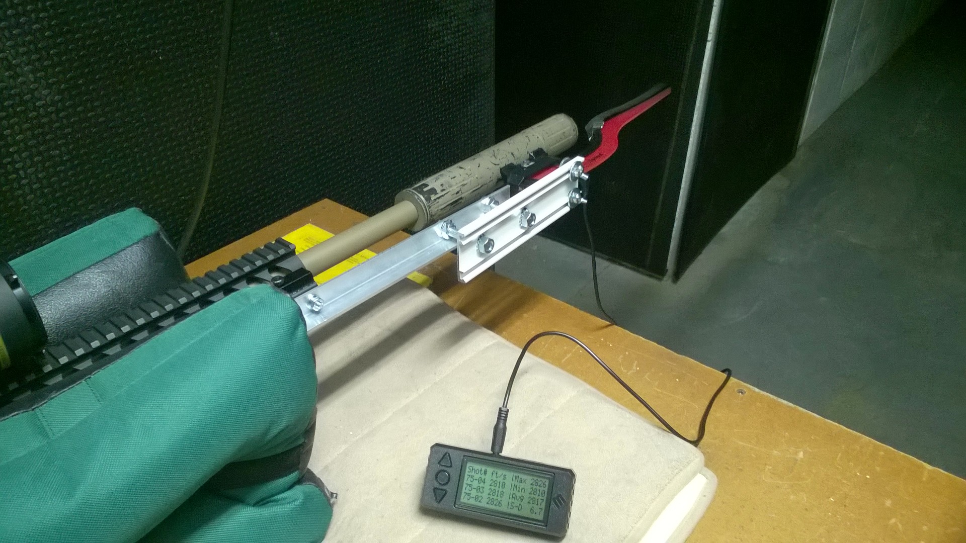

It is not chassis specific. ARCA rails are made for just about every stock/chassis. Sawtooth rifles, Area 419, etc all make them for different chassis and stocks
True, but I have picatinny rails on all of my rifles and have no desire to change everything over to Arca at this point, nor do I have a spigot mount. This looks like a cleaner solution for my use. Your needs are obviously different.

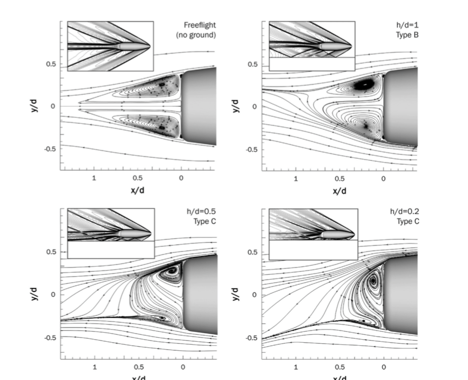

barrel harmonics are only a small part of the induced error of the bayonet attachment.
the aerodynamic friction and interference between hypersonic object (bullet) and raised ground plane (bayonet) pitches the bullet and will effect its POI. distance above the fixed surface, caliber, velocity, and the pitching angle of the projectiles path relative to the ground plane are all variables that effect the striking point of the projectile..
basic aerodynamics...
from the research paper..
The projectile was discovered to experience a marked pitching moment, initially nose-downwards at the high end of type C reflection interactions, then more strongly nose-up with contin- ued decreasing ground clearance, as the pressure distribution over the rear of the projectile was increasingly distorted by the build up of high pressure behind the series of shock/ground interactions.
there is your definitive answer.... no more speculation required...

@lash I have not done someone elses homework since 1984 and I can assure you she was alot hotter .. that said
first.. the paper is not my research, but was required reading, it s peer reviewed and I believe the data to be sound .. and again, pilots feel this ground effect on every takeoff and landing.. its a fact..
now to the differences from the research paper to magneto application..
first and foremost.. there are many more vairables at play than the paper takes into account
the surface is fixed and not moving.. they did do studies with angles and when the bullet was fired into rising surface the projeclite nose up rotation was assentuated.
it also doesnt take into account barrel whip and barrel harmonics, and the forces of the expanding gasses that accompany the bullet from the muzzle..
my hypothisis is this.. and its untested and unresearched
1 .. loads where the bullet is launching in the optimal barrel time where the muzzle angle is rising would be bringing the bayonet closer to the bullet at it was flying over it.. increasing the effect of POI climb.. loads where the muzzle angle where whiping low, would conversly pull the bayonet surface away from the bullet as it passes over, showing little to no POI shif on the projectile as the 'ground plate' is sloping away.
2. dump gas volume and pressure is differrnt for every load., barrel lenght etc.. also effected by brakes and cans that redirect or slow and cool the muzzle blast.. possibly explaining why most that shoot the system with those devices tend to see less of an effect and that is the case in my own AR as it has a 3 port lateral brake.
3. external ballistics are still in many cases magic as they are hard and expensive to study and effected by so many variables
I can say that with regard to magnetospeed many see the same movement of group as the bayonet is rotated... with the group alwasy moving away from the surface of the bayonet.
also, many have reported that even after buying off-barrel adapters of various designs, mostly for AR platforms, they still see a shift.. so it cant just be barrel harmonics and suface aerodynamic friction is a proven force acting on said bodies and fits the theory..

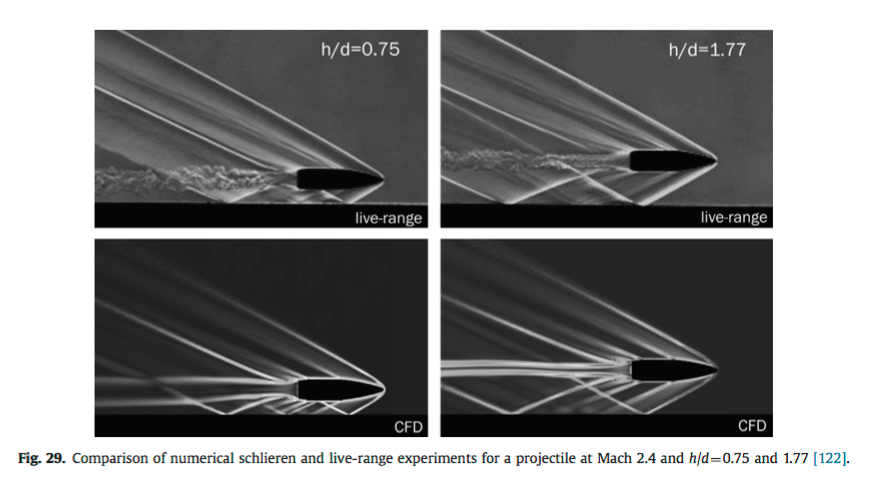

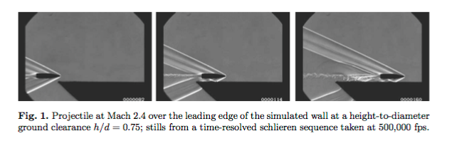

here you can see clearly that at a height of .75 of projectile diameter the shockwave reflections are interfering with the body, and the tail is loosing lift pointing the bullet up, at 1.77x diameter the reflection passes behind the projectile
expanded view of hight to diameter distance and effect of lift/drag at the boattail

I think like just about everything that I have learned in long range shooting, and aerodynamics.. and in the military in general.. the answer is ' it depends'
unfortunately there are just so many variables that effect internal and external ballistics that even if we took barrel harmonics out of the equation... as far as the weight of the magneto speed by attaching it off barrel, those harmonics are still in the barrel and will effect the launch angle of the bullet just as it does with no MS attached at all...
add
muzzle gasses
nearly infinite bullet shapes effecting mach cone shape
infinite velocitys etc
mounting deviation / angle, tension, and rotation
rifle recoil changing the position of the surface as the bullet flies over
etc etc
but yes.. if the MS was designed to reliably record (sense with accuracy the bullets passage over the 2 sensors) at an elevated height that was likely at least 1.7x its diameter .. it MIGHT fully negate this effect...
surface angle / at least in my case, is probably why my shift is greater than those that are using V3 that are level.. again.. I have done no extensive testing here.. but having experienced in flight and studied ground effect.. it was just common sense to me that these forces are at play here... to what extent, how to mitigate, don't really have that kind of time in my life and don't have access to the equipment the university in australia threw at this.
however.. without this type of experimentation .. no DEFINITIVE answer can be given to your answer.

what I am trying to impose on folks is that in the shooting community.. when bullets to funny things.. everyone always points to barrel harmonics.. but here I can clearly show that bullet interaction with nearby surfaces is a documented measurable force.
it explains bullet shifts on barrels with suppressors and brakes that are not perfectly concentric or perhaps have exit apertures that are a bit too narrow.. etc.. sure harmonics change any time something is put on the end of a barrel.. but this explains why there is still a shift when its NOT on the barrel
