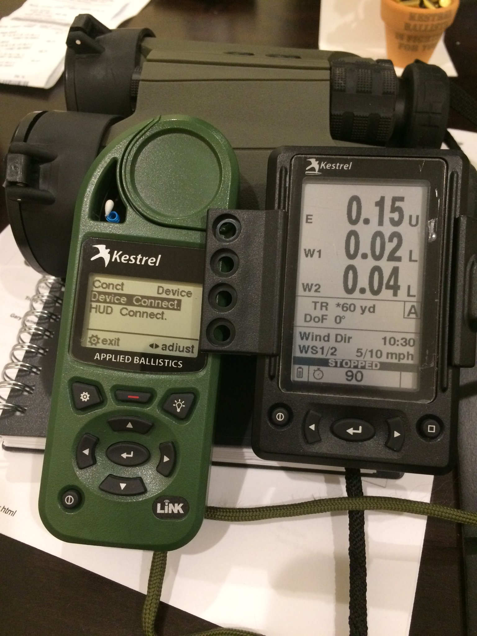

That is exactly what the Kestrel HUD will do. There will be an firmware update where you can Bluetooth connect the Kestrel to both the HUD and the Rangefinder and simply lase the targets and have them populate on the HUD screen.
That's great! I placed a pre-order for a HUD but wasn't charged a deposit. How do I confirm my pre-order?

Link connections will be directly with the Kestrel 5700/ Elite, links to all LRF that link to the Kestrel can be found in the Kestrel links section of this forum for AB Kestrels and in the Hornady Kestrel thread.

It will only work with Bluetooth models that work with the Kestrel. Here is a current list: https://kestrelinstruments.com/kestrel-3rd-party-software-and-applications
I believe the Bushnell Nitro 1800 *should* work but we haven't tested it yet.
Yep, the Nitro works nicely with the Kestrel (I've already done it). If we're wanting to skip the LRF entirely, you can update the EDope straight from the Kestrel itself, too, right? If so, I assume it's via the range card function?
Correct. You don't need a LRF for the HUD to work.

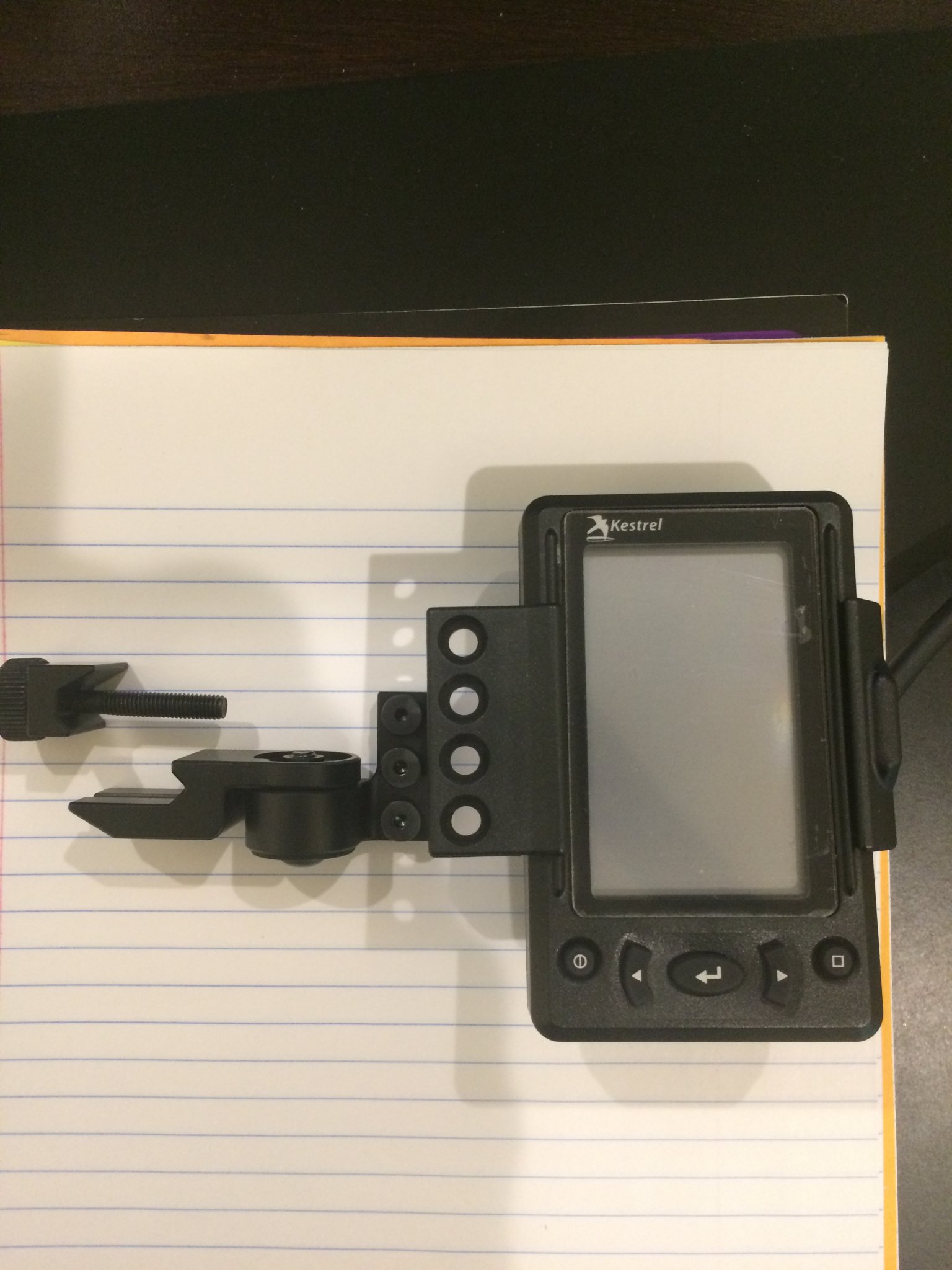

Ya, I'm dissapointed that it's delayed but I hope that means it'll be solid when released. I was just searching the videos and pictures the other day and it looks great. I'm pretty excited about it. I think it'll interface with my Terrapin and 5700 Elite well in the way that I use them. It's definitely a large device, I hope the data card bracket/ mount part doesn't suck or require 3 pic slots
The mount only requires one pic slot. I was able to slip it under my scope right in front of my scope mount when I got to play with the ptorotype at the Expo this weekend.

Initially the HUD will only be usable in Portrait mode. The mount is reversible to go on either side of the gun however. That being said, if we hear enough feedback about wanting Landscape mode, this is something we can consider adding with a firmware update down the line.
