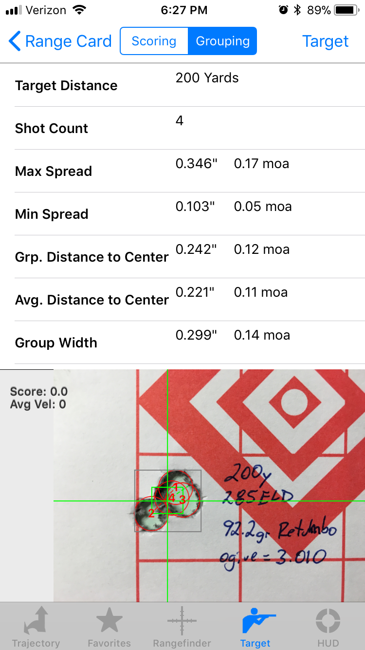

Well, I was finally able to get to the range with my latest round of loads for this thing. I was able to get the speed out of the Hornady projectile (especially with RL19; 77.5 gr got me 3010 FPS, and 78.0 gr got me 3030 FPS), but the grouping was for shit... like, 3+ MOA. H4350 is showing some promise, though... 70.0 gr to 71.0 is getting me 2925-ish FPS, and grouping looks like it might work out. The research continues.
Juggerxxx
Belligerents
Feb 13, 2017
396
81
34
#29
Wow I am impressed with those speeds. That is promising if you can get them to group.
Any seating test results?

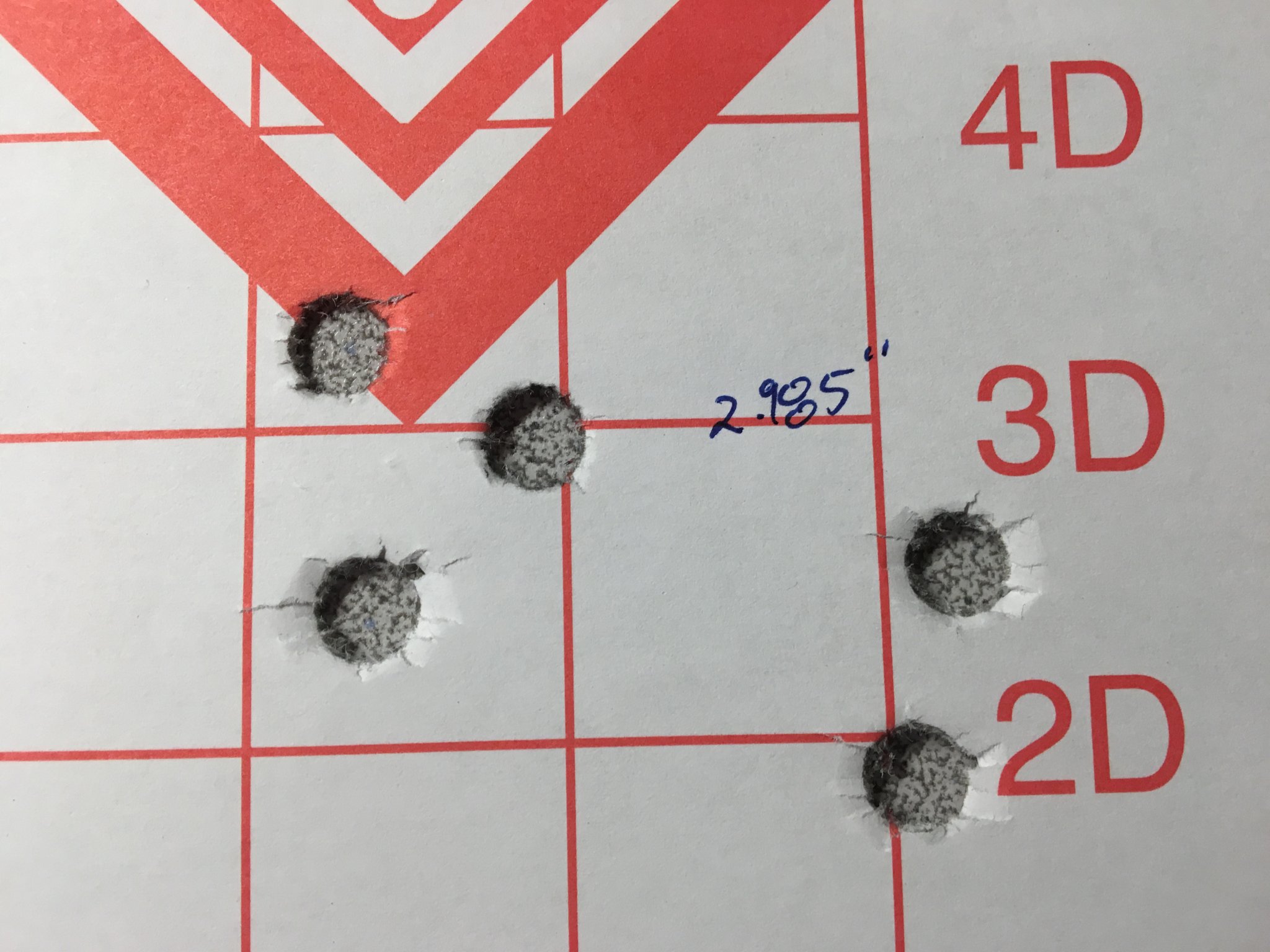

I have another 50 of these loaded up for another OCW test. This time I’m using Retumbo starting from 93gr up to 98gr. I hope Retumbo works out well so I can just stock that instead of two different powders. The Retumbo worked very well with the 285gr ELDs (338 Lapua Magnum).
This was at 200 yards

Geez, I couldn't shoot that well on my best day... anyhow, in regard to the seating depth testing, all of the loads that I put together with the Hornady projectile were .010" off the lands. Now that it looks like I have found a powder (or two; it looks like Ramshot Hunter may be a possibility) that looks like it may work, I intend to play with seating depth.

#31
Trust me when I say that is my best group ever and I almost shit myself as I saw the group develope. Not a fluke either because the next group was seated 0.005” closer to the lands and three of the four shots were all touching again but slightly larger group and the fourth was about an inch to the right

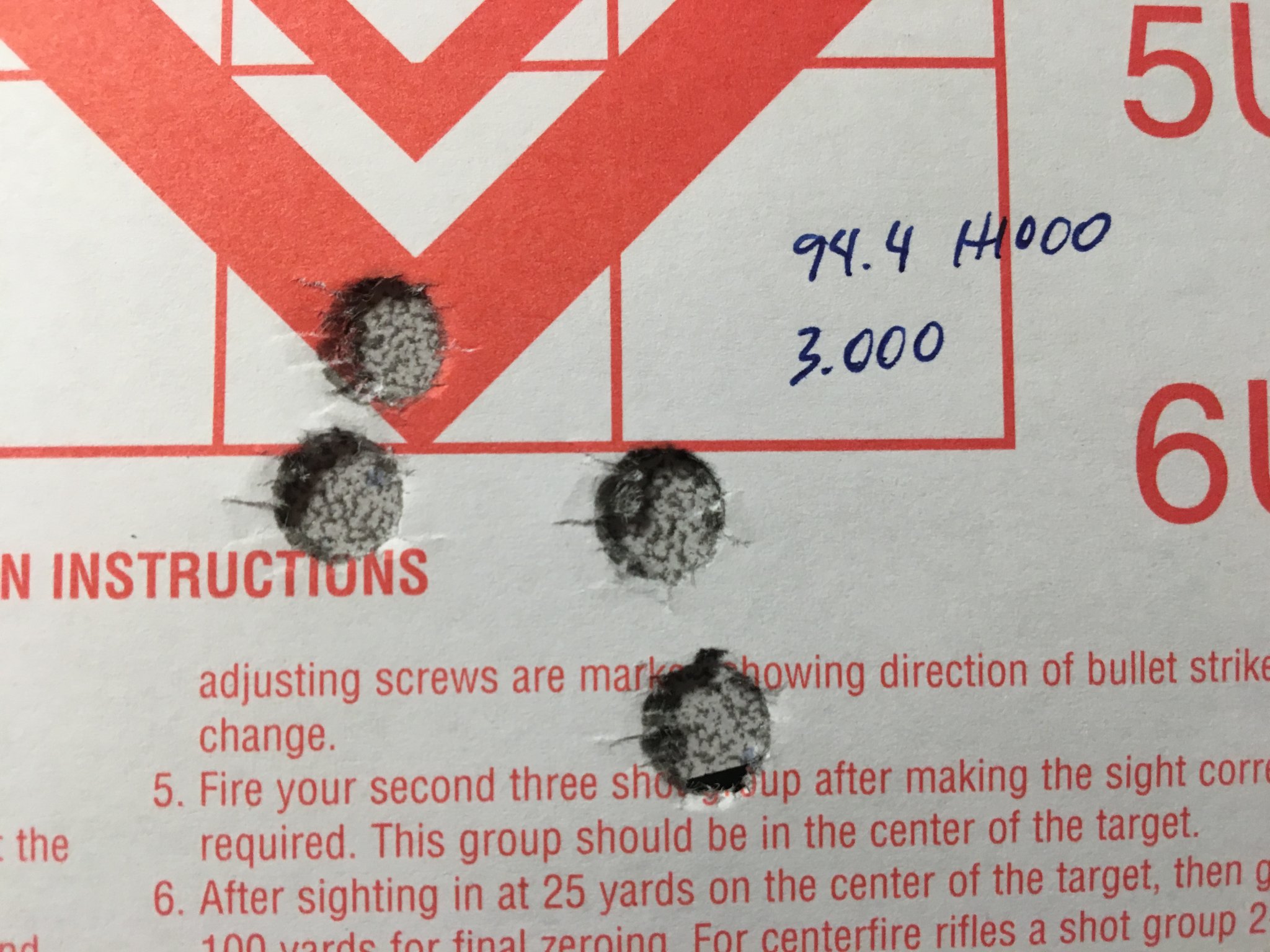

I came across this thread a few weeks ago looking for some 230 grain. Eldx info for a .338 RUM that I have. I joined the forum so that I could thank you guys for sharing. I worked up a load and had good success with accuracy, and now have some loaded up to check for velocity. I never worry about seeing how fast it goes until I know it will shoot.
Load wound up being 98.5 grains of h1000.
4 bullets 200 yards.

The bullet wound up being set right at .28 from the lands. My bullets with longest metplats were right at 3.750" shortest metplats were right at 3.746" most were right at 3.749". Those numbers are coal. Using the xlr 3.850" cip magazine.

Ok, update on this load.
I got back to the range on Saturday and had a chance to shoot some more groups and use my magneto speed.
The gun grouped almost exactly like the group in the picture for two five shot groups, and five three shot groups. Largest group was .42". I am happy with the load. My velocity was 3243 avg with sd of 8.7.
I am going to call it good for now. That velocity with that particular bullets B.C. should be good for wamping down about anything I want it to out to 700 yards or so atleast.

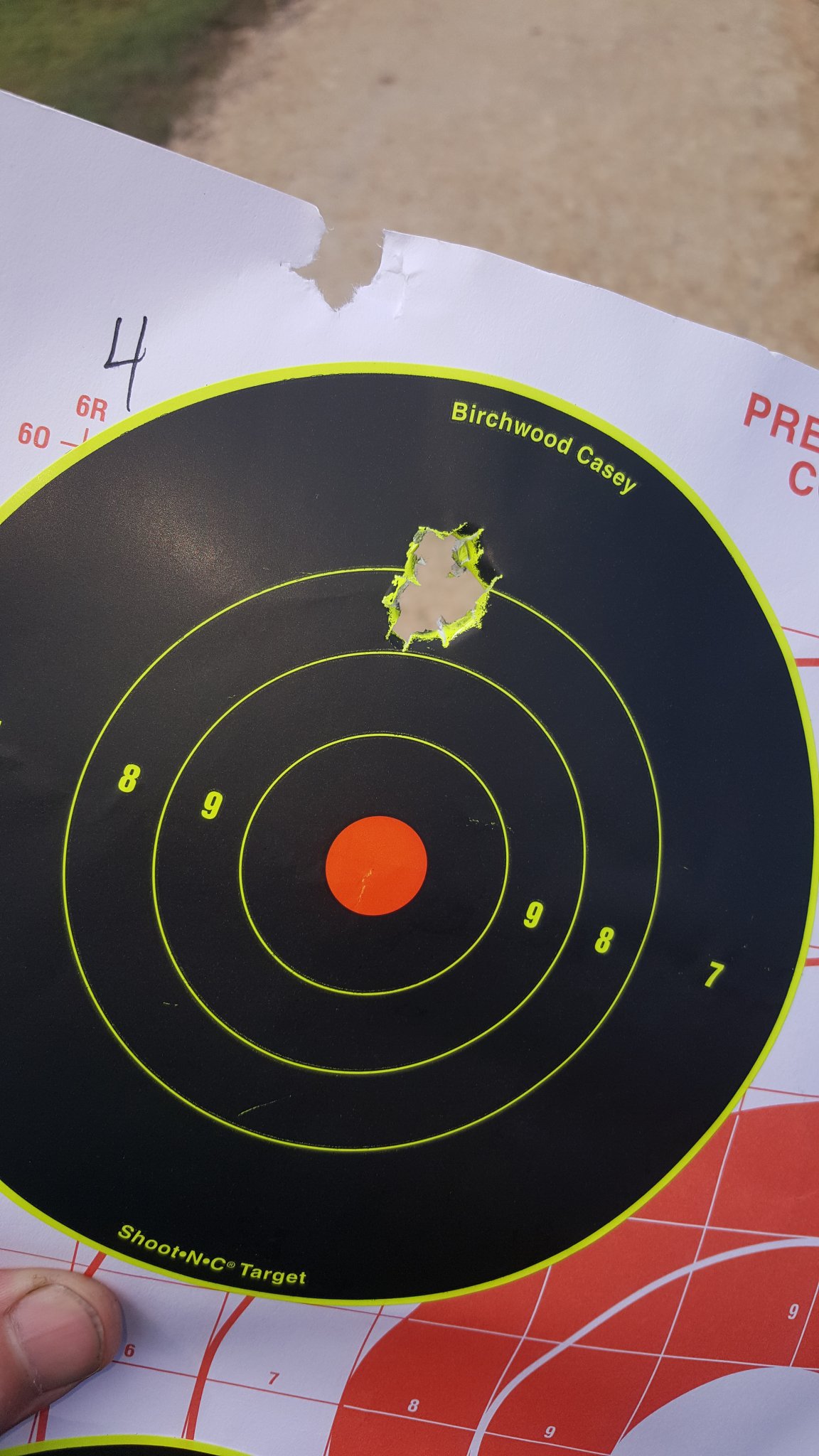

So this picture is of a 500 yard target when I was doing powder development.... before I did landseeting depths to pull the shots even closer.
So with the bullet kissing the lands I was getting a nice little cluster at 500 yards, 4.9" wide X 2.1" height. I do not have the target of the seating depth that was done at 500, but the 71.5gr group shrunk even more. IMG_7046.PNG
