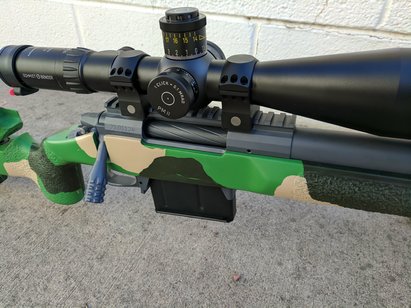

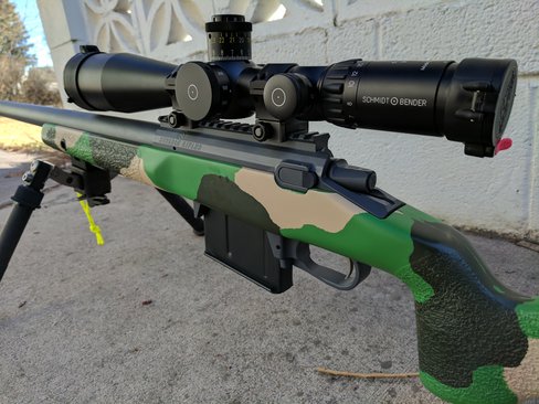

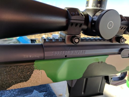

Sorry for the self indulgent thread, but I can't help sharing my excitement about my new rifle from Robert Gradous. Specs are as follows:
-.338 Warthog (Gradous' proprietary .338 Norma Mag IMP)
-Surgeon XL Repeater
-Surgeon bottom metal
-Bartlein modified MTU: 1.35" x 4", straight taper to 0.95", 5R, SS, 1-9.3" twist, 27.8" finish length
-McMillan A5 w/ KMW ACP (my custom camo pattern)
-Combat grey Cerakote
-Jewell Trigger @ 1.0lb
-TBAC 338BA brake (338 Ultra can still in jail)
-S&B 5-25 Gen 2 XR
-Nightforce high Ultralite rings (6-screw)
-Atlas 5-H bipod
300 yard 5-shot group with 300 grain Berger Hybrid, RL33, fireforming load (~0.2 MOA) IMG_20170226_171638.jpg
I have a few custom rifles in my collection now, but my experience with Robert Gradous really stands apart. The rifle is absolutely immaculate, and the attention to detail is up there with the best I have seen. Little things like including three pieces of fireformed brass threaded for a Hornady OAL gauge were unexpected and appreciated. And as you can see from the target above, I am blown away by the accuracy out of the box. 0.2 MOA with FIREFORMING LOADS. No load development whatsoever. I guess that is pretty standard for a Gradous rifle; he designs his chambers to be super easy to tune. From what I gather, Robert is an innovator when it comes to chamber design and lathe work, and it shows on paper. But what really made this experience stand out was the level of personal engagement Robert gave me. He spent a ton of time with me on the phone to understand what I wanted to do with my build, and he provided expert advice. I went into this project thinking .338 Lapua, but ultimately settled on the Norma case based on Robert's detailed justification. He provided me multiple status updates along the way, including pictures of my gun in various stages of assembly. We have had multiple conversations about reloading, cleaning, load development, and just random rifle stuff. What an awesome experience! I can't tell you how great it feels to have the name of such a kickass smith show up on my caller ID.
I know some people on this forum have had issues with Robert as a builder, but that just wasn't my experience. He was highly communicative and (believe it or not) way ahead of schedule. I think maybe I can attribute my experience to listening to his suggestions and trusting that he knows way the hell more than I ever will about building rifles.
Anyway, I can't speak highly enough of my experience with Robert. He is a master American craftsman and I feel lucky to know this patriot.

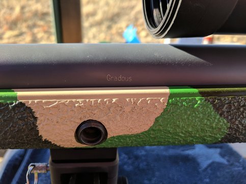

Worth every nickel, it's gorgeous, congratulations ! (You and Robert !). I love the engraving of his name on the barrel. Small and inconspicuous. The inquisitive/appreciative/in the know will find it and break the all knowing smile (to themselves only). The majority will likely just pass right by it and never even notice. You possess a piece of art that very few people will ever will. This is truly an heirloom piece. You do have a suitable heir, correct ? If not, let's talk ;)

That thing is sweet and I really like the stock. Is that light and dark green? I want to order a Gamescout with a green themed mcflame but was having a hard time deciding on colors. I want to make sure they stand out enough when swirled together.
surgeon260
Belligerents
Jan 26, 2014
484
242
49
Colorado
Yeah it is light green, dark green, and light tan.

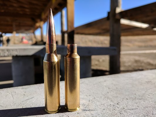

If you are looking for the why I'm afraid that is beyond my expertise. Keep in mind that this is a min taper 40 degree Norma improved and the capacity is probably very close to a standard Lapua round. It might even exceed it. If someone wants to post their Lapua H2O capacity I'd be glad to measure one of my fireformed cases. I've read a lot of subjective stuff about short and fat cartridges being more efficient blah blah...maybe there is some truth to that.
Maybe someone more knowledgeable than I will chime in.

Greater case capacity.
The shoulder is pushed forward and the neck is shorter.
The standard Norma case capacity is about 7 grains down on the standard Lapua. The Warthog closes the gap, but the difference in velocity has more to do with the efficiency of the Norma cartridge.
fdkay
Gunny Sergeant
Belligerents
Nov 27, 2009
4,428
1,005
219
57
Ingleside, Tx
You are right, of course, I was thinking warthog v norma.
The lapua and norma cases can be though of in terms of the .260 Rem vs 6.5 CM, the Norma has less capacity than the Lapua, but when using the heavier, 300 grain bullets, the Norma doesn't have as much case space taken up buy the bullet.
With the lighter 250 grain bullets, the lapua will outpace the norma, but not with the heavies.
