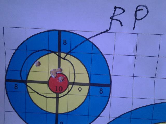

I'm not used to reloading new brass so a couple of things came up.
I went to dry lube in the neck for used brass and has not given problems I have found.
Got some new sig brass for 300 blk, trying to rid myself of fliers. Lol
Small dents in necks otherwise looks good.
Plan on fls and a quick tumble to get off wax, process normal as needed to check it.
Will my normal dry lube "neck dunk" be sufficient While seating?
Hopefully the move to new brass will get me past the 1 in 5 fliers ruining some nice groups.

I was switching from range brass and brass fired in our 3 different 300 blk guns.
Mixed head stamps etc.. so was figuring any new brass would be more consistant.
My powder is weighed digital, and then trickeled to within 0.1gr.
The 12.1gr of cfeblk pushing a 220 fbrn has been the best out of a good deal of trials.
The thing about the new brass is I prefer the dry lube but have not used it in
clean new brass. Will it be sufficient since the brass has no buildup?
Many decent groups spoiled by the 1 flier.
Could cover it up with calipers but want to show my delema not show off.

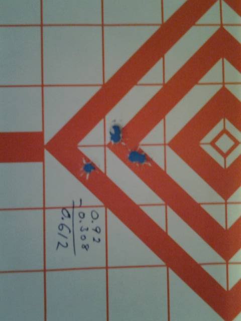

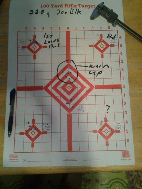

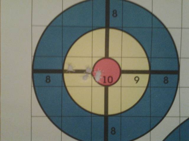

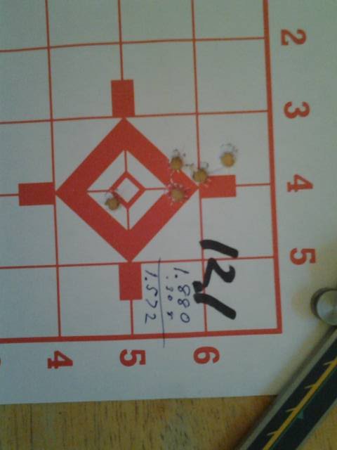

So the quest for the best sub continues.
12.1 cfeblk cci 400 primers Hornady 220 fbrn and now new sig brass.
At 2.1 coal the bullet just does sit on the powder.
The sig brass was dented on some of the necks so I ran them through a sizing die.
A quick tumble to get off the sizing wax.
Neck tension measured 0.0025 and a light crimp was used.
Rem 700 AAC 300blk 16in in a magpull stock, nikon 3x9 and bags from a bench.
The new brass cut my fliers in half.
Sadly the remaining fliers are at least 50% all on me. I called over half on the trigger break.
My eyes are needing new glasses and with the stain by the 5th shot, it wanders a little.
A crono would be nice, see what santa does?

Groups are looking a lot better man... New brass seems to be working. Now, shoot, load, repeat...
