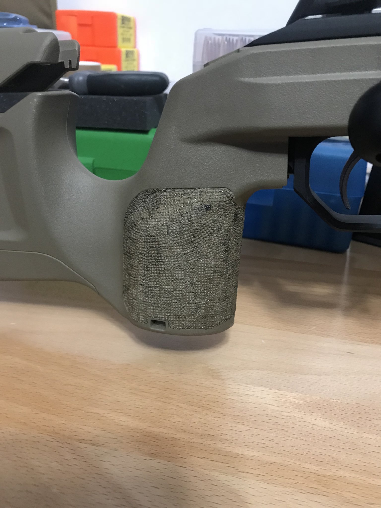

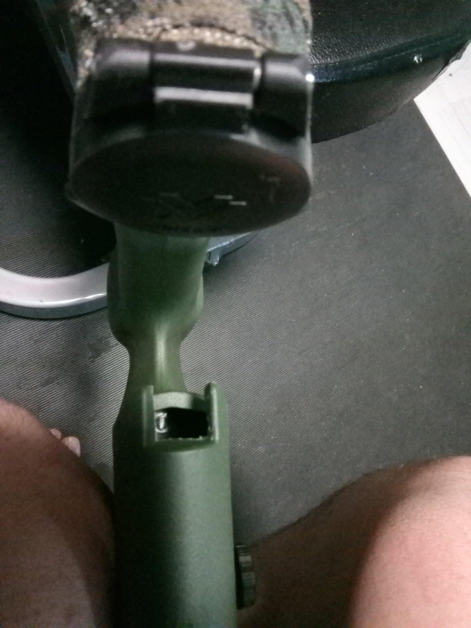

That´s very nice looking, how does it feel in the hand?
I just went with grip tape, used heat blower to get it sucked up good in to the grip.
This is how i added my tool less butbad on to my chassis, KRG pages this is mounted a bit differently.
I use these LOP spacers between the chassis and the tool-less buttpad mechanism, not the other way.
You just need to drill a little area off the material on one of the spacers, and you can do this mounting.
You do not add the weight of the spacers on that buttpad mechanism, and less body torque too, and i think it looks better too.
This will work only on Bravo chassis.
This is how KRG tool-less buttpad is mounted on the factory mode.
