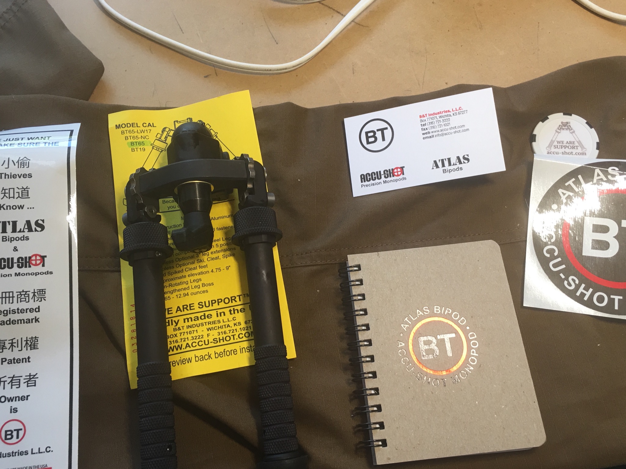

Wow. I received my Atlas Cal today. First off this community provides great customer support and service and that certainly holds true for B&T Industries. Special thanks to Kasey and Brandi for squaring me away. I have several Harris bi-pods but this is my first Atlas. You immediately see the difference and the quality craftsmanship that is put into this product. Thanks again!!

Mine showed up today and from the little bit I have played with it I'm impressed. I'll take out and shoot off it Wednesday after work. I already like it better than the PSR I sold off to but this.
