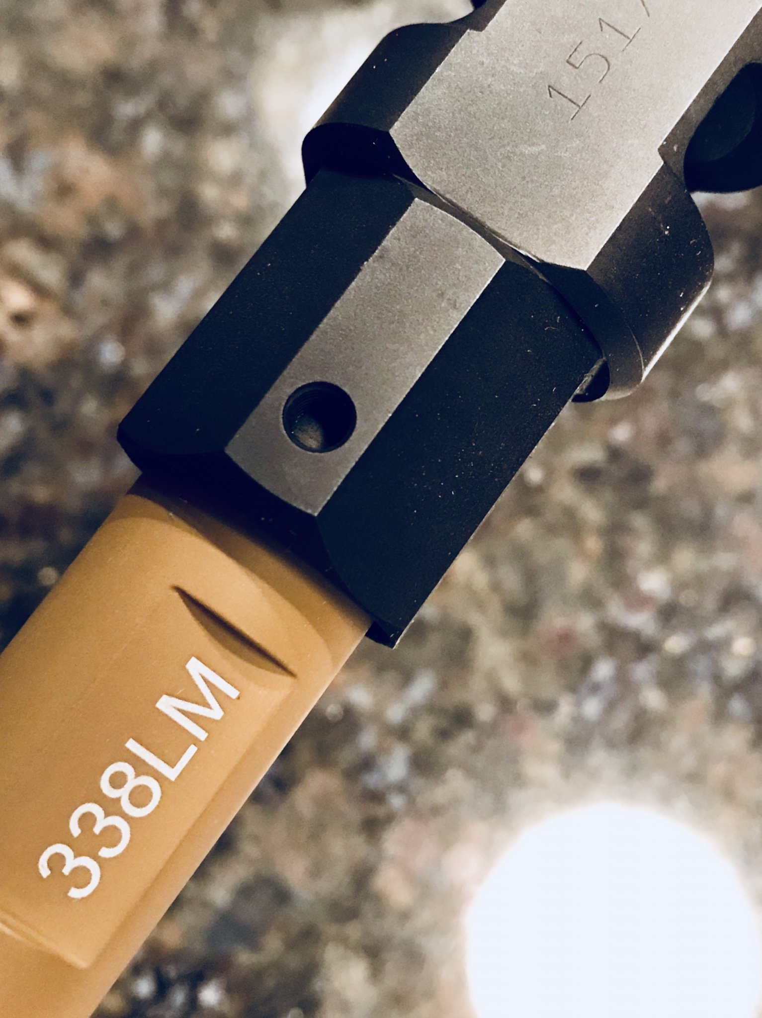

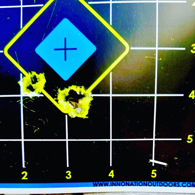

Getting my new rifle set up, and loving it so far.
System - AI AXMC .338 Lapua, Nightforce 7-35 ATACR F1, and Spuhr mount.
A few questions:
1) Ammo Choice - I started out with the factory Lapua Scenar 300 gr rounds, thinking that I'd like to do some long distance in the near future, and might as well gather data for the data book based on that round. Is there any advantage to shooting the 250 gr for close in work, or just stick to one round? When when getting the 300 yard zero, all my rounds where in essence in the same hole (admittedly a larger hole), once I shifted the windage right.

1, just stick to one factory Ammo and collect the data.
