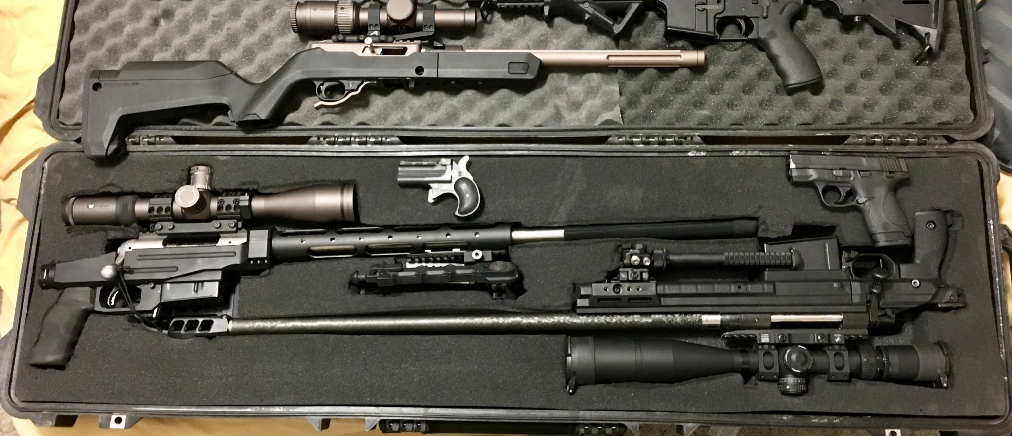

Took this pic to show a friend but it shows two full size rifles in a pelican 1750. They both have folding stocks though.
Edit: “sticks” / stocks. Same thing
