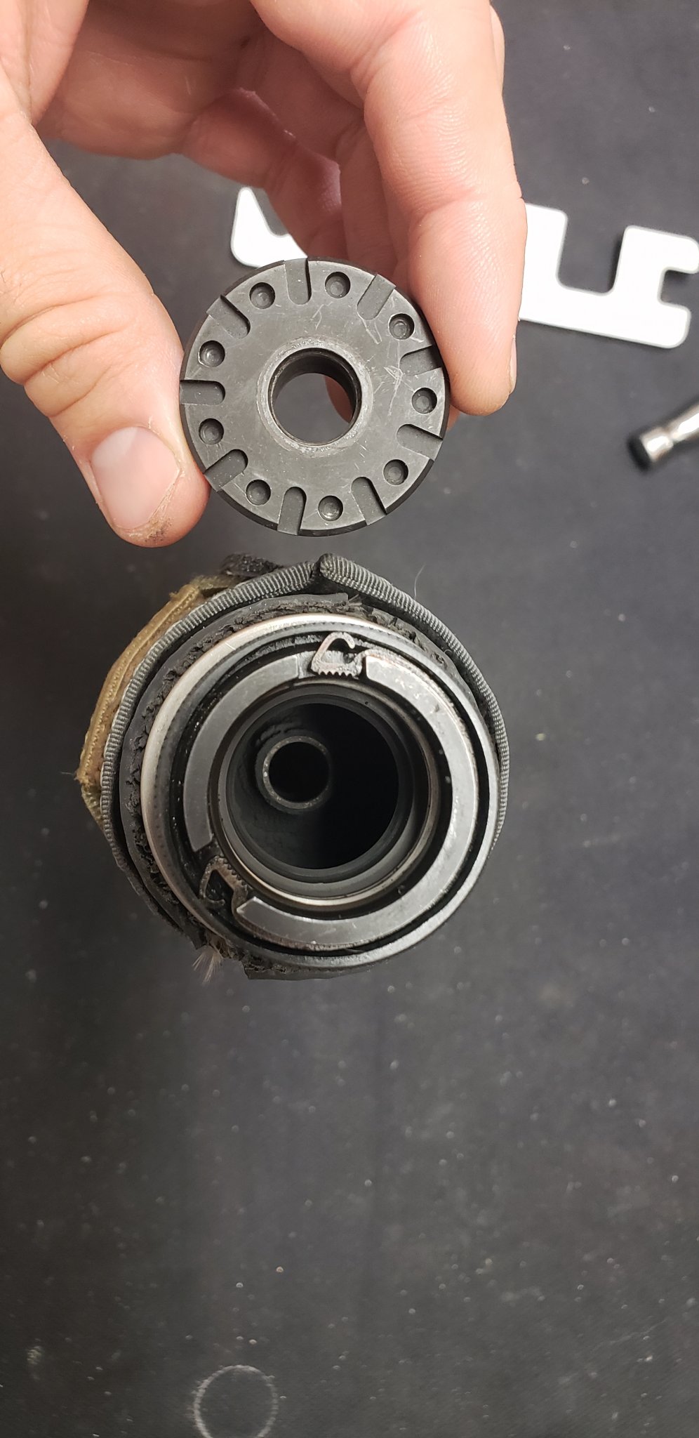

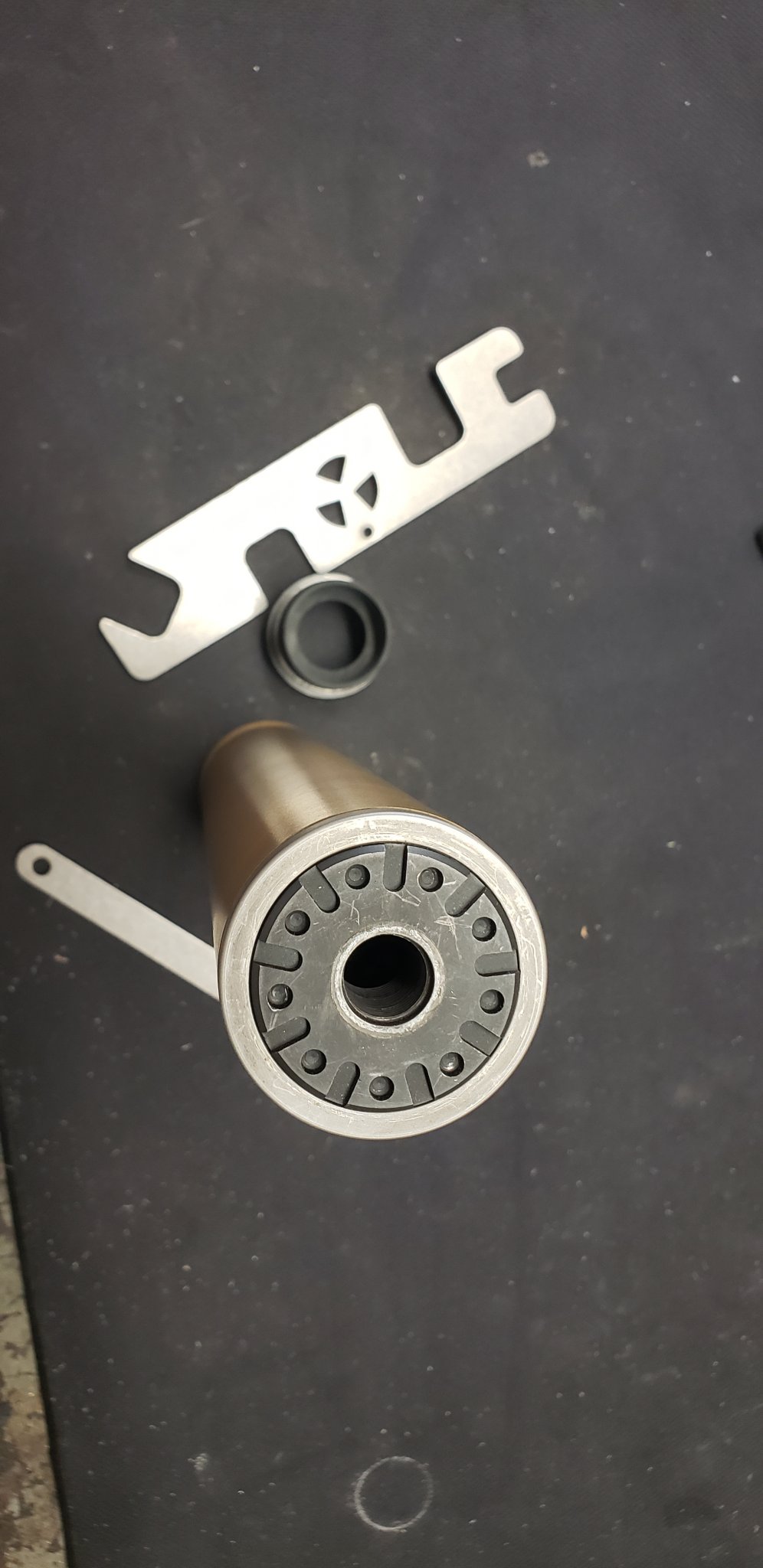

Viper the big bore harvestor has swappable mounting options, 5/8 direct thread insert or you can run the asr I do both on my rifles. My previous comment was in regards to end caps because you stated it had swappable encaps which the harvestor does not. Big difference in terminology between encaps and mounting options:). Hope that helps clarify for you
Like I said I have very limited experience with suppressors...
(I considered the mounting surface as the read endcap.... lol. Shows what I know. )
How's the build quality/durability? Both of the local class 3 shops were steering me away from the SiCo products.

Mine has over 3k rounds on it across all my calibers and 1k of that is 338 LM pushing max loads. No issues so far other than the anchor brake will kit loose dirt up like an Oklahoma F5 tornado if you do not choose your shooting position well. On the other hand that anchor brake will reduce felt recoil very noticeably. It is very light can but I cant speak to long term durability yet as I have only had it for about 1.5 years now. Big bores are an aluminum sleeved can with an all 17-4 steel baffle stack ultras are 100% titanium so there is a cost difference there in build materials. Sico has a burned alot of bridges in the last 2-3 years unfortunately and if I did not already have sico cans, I am not sure I would choose to support them all over again. With that said ALL of my sico cans have performed above my expectations and the build quality/performance has been stellar. TBAC is run by great guys and has arguably the best customer service of all the major suppressor companies current in business you cant go wrong with a 338 ultra either :).
