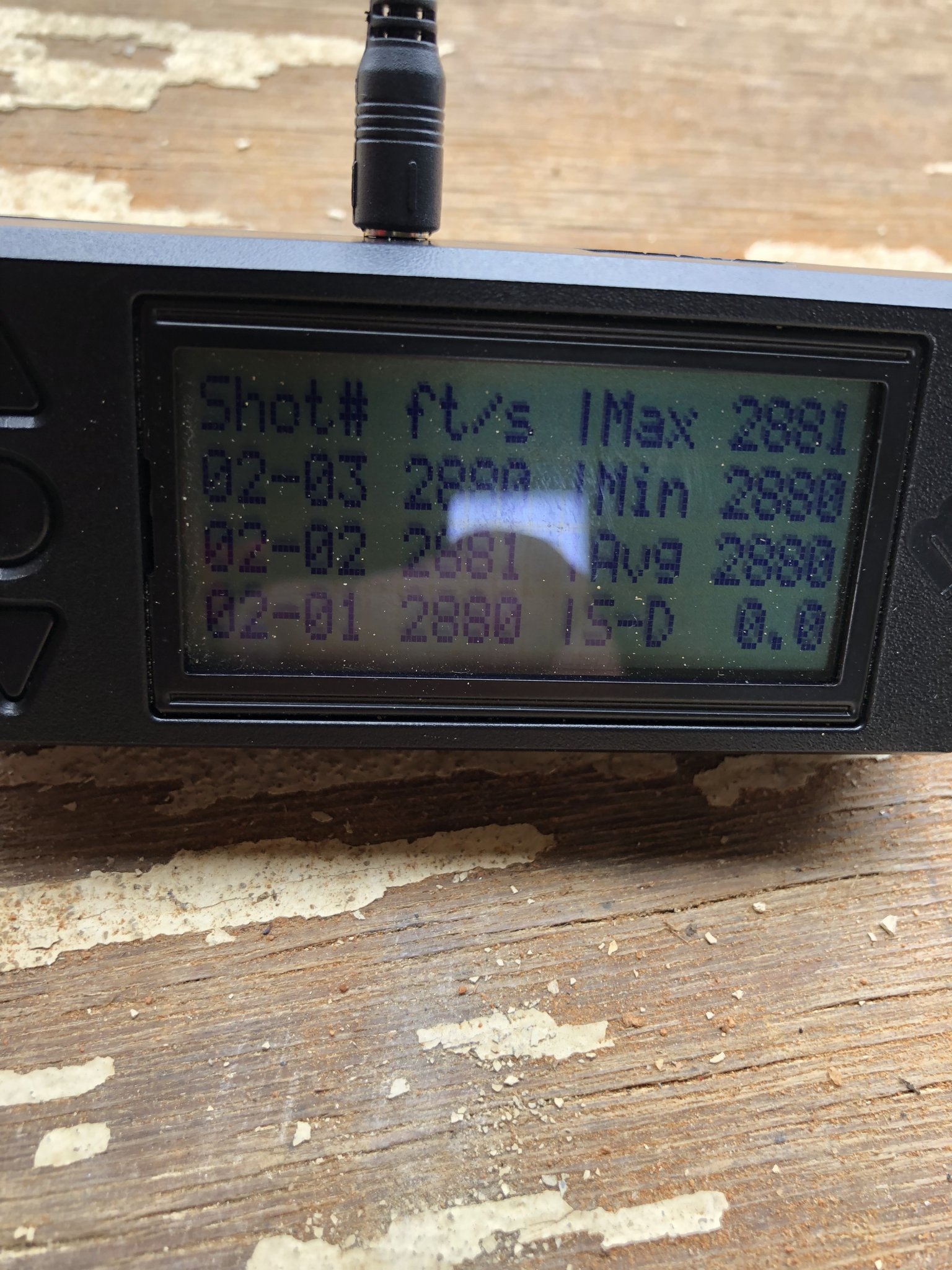

I neck down LC LR brass for my bolt 260, as well as gas 260. I found i had to bump the shoulder back a bit because of the little donut bump that’s formed from the resizing, and i was golden. I don’t fireform, just load and go. Bolt gun has ES/SD of 2/0 and gas gun gas ES/SD of 10/4.4. I never had to neck turn a single piece of brass, and I’ve fired over 5000 rounds Combined out of both guns. Zero issues

i would love to see a 10 shot string over a chrono showing an ES of 2 with an SD of 0. I'm not saying its impossible, just highly unlikely.
curious to how many shots you chrono'd for this result.
