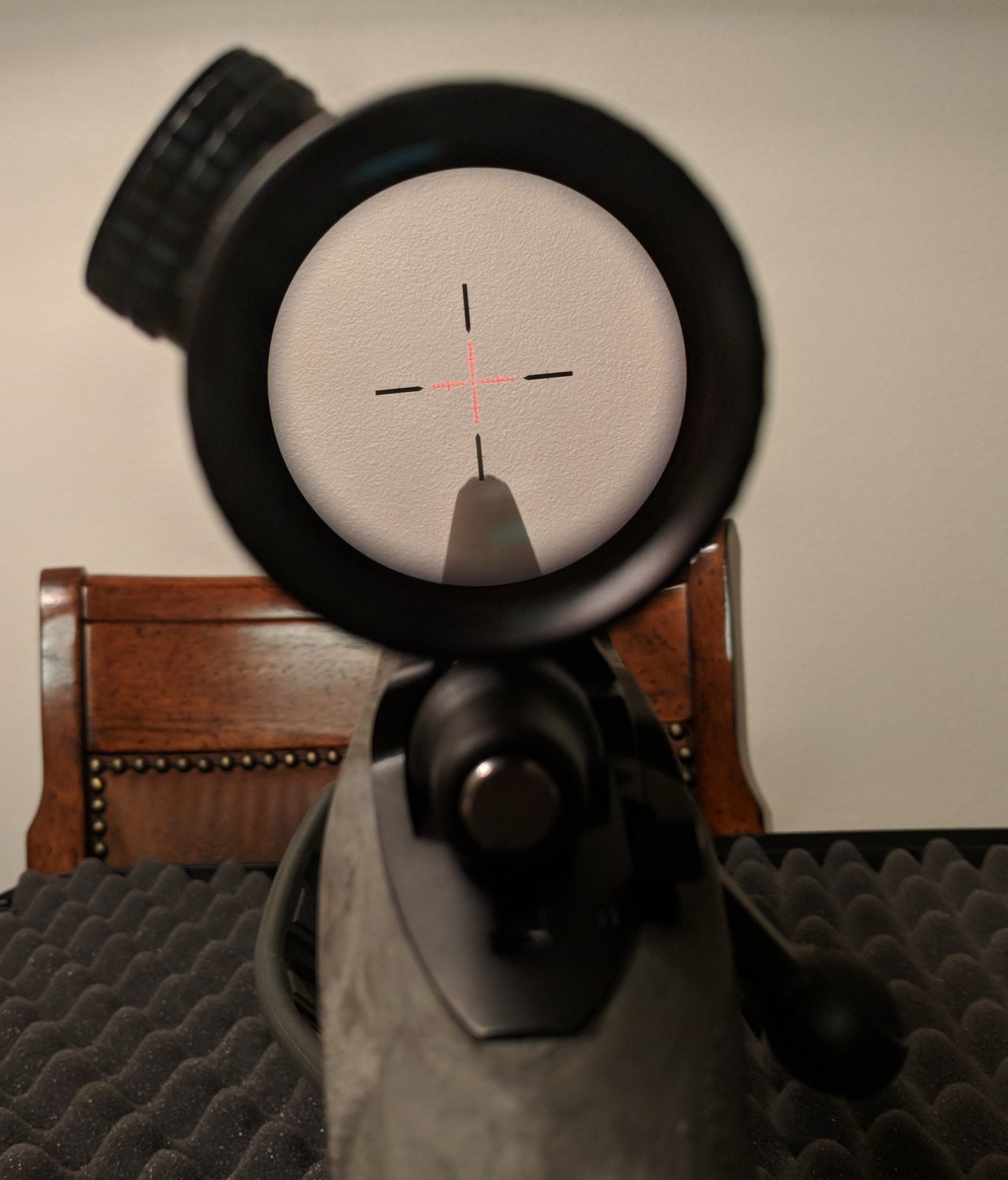

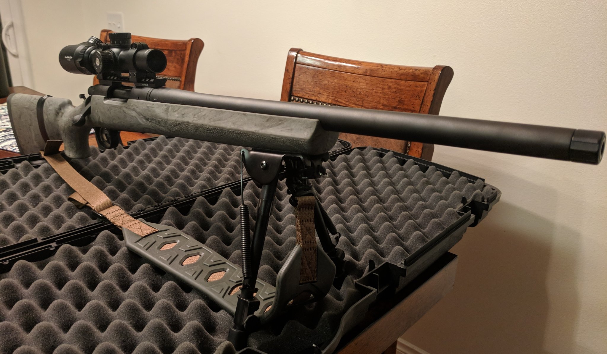

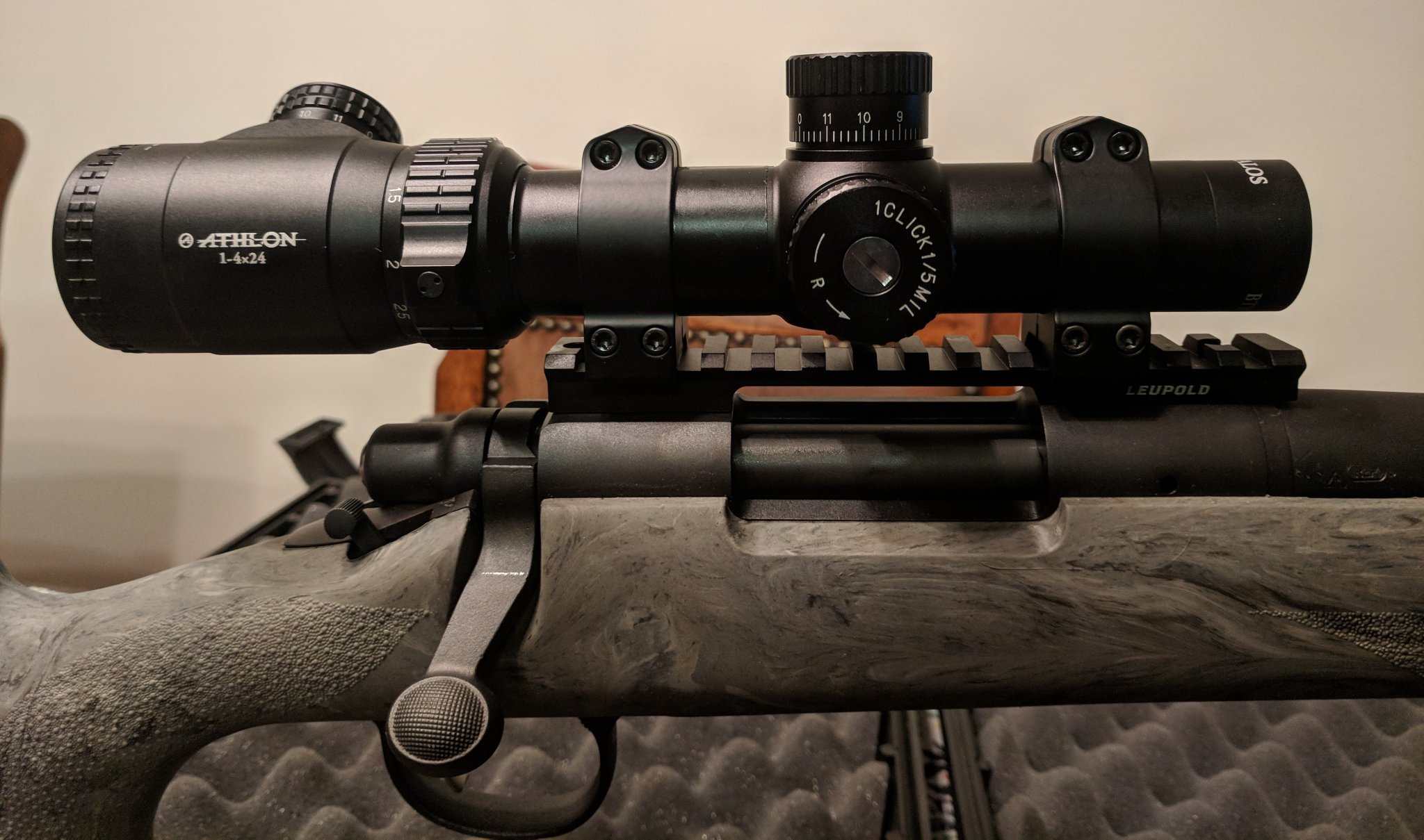

Hey everyone!
I'm sure that the Rem 700 AAC-SD has been discussed at length so I won't ramble! Just wanted to show everyone my new rifle, which is my "first" bolt action. I did grow up with a hunting rifle (.270), but it was gifted to me. Built this to use as an Alaska brush rifle for hunting moose and caribou.
Specs:
Rem 700 Tactical AAC-SD
.308 heavy barrel
Leupold pic mount
Warne PA rings low
Athlon Optics 1-4x24 Talos BTR
Allen Bighorn sling
Bipod (not sure of brand anymore)

To free float your barrel and gain some accuracy if you plan to keep in the hogue stock you can place shims under the action between the recoil lug and front action screw. You can make shims from a soda can. Stacking 4-5 strips should do it. Did this to mine and a couple of my buddies AAC-SD's and it improved accuracy immediately.

Nice setup, I have the same scope on my varmint hunting rig and it has held up well.
I'm happy to hear that because I've only been able to find a few really short or not a all detailed reviews. I am pretty rough on gear so I was hoping it'll last and stay zeroed.

I had considered switching stocks and or bedding the barrel and action. But for me the reality is it's most likely never going to be used over 600m, and only on big game. So really sub MOA accuracy just isn't even worth the effort. The only thing I really see that I could gain from a new stock is maybe something a bit lighter as the Hogue seems pretty heavy.
I appreciate the advice though and will defenitely consider it if I get more serious about accuracy!
