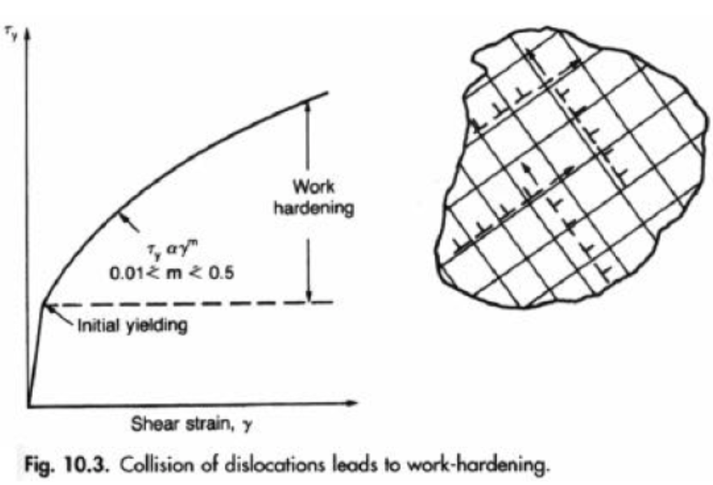

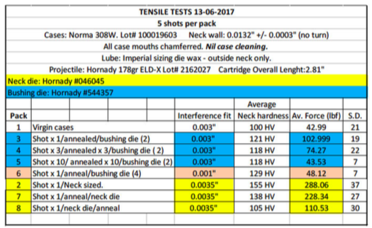

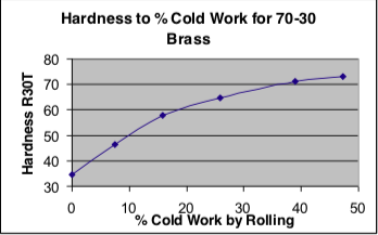

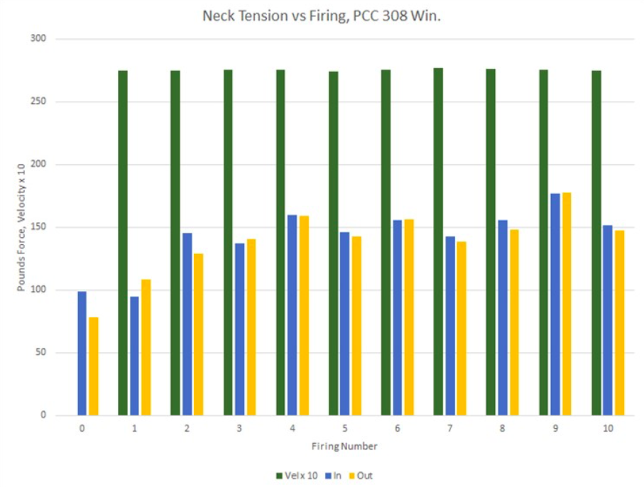

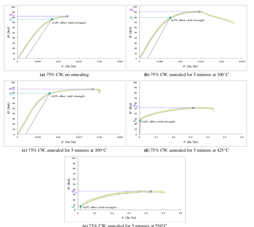

The can of worms that is annealing. I hate getting into these conversations with anyone in the outside of industry because of 90% of the conversation revolves around guys trying to justify their own purchases to themselves/others. For me, I personally don't think annealing is worth the money or time for the return on investment. For the price of an induction annealer, $300 to build by yourself, to $1500 for the AMP, I feel the money would be better spent on brass/bullets/ammo.
My original assumptions were just that my case necks would outlast my primer pockets.
Researching into it beyond fudd talk...

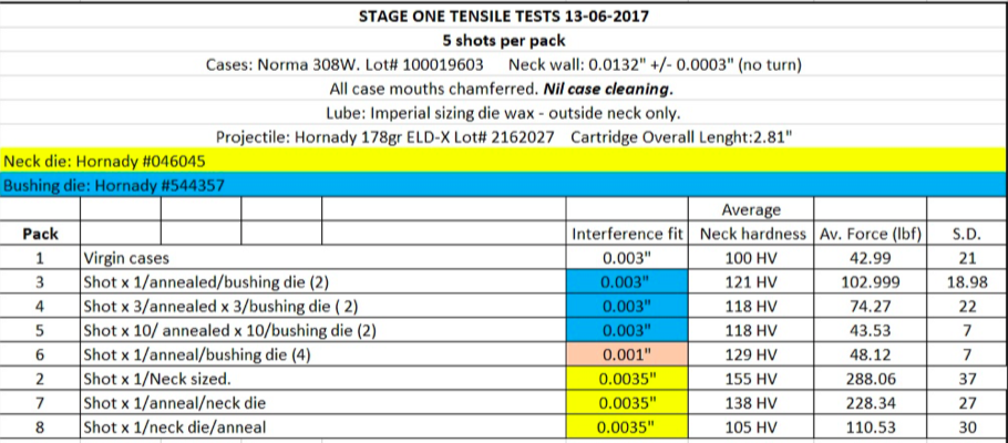

- If we look at the articles AMP did on the effects of annealing on case hardness, they DID NOT have a standard. Out of those three articles, I think there were only two or three attempts at comparing unannealed brass vs annealed brass. Most of these attempts weren't more than just one use unannealed. The articles did make good points on other topics.But in terms of the benefits of annealing versus not annealing, they had no data. This leads me to assume that though the hardness of non-annealed brass increases, it stays relatively similar and grows harder minutely once it reaches its "peak" hardness from firing.

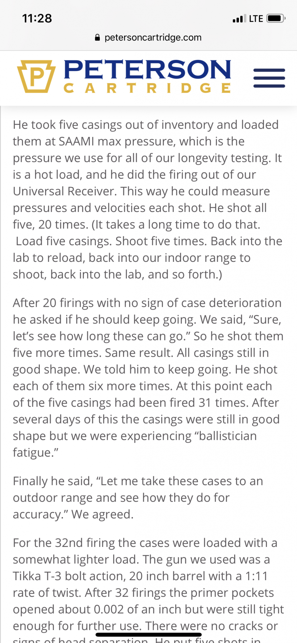

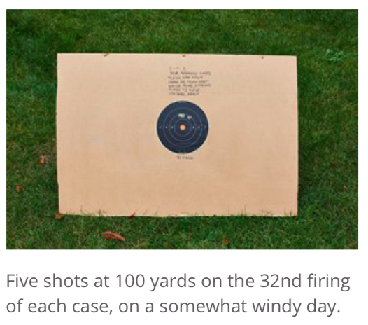

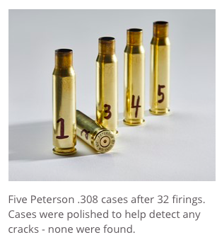

- Peterson did 10x firing and talked about case neck tension. Looking at the data, the case neck tension would rise but then taper and remain constant, confirming my earlier assumption.
- In 32 firings by peterson, they reloaded a case 32 times. The end result was a 1.5 inch group at 100, with primer pockets opening 0.002 in 308. I am trying to confirm if this was annealed or not. I will update, but if it wasn't annealed, this pretty much craps on a ton of the benefits of annealing. CONFIRMED! During the testing, the brass was not annealed/load developed, and just jammed into the neck @ 9/9/19 10:30AM
- Ryan Stevenson's research found that flame torch annealing was inconsistent. His primary opinion was to drop annealing all together. The secondary opinion was to use cartridges that haven't been annealed in competition,and to the flame annealed cartridges for practice only. Biggest finding was the suggestion to use an induction annealer with accurate control of time and temp as well as annealing on a consistent basis, not every other time because the hardness would return as if annealing hadn't occurred. He also made mention that neck turning could probably be more of an effect to case life than annealing
- John Klein's paper, I looked at the data for non-annealed brass and saw that it looked logarithmic.
From just dissertations and research papers, I ended up getting these points to bring up:
1.) For precision reloading, where consistency is key, flame annealing is not enough. (I'm not taking away for wildcatting, or for ease of resizing, etc)
2.) If annealing, induction is the only way to go. This leads to the GinaErick ($300 if you had some parts, +$400 if you had to buy all the wood and maybe even tools), Annie (484 for just the machine, no coils), or AMP annealers($1500 for the machine, no pilots).
3.) Case hardness probably tapers off and remains relatively constant. Most of the articles I had read only went up to 10 or so, but the data showed that it was building to be a logarithmic function. At the point where it approaches max infinity, like my original thoughts, its either a cracked neck/shoulder or loose primer that will junk the round.
4.) For the price of 500 pieces of Peterson brass at $370, it would be $0.74 per piece of brass. At 5x firings/2500 rounds fired, it would be $0.14 per round, and if you made it to 8x firings/4000 rounds fired (pretty much where I am at now, with the same SD/group size as when I started) it would be $0.00675 per round. At this point, the cost of an annealer could have been used to pay for the new barrel and gunsmithing associated.
5.) On pack 4 of the second article of Under the Microscope by AMP, they brought up the use of dry or spray lube on the neck. Because I use an expander mandrel to expand the ID of my necks, I use dry and sometimes spray lube to prevent galling. Possibly this has helped to counteract the hardness/increased springbuck of my ammo and kept my SD's down.

John Klein, Recrystallization Behavior of 70/30 Brass
Ryan Stevenson, Characterisation study of brass cartridges for high-end competition target shooting
Annealing made perfect, "Under the microscope"
Peterson Cartridge "32 Firings"
Peterson Cartridge "What happens to Case Neck Tension after repeated firings?"

@frost1235 if you get an arbor press with a pressure indicator, you will find that all kinds of things work negatively against seating pressure. Consistency of carbon (none, minimal, hardened), what was used to clean the brass, brushing, how long ago the necks were brushed before seating (hours/days vs weeks/months -- think tarnish), chamfer angle and depth, FB vs BT, etc. Of course, you also have the tension of the case neck.
If you go the other way-- I have not done this but have read a couple of articles that mentioned it -- testing the bullet tension by measuring the effort to pull the bullet reveals that what was/was not on the bullet or inside the case neck, as well as how long the bullet has been seated, and how it was stored, have an impact on release tension.
As you research annealing, one thing you may want to keep in mind is that it is not all about case life and neck tension. Look at shoulder springback as well. Case life for me is the least of my concerns, and I have been annealing with an AMP for a couple of years but have only been measuring seating pressure for less than a year. Meaning I cannot say if annealing does or does not impact neck tension because of the order that I started doing them. However, I do see a far more consistent shoulder bump with annealing vs without. Annealed cases come out of the press with the same shoulder. I use a L.E. Wilson gage that has a resolution of 0.001 to check shoulder bump. Not every case comes out dead-on, but visually I would say the max spread is 0.0012. With that, I have seen results on target for that tolerance vs. 0.0015 up to 0.002. At 200 yards with a 6mm, shooting a good node at around 2700 fps does not see much change. However, using a good node around 3000 fps shows the groups open from .3" to over 1". The original test was purely unintentional as the lock ring on my die had come lose (seating tension was not impacted) and my groups went all over the place. Once I found out what was different I ran a actual test to confirm.
I believe what reloaders using a mandrel to expand after sizing are seeing is more consistency, not necessarily the best load. With effort it is possible to get consistency, at multiple seating pressures (20, 30, 50, 70, whatever psi), and then use the one that works best for the load.
Curious how you came to this conclusion. 1.5" @ 100 is non starter for many of us
If you actually looked at the pictures, it looks more like a single flier and a group of 4/3 touching. If they adjusted bullet seating depth, I'm pretty sure it'd be well under an inch.
Now, going on to due diligence since the picture had low resolution, if not just going above liberal levels of peer reviewing.
If anyone actually bothered to look up the article, it wasn't a developed load. It was JUST loaded at max saami spec. For the 32nd firing, the case was loaded "with a somewhat lighter load."
Since it seems that most people are just going to TLDR:
Using information from the article to back up my statement:
1.) Because Peterson was only testing for longevity of the brass.
2.) For 31 firings, they loaded at saami spec.
3.) On the 32nd firing, they loaded a lighter load.
My conclusions:
Because it was referred to as a longevity test, I doubt any brass prep aside from chamfering/deburring occured. Especially since there was no load development and the accuracy firing was done in a separate rifle all together, a 1.5 inch group at 100 with non prepared/load developed brass/ammo is pretty much okay for me.
It might be pushing it, but logically, because the article sounds like it was just "deprime, resize, prime, load max, seat, shoot," rather than"develop a load for this rifle that'll will shoot puppy sized buttholes at the distance of the moon" if there was any chance of the neck being work hardened to affect Group size, it was would have shown after 31 firings at max saami spec. Even with a lowered powder charge, not annealing a charge still got a barely acceptable group, with poorly loaded rounds.
To add into my earlier statement and response, non prepared/load developed brass/ammo, that wasn't annealed after factory manufacturing, that holds a 1.5 inch group at 100 yards is shows annealing does not give a good return on investment for both time and money.
How would you go about to quantify bullet pulling pressure? I have a hornady cam bullet puller, would there be a gauge that'd attach to it? I'm up for anything that would produce good data.
