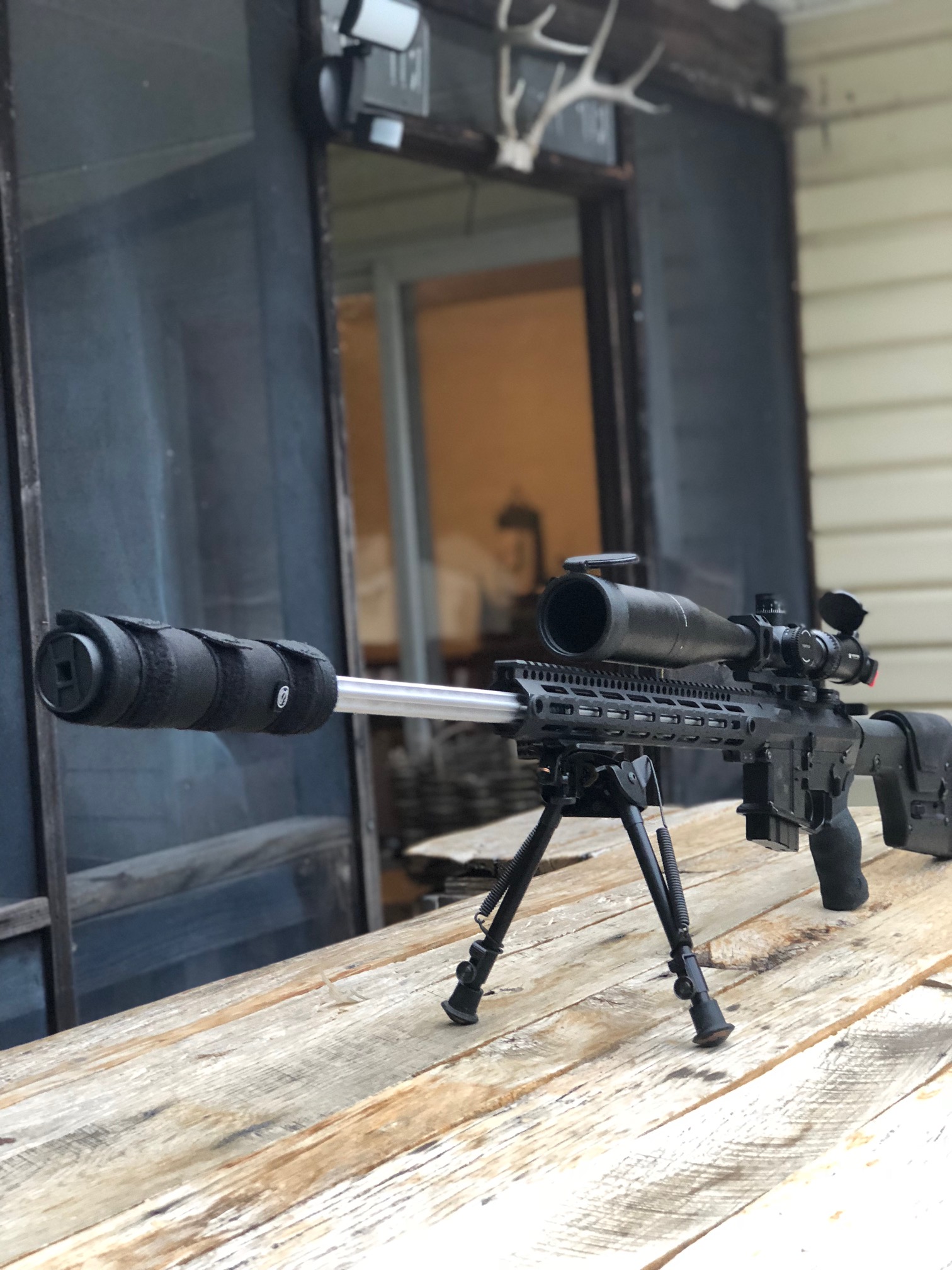

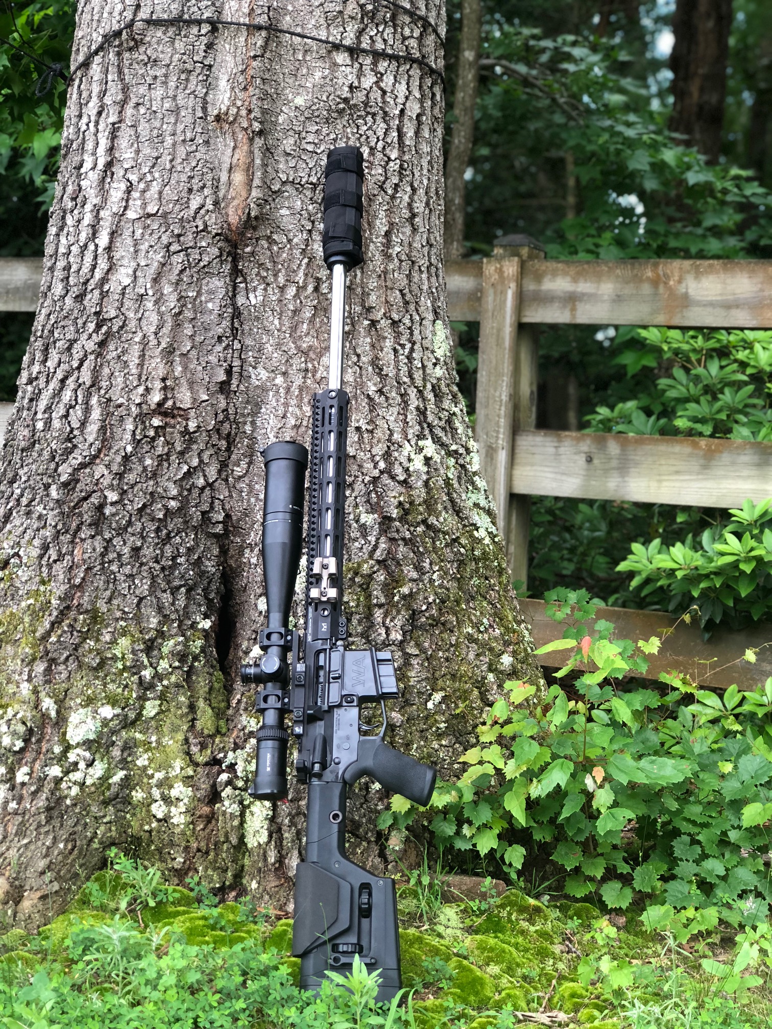

Here is the rifle, I finished putting it together last night. Taking it to the farm today to break it in. Will also get MV data with the magneetospeed today. Will be shooting the factory 90g SMK. Not a light rifle by any means, but I didn't build it to be light. that barrel is hefty.

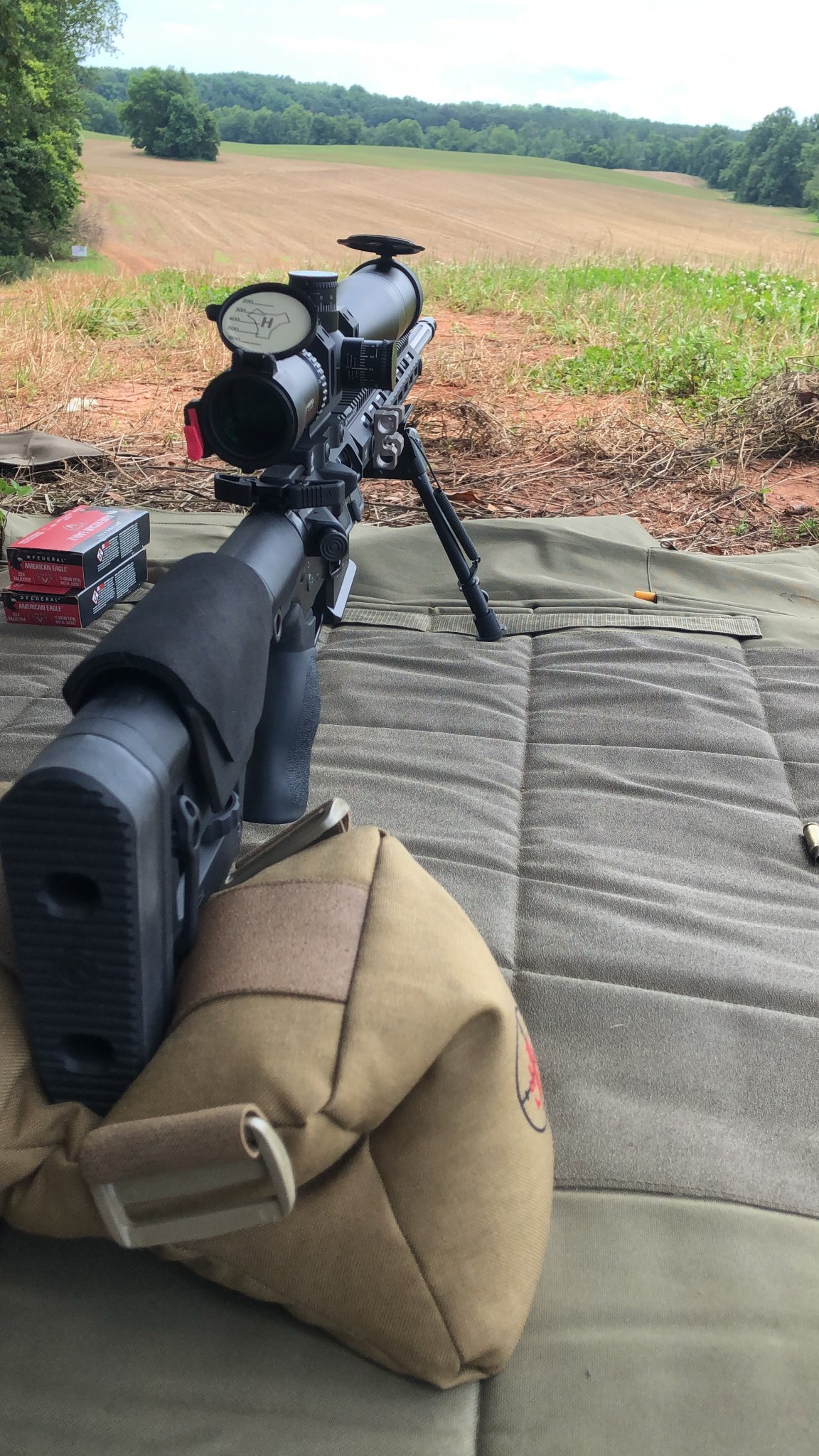

Okay guys I got the rifle out today and zero'd it real quick, shot a 4 shot group, then took some chrono data, then shot out to 700 yards.
see pictures attached.
0.67MOA 4 shot group (very first 4 shots after zeroing). factory federal 90g SMK
I was shooting a flimsy yard sale sign target that was swaying back and forth with the breeze. I know this thing can shoot tighter, next time I'll set up on a proper sturdy target.

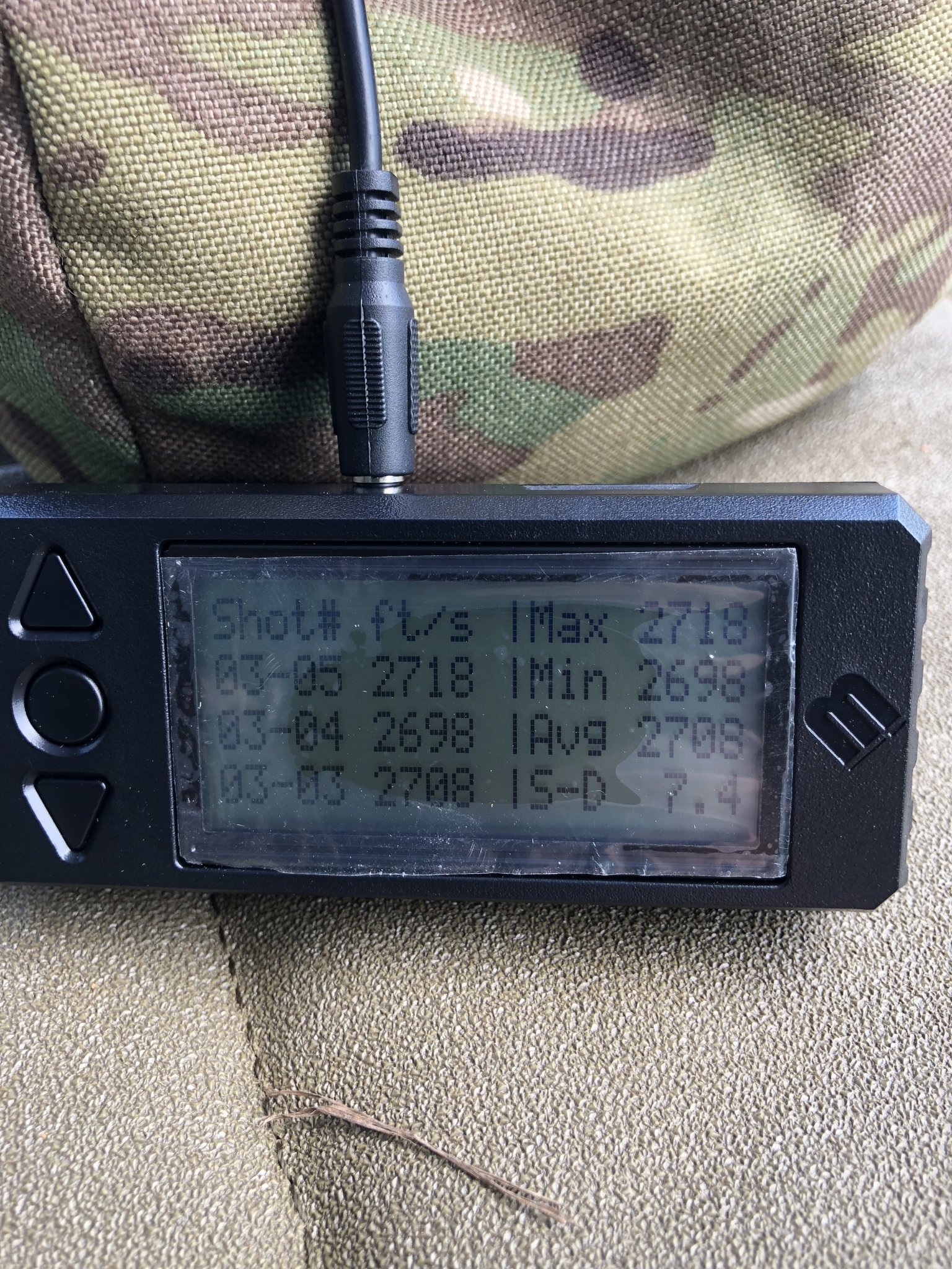

I only hooked the chrono up for 5 shots, average 2708 FPS with a SD of 7.4. I know, not a large sample, but it gave me enough to work with at the moment. I was impressed for factory ammo though.
I was having DOPE issues with both this rifle and my .308 today. I'm not sure if I didn't have something input correct in my ballistic app or what but I was consistently way too high on both rifles. like 2 moa high at 764 with the .224, and almost 4 moa high with the .308, and 1 moa high at 400 yards with the .308. idk what the issue was, then a storm rolled in so we packed it up. My dope cards were useless to me basically. but once i dialed in, the thing was a laser. I was stacking shots on the 12"x20" at 764yds
