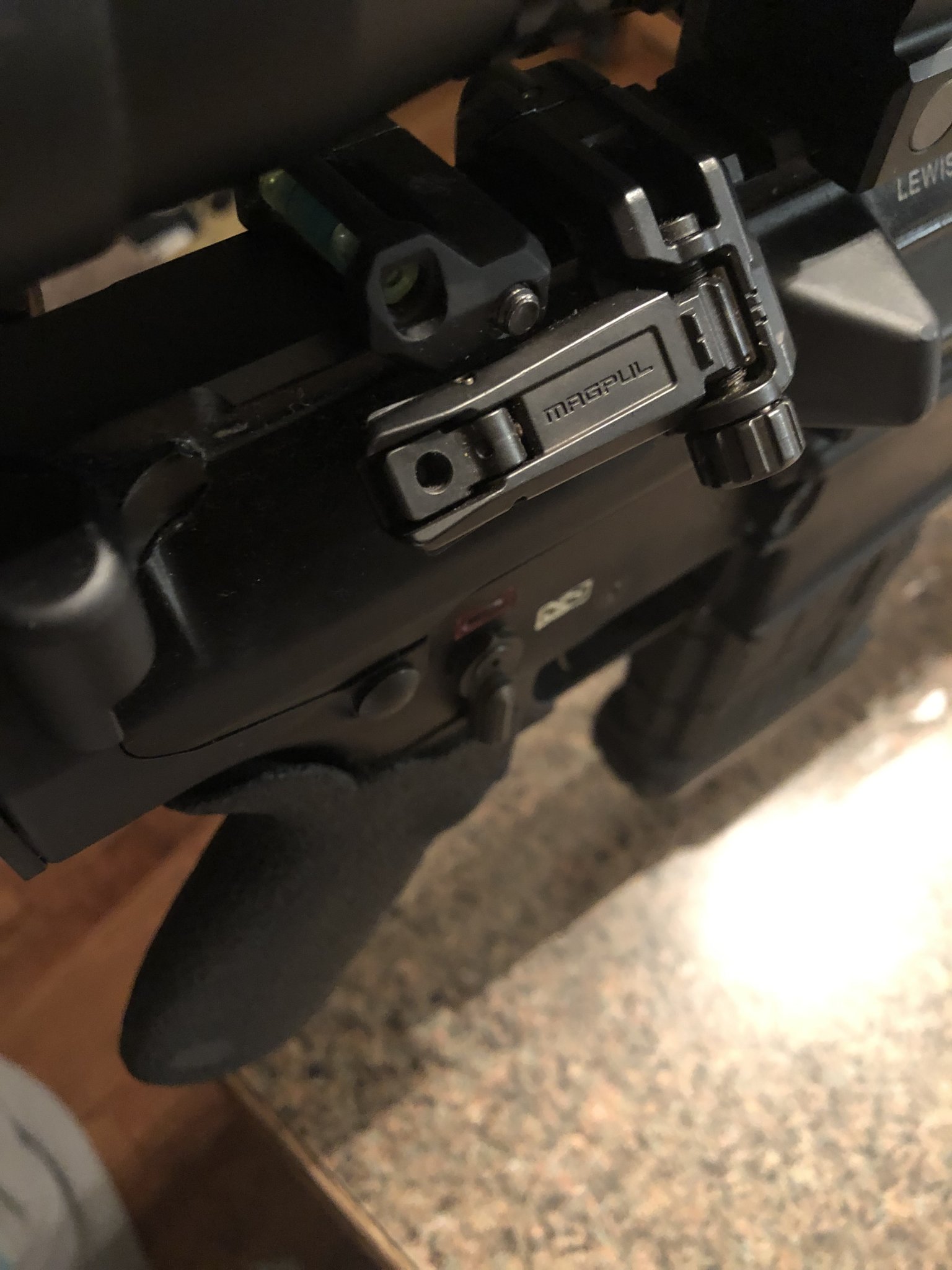

stevieb92
Belligerents
Aug 24, 2012
72
34
24
45
Look at pretty much any other one. 1/4"+ thick around the scope. Bubble level itself is longer with way more material around it. Basically solid plastic from the pivot to bubble
The one I linked is made from 6061 Aluminum. No plastic.
Reactions: b6graham

stevieb92
Belligerents
Aug 24, 2012
72
34
24
45
Is that what peeps do, mount the level in front of the ill/plx turret? why not behind it?
I don't know what peeps do, but I mount mine in front of the illumination/parallax knob. If it's mounted behind the knob, it blocks the numbers on the knob. Mine are mounted exactly like this...
