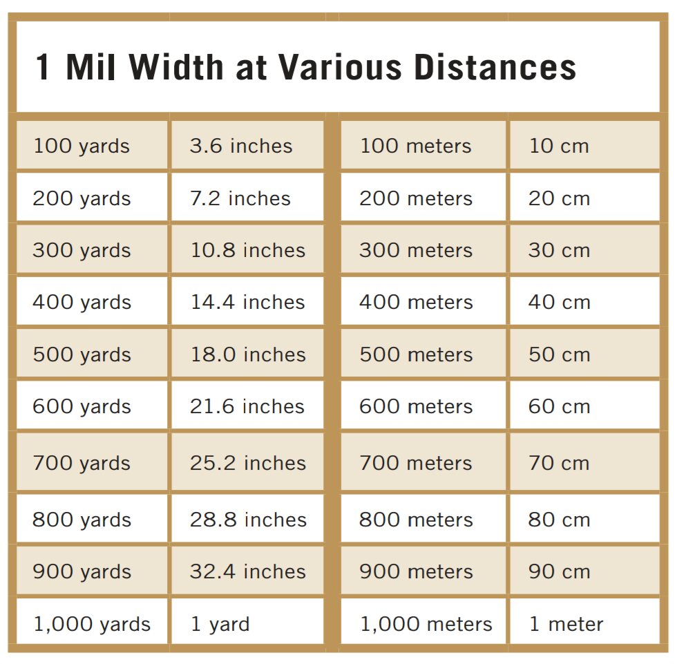

Need help can't wrap my head around how to break mills down for each range. Like click value at 100,200,ect. Thx

A mill is an angle. One mill is
  • 1 mile at 1000 miles
  • 1 meter at 1000 meters
  • 1 yard at 1000 yards
  • 10 centimeter at 100 meters
  • 3.6 inches at 100 yards (3600 inches)
If you know how big something is you can calculate how far away it is by seeing how many mills it covers. Once you know how far your target is then refer to your dope chart. How many mills will your bullet drop while getting to the distance of your target? Find that info on your dope chart. Dial your dope with your turret or hold with your reticle. Most of the time you will want to dial elevation and hold for wind.
The click value at each range is usually irrelevant. You shouldn't normally be adjusting fire by linear measurements such as feet, or inches or meters. You should be adjusting in angles such as, "I missed by 0.5 mils, so I dial or hold a 0.5mils correction". The range is irrelevant because the angle is the same, no matter the range.
A couple of exceptions:
If you are truing BC or adjusting dope from groups on paper targets at a distance where you can't see bullet holes. Or you are using the mathmatical center of the group and not the optical center that can be measured with the scope, then you would need to know that a mil = 3.6 inches at 100 yds, or that 1/10 of a mil (1 click) = .36 inches at 100 yds.
So, the formula would be: (offset of the group in inches / 3.6) x 100 / range in yards = adjustment in mils.
5 inches low at 500 yards: (5 inches / 3.6) x 100 / 500 = 0.277 mils
Or in clicks...1/10 of a mil click = .36 inches... so .36 inches x 5 (hundreds of yards) = 1.8 inches... and 5 inches (group offset) / 1.8 inches = 2.77 1/10 mil clicks.

Thx this is what I was really looking for brain is now running just couldn't remember. Getting old I guess

It's easy if you never think of it as a measurement. If you just have to know, your ballistics calc should give you click values at current distance

So do you just use the reticle to measure where the impact is and use that info to make an adjustment? I'm new to this and am trying to learn..
Yup. It's that easy. Best thing for me was to never think about it as a measurement of length or height.

Measure your target in cm and move it that many clicks.
1 click or 1/10 mil = 1cm @ 100m
2.37cm @ 237m (1mil=23.7cm)
6.87cm @ 687m (1mil=68.7cm)

why not? The conversion is way easier once you learn it.
It isn't the math, the math is easy.
It's that nobody knows what the hell a cm or a mm looks like. A meter kind of looks like a yard, until you start stacking them by the hundreds. It's a lifetime of ocular calibration that is so hard to overcome.

Yes, its intimidating and challenging. And sort of like learning a foreign language. A mil scope is basically in that language and we translate it into imperial.
The math is the same. 1/10 of a yard isn't any harder than 1/10 of a meter. The decimal point moves to exactly the same place.

Lol, 1/10 of a yard. Who says that?
The math isnt even close.
1/10 of a yard is 3.6 inches, which is 1 MIL at 100 yards. As in 1/10 of 36 inches (1 yard), which is 1 MIL at 1000 yards.
So, the math is kind of close....exact in fact.

@christopher.dow I totally get it. Im not debating that. Simply saying that if one was to be taking linear measurements. Using metric translates easier. 1cm on a metric ruler would be 1 click on a mil scope. If you were 13cm off how many clicks? 13, No math involved its 1 for 1 you simply move the decimal.
If somone was spotting and said your off by 1.3 meters, that is 13 mil. Can you easily dial 13 mil?
Vs if they said your off target by 1.4 yards. Dial that.
3.6.... That proves my point. It doesnt break down and align on whole numbers 1/10/100/1000s like metric does.
Now if there were 100 inches to a yard.
