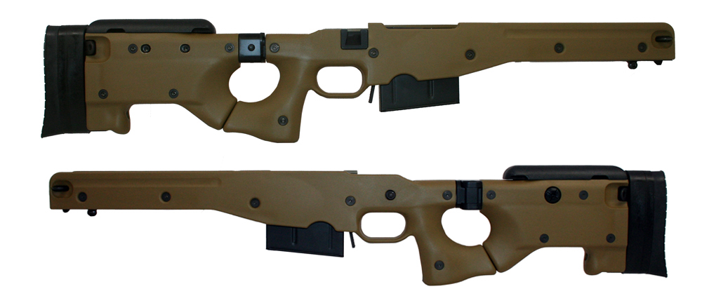

Have you tried the usual channels to pick up a used chassis? Otherwise, you would need to make sure that the different screw location behind the hand grip is compatible with your chassis.

bringing this thread back up.. and leads? I have a mk13mod5 that's not 100% due to the newer style aics 2.0.
hoping to find the correct skins

I’ve owned both chassis versions and can tell you the skins are not interchangeable between the correct version (black square bolt latch) and the little bit later version that was a little more sleek looking that has the bolt latch cut into the skins instead of the chassis. You’ll have to find the correct chassis or find the correct chassis in the wrong color and have them cerakoted.
As soon as the mil decommissions these there will be plenty of the “used in action” like we have now for the Mod 0/1 as well as the M24 SWS
