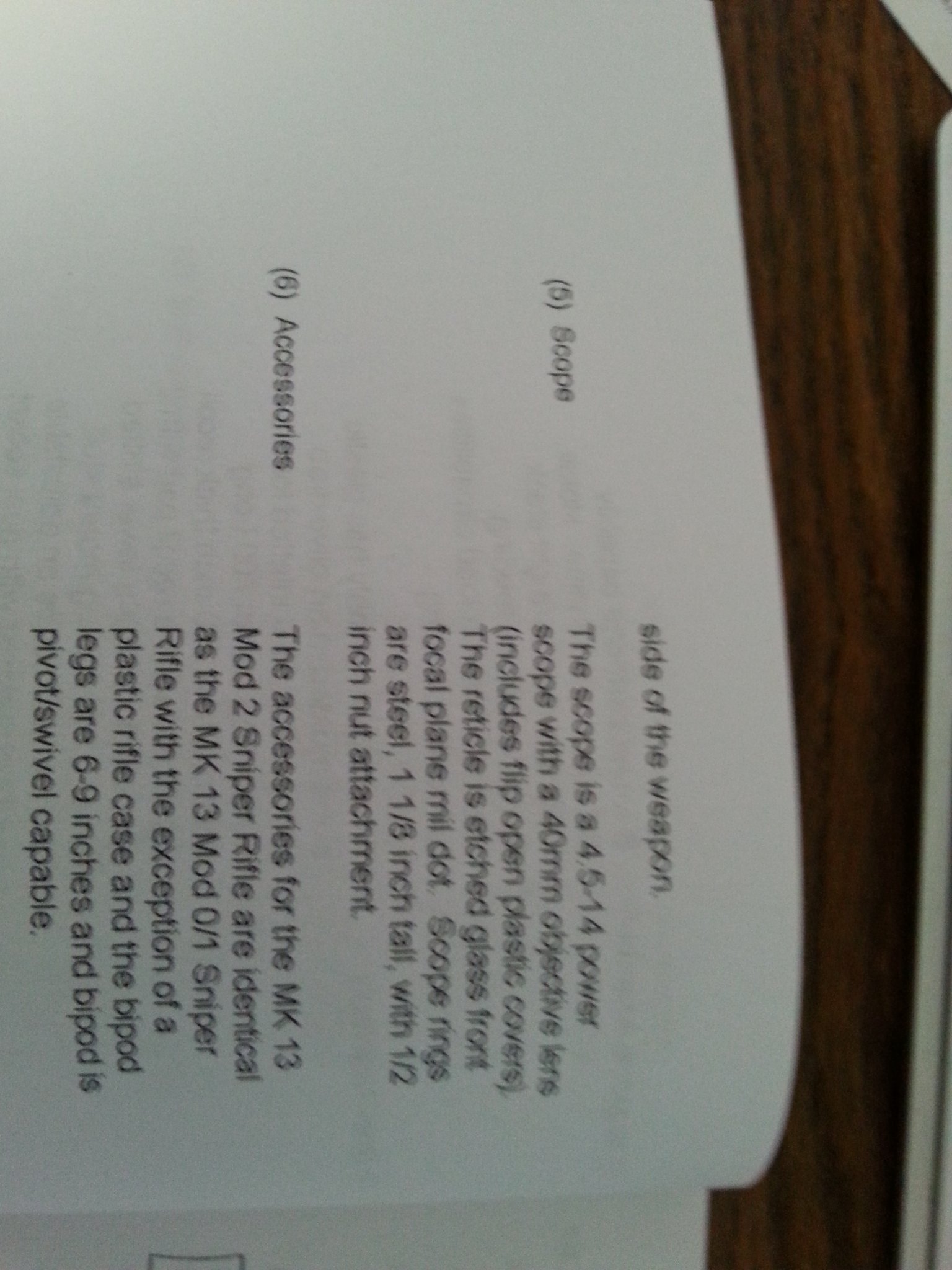

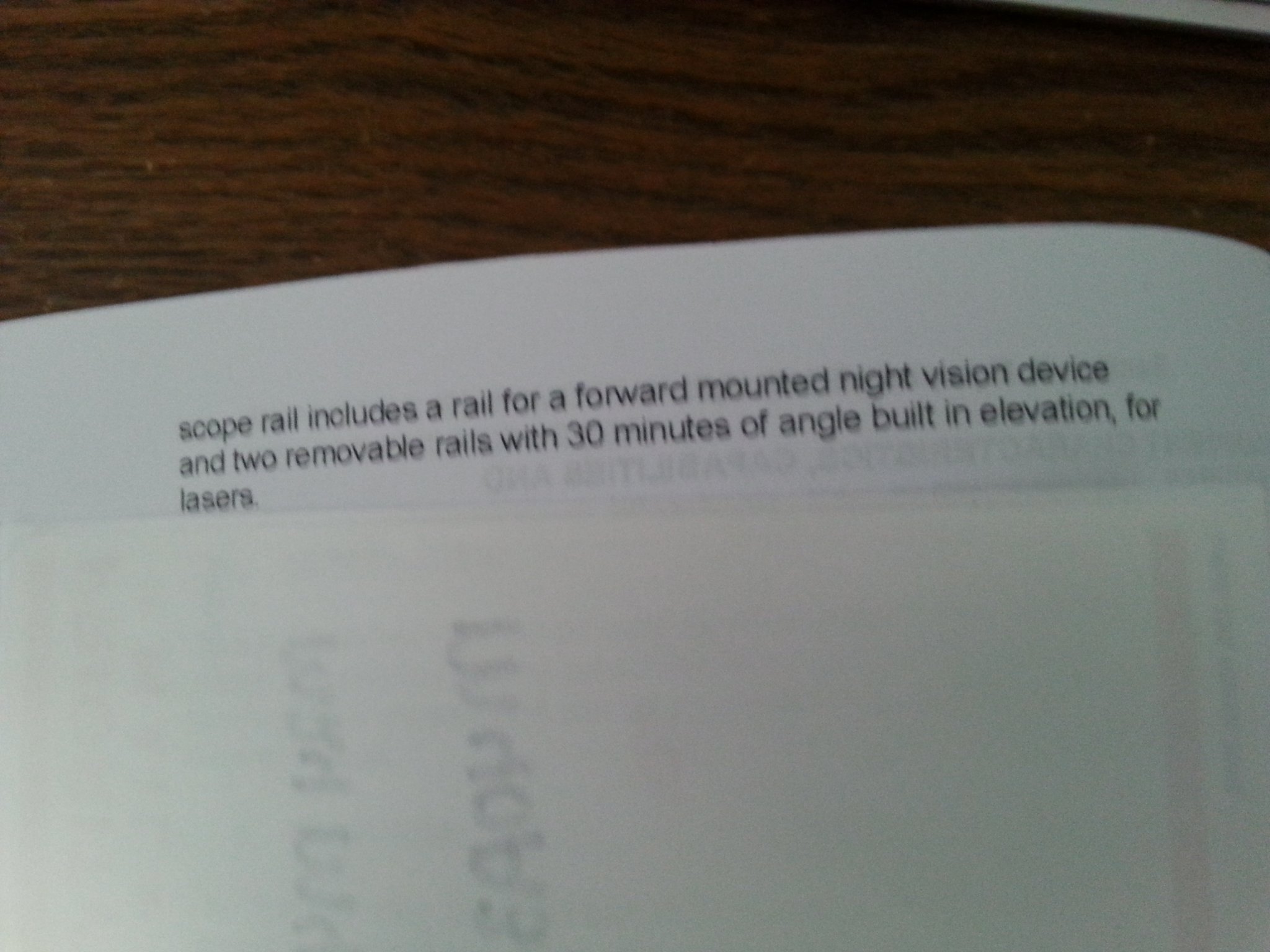

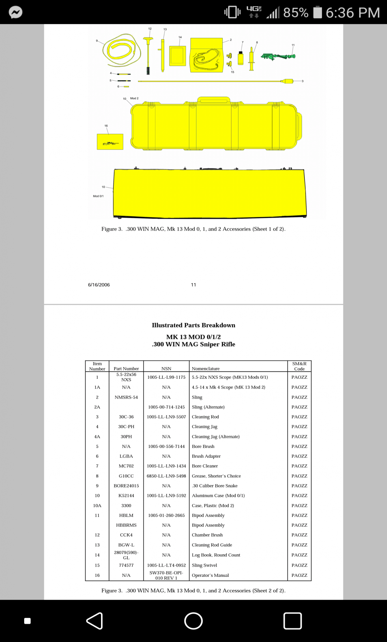

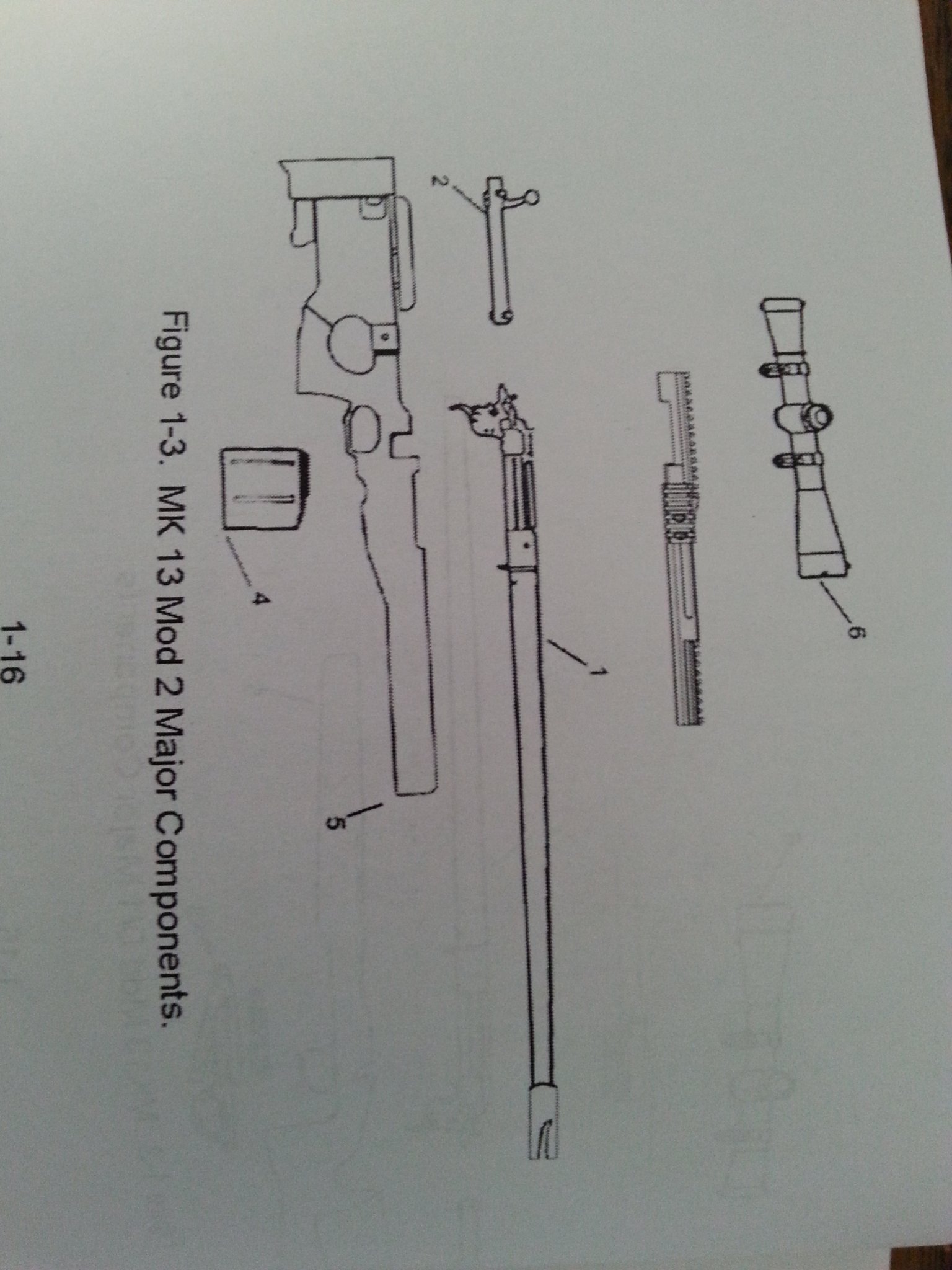

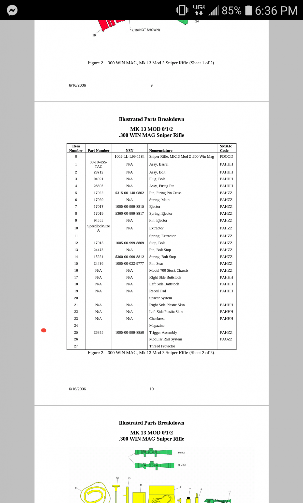

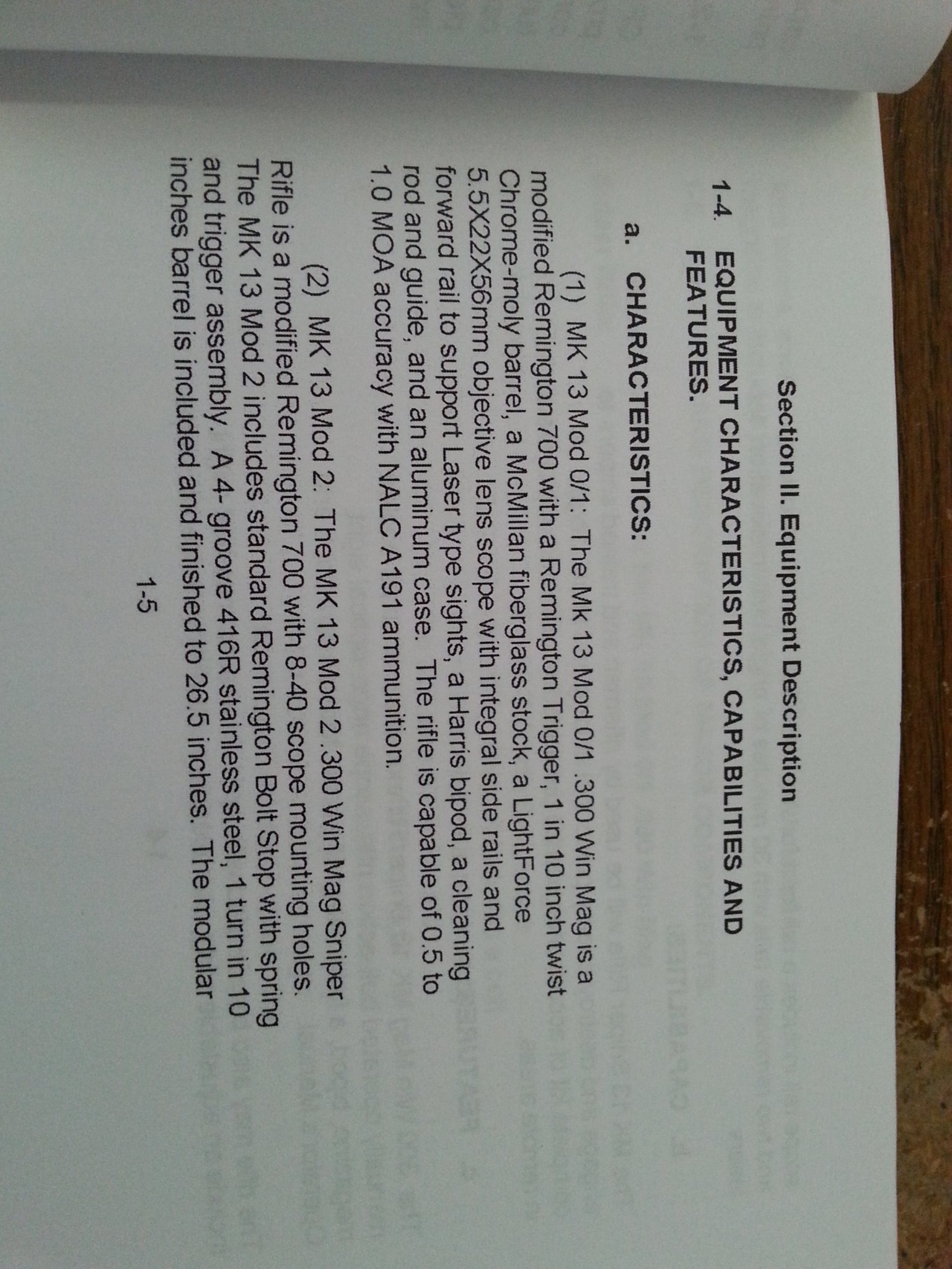

Hello I have a copy of the MK13 MOD 0-1-2 Operator's Manual and I took pictures of the MK13 MOD 2 information in the operator's manual, geoff3

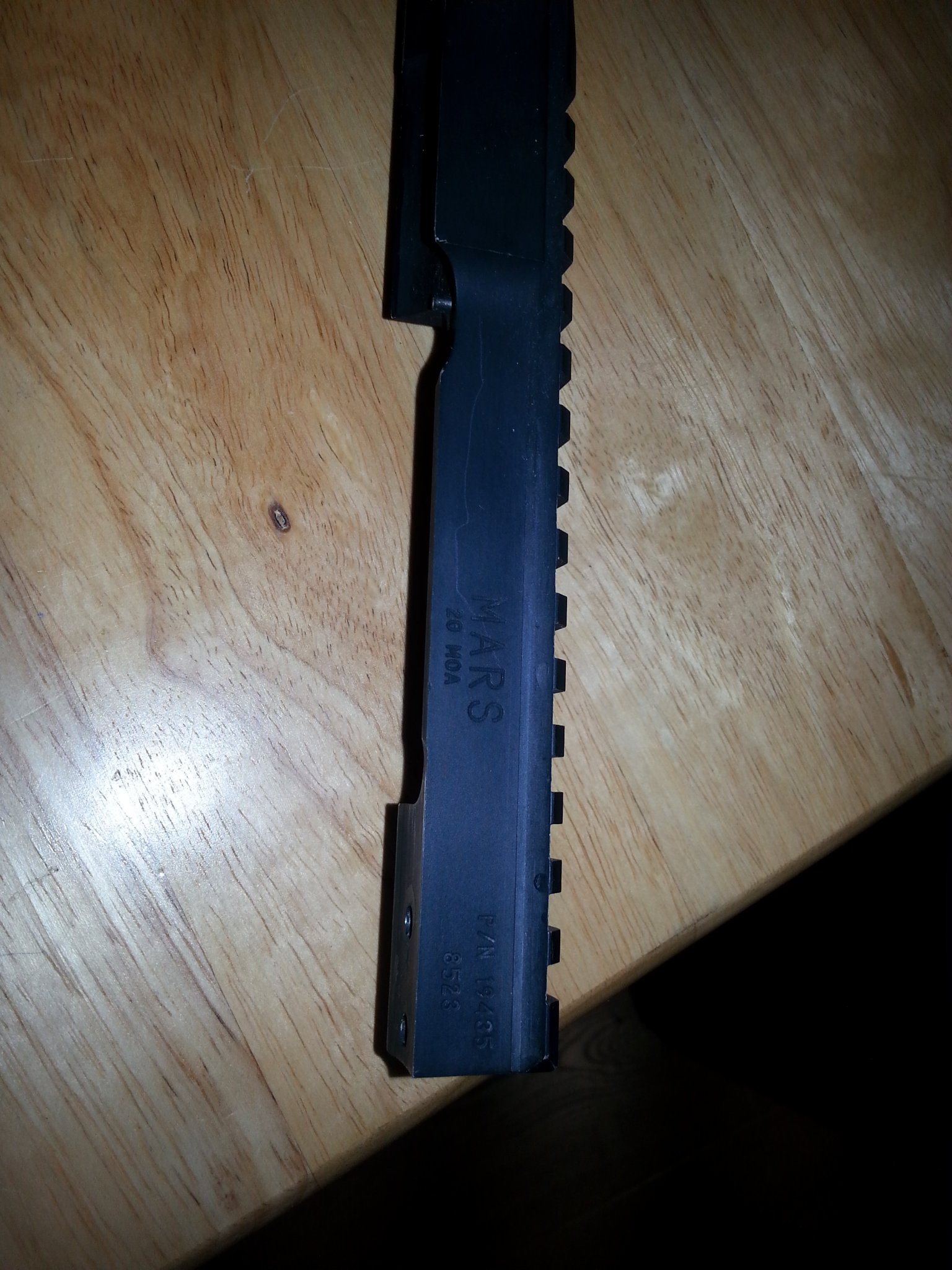

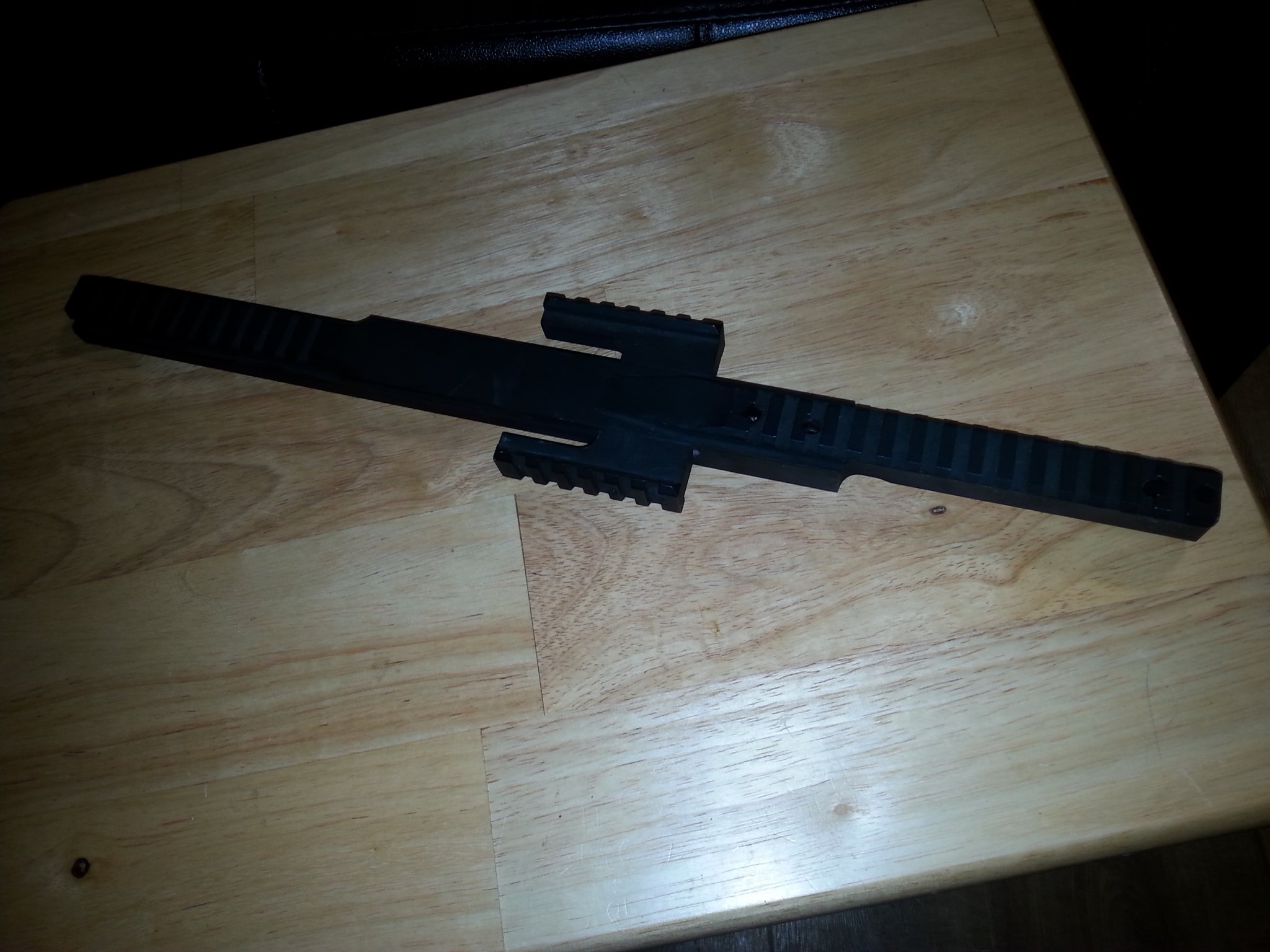

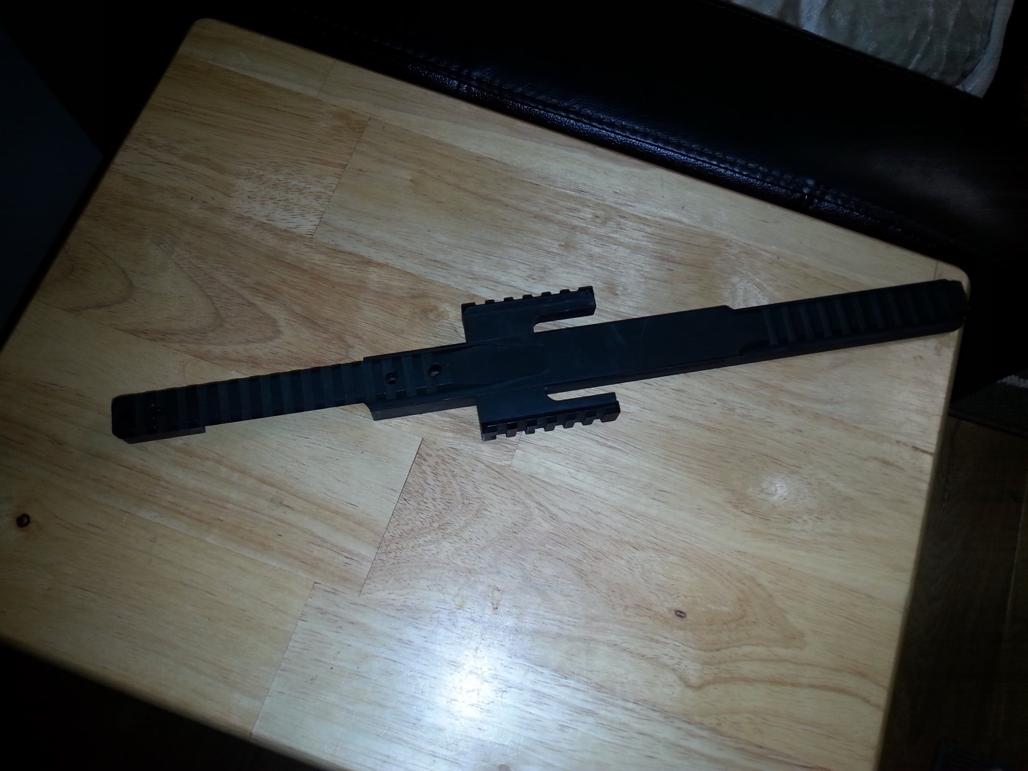

The Mars rail make a want to buy add I did a couple weeks ago and just bought one. Or if your not concerned about being 100% correct PRI makes one that looks very similar
