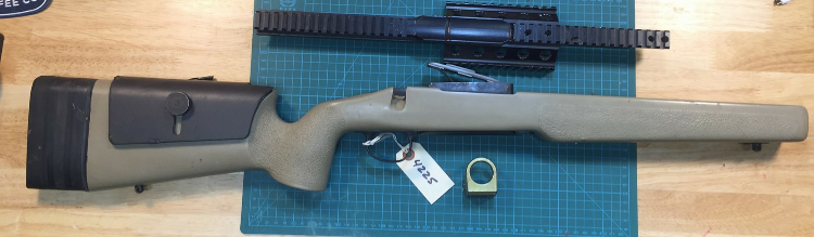

Post pics of the stock when it lands
What scope and rings do you want?
Here’s a quick picture of the stock kit that I took as soon as I got it out of the box. I couldn’t be happier with everything and can’t thank USMCSGT enough for hooking me up with it. He's an excellent guy to do business with and can't recommend him enought.
As mentioned before, I’m waiting on Lilja for my Mod 0 (Tactical Contour? - not entirely certain which is the correct reference). I saw it mentioned somewhere that some Mod 0s were actually built with the Mod 5 contour, is this correct? If so, then I assume that whether or not it was appropriate would depend upon the serial number of the stock as to whether or not the Mod 5 contour would be appropriate.

According to a ex-crane armorer, yes they did do a few Mod 5 contour barrels on a Mod 0.
Is it correct for you build, hard to say. I know my stock that I got from USMCSGT is in excellent condition and nearly identical to yours and I built it in a late mod 0 style with the mod 5 barrel profile and fitted it for my Mk11 suppressor.

Here’s a quick picture of the stock kit that I took as soon as I got it out of the box. I couldn’t be happier with everything and can’t thank USMCSGT enough for hooking me up with it. He's an excellent guy to do business with and can't recommend him enough..
Thanks for the info. So, would my clone still be technically correct if I went with the NF or the Leupold? I just don't want to screw this up.
Nice looking stock group, congrats
