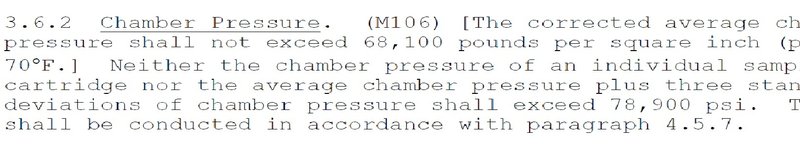

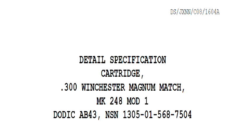

From the MK248 Mod 1 Detail Spec:
Those are the maximum allowable at the intended temperatures, not the intended target pressures. The "Do Not Exceed" if you will. If something happens in the machine and a case gets too many grains of powder, the 68k is the most you should end up with. Testing is done once the ammunition is assembled to see that it doesn't exceed that. Average, should be no more than 60K psi. There are better ways to increase velocity, than yanking up the pressures on ignition.
Again, too those pressures are in the chamber cut for that round not the standard .300 WM round. So, even still, they are hotter than standard .300WM
Edit: Added: I was getting 2930 with 208's and Berger 210's using 75.1 gr. of H1000. Different chambers I suppose. I tested all the way up to 78.8 gr. but had pressure signs above that. The book goes to 80~.something. There are a lot of differences when loading a belted magnum. I also seated the 210's (first) then later the 208's to the lands.

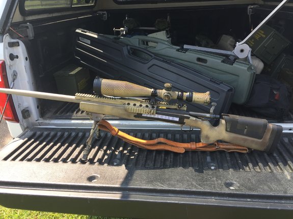

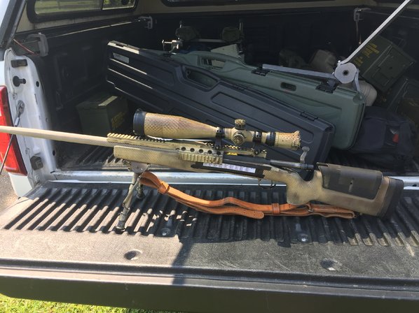

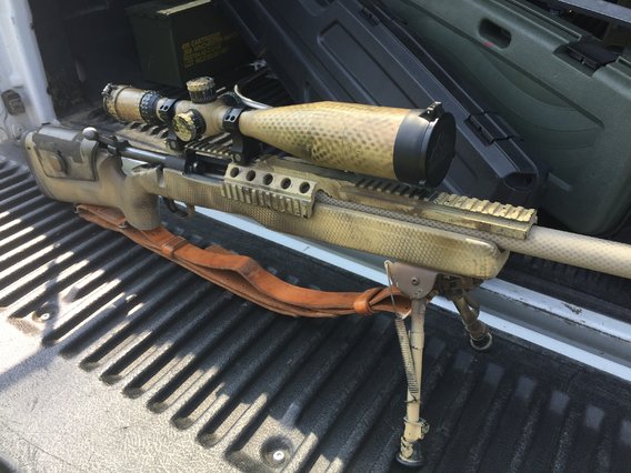

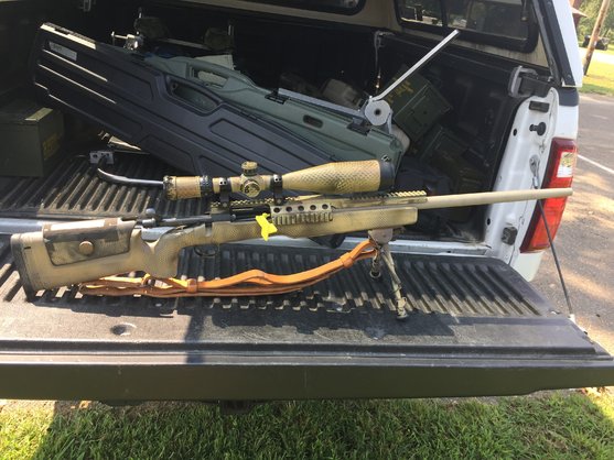

OK, went out and test fired the Mk13 Mod 0 with Seal return stock , Lilja barrel, and Nightforce NXS scope. [IMG2=JSON]{"data-align":"none","data-size":"full","src":"http:\/\/i.imgur.com\/9uvGZw6m.jpg"}[/IMG2]
Very good results. Shooting at 100 yds in a light wind and 100 degree heat, I fired ten rounds fouling/sighting shots to get on target. Then I fired a 10 round group using Federal Gold Medal Match. Not bad, as I was firing fairly quickly and more interested in function testing the scope and rifle. No problems. Next I fired five shots with a hand load of 190 g Sierra Match King BTHP loaded with 70.3 g of RL 19. This is the load the Army uses. Very nice sub moa group holding a little tighter. Last five shots I bore down and shot for a good group...rounds 25 through 30 of the brand new Lilja Seal return barrel...using 210g Berger VLD Target with 77.0 g H1000, yielded a .557 EDGE to EDGE group, which is about .25 moa. Stopped there with a total of 30 rounds through the barrel. Couldn't be more pleased. [IMG2=JSON]{"data-align":"none","data-size":"full","src":"http:\/\/i.imgur.com\/9WU8xCwm.jpg"}[/IMG2]

That's a good day, especially if there was no brake or can on that rifle. They are a heavy stick but 210s over 77gr of powder is no shit. That had to get your attension. Glad to see some results. Hopefully by Christmas we have 2-3 pages of groups and field reports. So good to see these kits live on.

You know, I don't find the recoil too bad. The gun weighs a ton (16 3/4 pounds actually), has a thick recoil pad, and is ergonomically suited to absorbing recoil. Admittedly, I was shooting off a rest on a bench, and I had a shock absorbing shoulder pad on for when the rest recoiled into my shoulder. I use a very light trigger, 2 lbs, and just don't notice the recoil too much. For a tactical rifle where you will take one shot, maybe two, before displacing (hopefully), recoil just isn't that big a deal for me (I know modern doctrine on when to displace has changed). Certainly, for me, shooting an International Full Course of a 120 shots of .308 at 300 meters over the course of 3 1/2 hours is far harder.

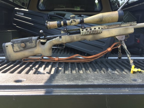

bates762
Feb 14, 2017
92
65
34
Tennessee
This thread needs some fresh content. I got to take my Mod 0 out today after getting it barreled. The gun performed adequately when I did my part. The trigger needs a little work as it is heavy right now. I have a bucket of 210's that I am going to work up for it and another Win Mag. Don't tell the clone police that my Mod 0 has a Mod 5 barrel! It was free and new and does the same job!
RWSGunsmithing
Gunny Sergeant
Commercial Supporter
Belligerents
Mar 26, 2006
4,570
31
154
Manning, Iowa
www.rwsgunsmithing.com
The Mod 5 barrel is clone correct for a late mod 0.

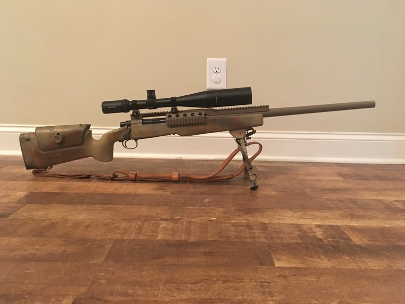

bates762
Feb 14, 2017
92
65
34
Tennessee
Thanks. She was painted when I got it. I just took some netting and some rattle canning later for the barrel. I haven't tried them. Bergers and Sierra's have been my go to for my others. Can't wait to see yours when it is finished. I hate that most of the pictures people posted have been lost due to photo bucket...

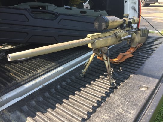

buffalowinter
Rick Jones MAJ, SF (Ret)
Belligerents
Mar 17, 2014
900
1,582
99
101
Llano, TX
For anyone interested, my first Mk13 Mod0 clone, discussed earlier in this forum, is for sale in the Firearms for Sale Forum of the Hide. This is the gun using a Grayboe Renegade stock before I went crazy and bought a SEAL return stock. Bargain priced at less than the total cost of the components...$1300. Pics, with groups and details, in the For Sale Forum.
[IMG2=JSON]{"data-align":"none","data-size":"full","src":"http:\/\/i.imgur.com\/hwQbIJWl.jpg"}[/IMG2]
[IMG2=JSON]{"data-align":"none","data-size":"full","src":"http:\/\/i.imgur.com\/vGra2s3l.jpg"}[/IMG2]
