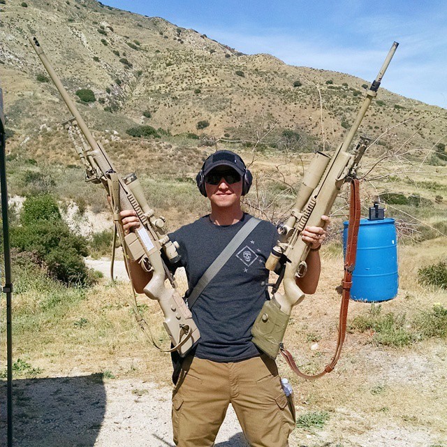

[IMG2=JSON]{"data-align":"none","data-size":"full","src":"https:\/\/i.giphy.com\/l0HlQ6tNCQir8eXAI.gif"}[/IMG2]
Great, now I want one! In fact I have started my own half-assed build, wishing I had just sucked it down and bought one of the original stocks. Anyhow, mine is based on a Remington 700 .300 Win Mag Long Range, after searching the internet and buying the cheapest one in the US. I found a Mars rail...for a Savage 110. Good news is, it was cheap...and for sale...and an easy mod to fit the Remington 700, and you'd have to look closely to see that it wasn't made for the 700. Bought a Leupold Mark 4 LR/T 4-14...in fact bought two as Leupold is discontinuing all Mark 4 sales to civilians. PTG steel bottom metal, Whidden aluminum bedding block, Leupold rings, Anschutz rail, stainless steel action screws, DevCon bedding, Kydex Bear Paw adjustable cheek piece, and a Greyboe Renegade stock. Greyboe is licensed by McMillan and provided some of the early MK 13 stocks. The Renegade is a copy of the McMillan A5, more or less. My build is not an accurate representation of the Mk13 Mod 0, but rather it is more of an "Homage". But, the thing should be dead-ass accurate when I'm done, hopefully better than the original using the Aluminum bedding block.

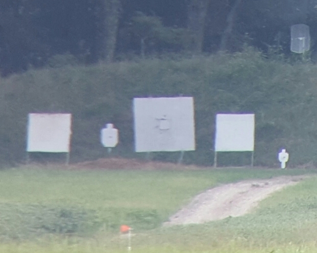

Gonna brag on these rifles a sec. Instead of the typical groups posted, here are 6-7 shots at 1250 yards. Took one shot each at the IPSC and half sized IPSC. Steel plate is 12"x12". This is with 230 OTMs in an A191 chamber.

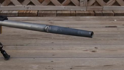

Ok Gents here it is. MK13 Mod 3 with a MK11 KAC suppressor. This is the same one that Chris Kyle used during his Ramadi deployment. It is attached with a donut to the barrel as its posted in the pic.

So on the mod3, the "doughnut was added for the KAC supressor pins to attach the mk11 can?

Yes for the Mod 3 the donut was added for the KAC suppressor. There really isn't known about any of the MK13 rifles period. Its not like the M40 series where some or most have used and shot with their time in the Corps. Not too many here have shot an issued MK13. I'm not sure what really is different with the Mod 0/1/3 rifles. We can all tell by the pics but few if have first hand knowledge.

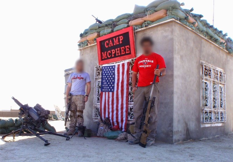

Yeah, that's Nick. From the look of the pic that is the old bus in the Rifles Only carbine pit. He brought his issue rifle there for a match or 2 before he got out. I have several of him from that match.

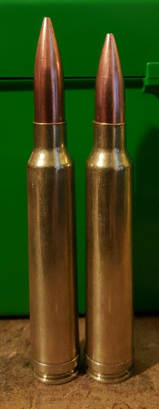

Sirhr,
are you planning on sticking with the A191 chamber, going to the m248 mod1 chamber to use the 220, or?
To give you a visual, here is a 220SMK to the length of the magwell on the left, and .020" off the lands of an A191 chamber on the right. The M248 isn't as long as the mag follower round, but it's longer than the A191. That said, 230 OTMs shoot superbly, mag fed, in my A191 as do the Black Hills A191 loads.
