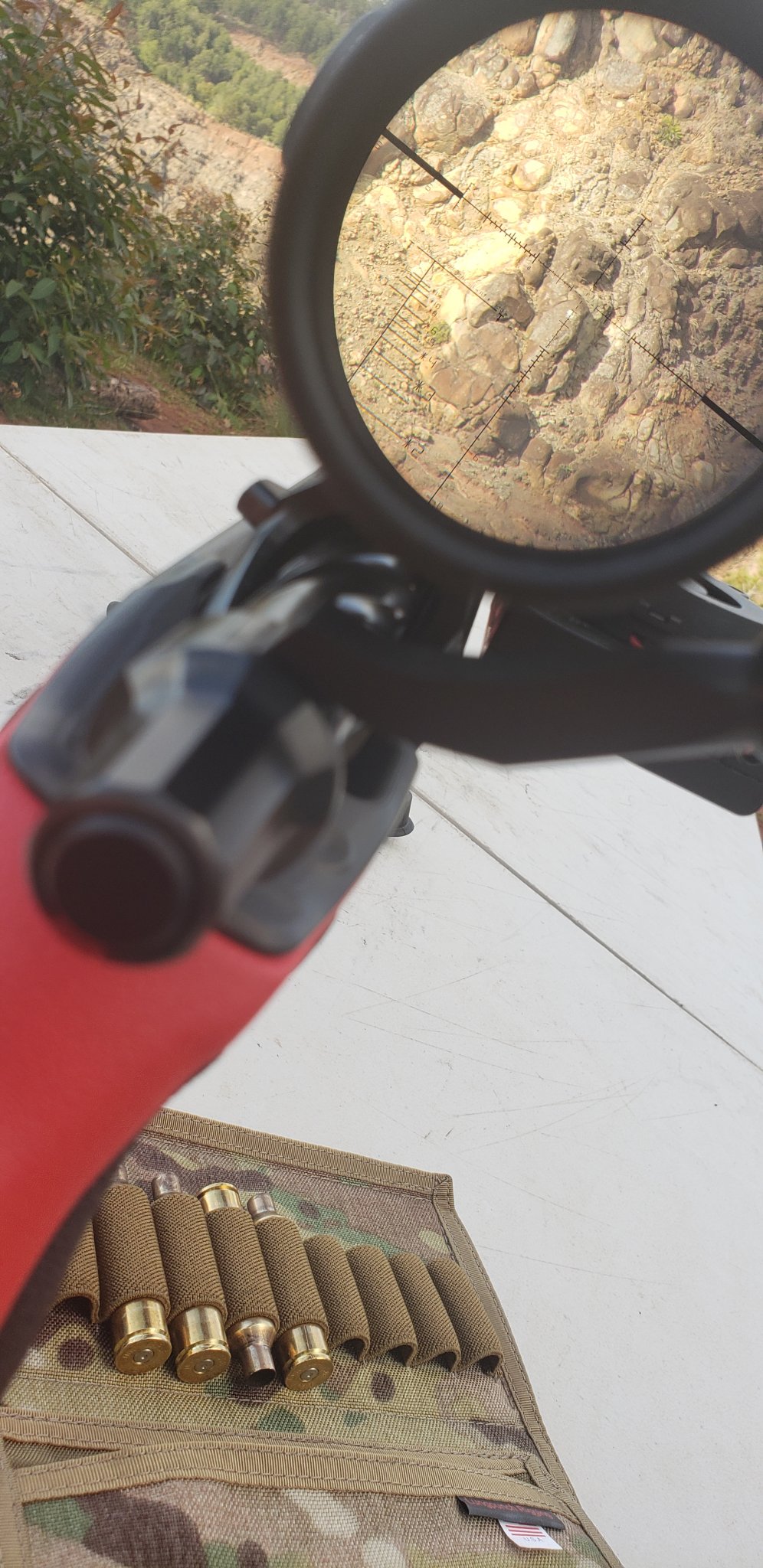

I was trying to do this today. You need to find out the hash mark values of your scope reticle.
Yes, you do.
I'm going to guess that looking at the picture through his scope that the little grass in the rocks at 2 O'clock is about 24" or 60cm, and on his reticle looks to be about 1 mil.
If he looked around nearby he could measure a similar grass and get a better idea.
So
60÷1×10=600m
If the grass is more like 18" or 45cm
45÷1×10=450m
Bric2000

Yes, you do.
So
1x60x10=600m
So using reticle to measure splash (poi) vs point of aim should give you mils to adjust?

Sorry, just reread original post... "to measure groups". I guess the same thing applies if you can see the point of impact that well. i thought it was about adjusting scope to correct poa vs poi.

Yes, you do.
So
60÷1×10=600m
45÷1×10=450m
This is the danger your eyes can get you in trouble with as we discussed in the other thread the other day estimating size with your eye. For example how sure are you the grass is 24" and not 18"? Sure you can look around for like grass and fortunately for you mother nature likes patterns and has evolved human eyes to look for patterns and you measure some grass near you and it validates your 24" thought that all grass that looks like this is 24". Our eyes do this to us all the time especially in the two dimensional space of looking through glass. Problem is the grass really is 18" and now your range is off by a factor of 25% and we have committed a nice type 1 error. Really really hard to accuratly measure 6" at distance but can be done...alot of sniper school classes loose guys on range estimation.
Good skill to have really hard skill to master proficiently. I like your style though, master it you are on the right track with your known size objects. I used to carry a tape measure with me on every patrol and I would occasionally measure objects in the villages just in case batteries died :).
Reactions: 2aBaCa and bjay
