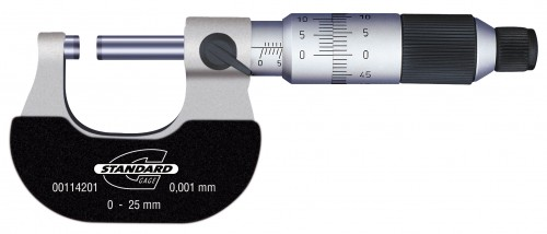

Is this what you mean by standard micrometer? If so then I would trust the outside measurements taken with it.
(outside diameter of the loaded round-diameter of a bullet) / 2=neck thickness

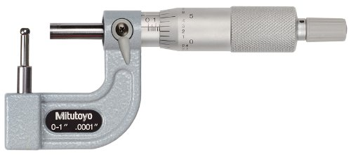

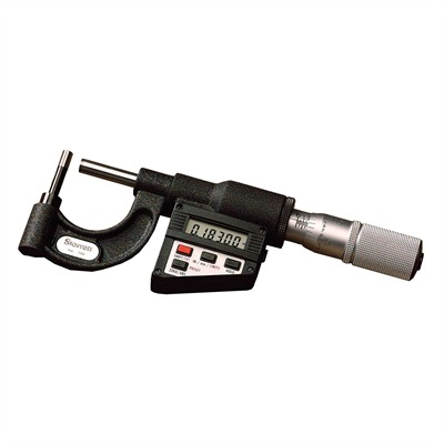

Those style ^ are not a great fit for measuring only one side's thickness, a ball or tube micrometer would be better so that it would fit the inside curve of the neck.
Ball micrometer-
Tube micrometer

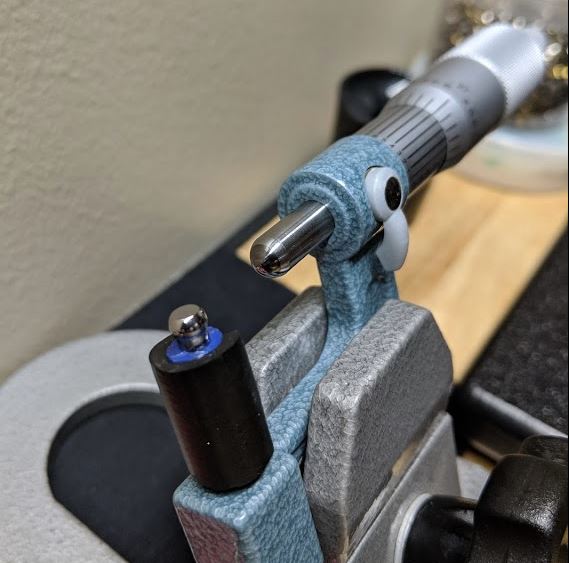

I had a machine shop modify my Mitutoyo so I don't have to worry about any deformation in the neck getting in the way. It also allows me to get measurements up and down the neck.

I would get a ball micrometer similar to this. I have Sinclair's digital gauge but it doesnt look like they sell them anymore.

Not trying to rain on anyone's parade, but I'm not a fan of digital calipers or mics. Things may have changed, but last I looked, digitals could only resolve to a half a thousandth (.0005"). Whereas, with analogs....you have a chance to fairly accurately "resolve" (via eyeballing it) to a third, maybe a quarter of a thou (.00033" to .00025"). The Mitutoyo Tubing mic that I have (shown in multiple posts above) is just the shizzle. The feel of it is great and the repeatability of it is fantastic. I bought mine about 20 years ago and I think I paid $80 or $85 for it. If I had to replace it today at twice that price, I'd gladly do so.

I ordered a ball micrometer to get some accurate measurements of neck thickness. I figured there was the right tool somewhere I just didn't know what was right.

An update to this thread, with handy ball micrometer in hand, I was able to make solid measurements of the case necks. Across 5 cases and across several points on each case I have an average of .015 thickness. The Hornaday case I have runs about .014.
.264 + .030 = .294, which means a bushing size of .291 or .292 would be money.
