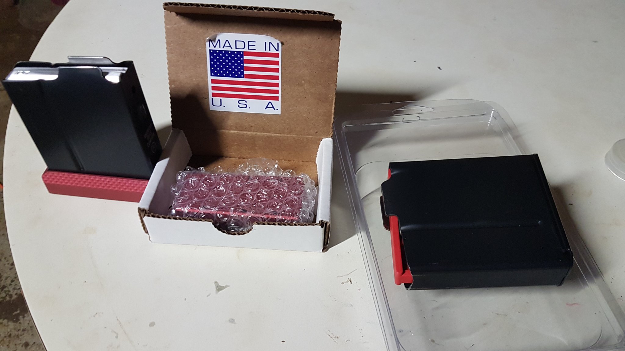

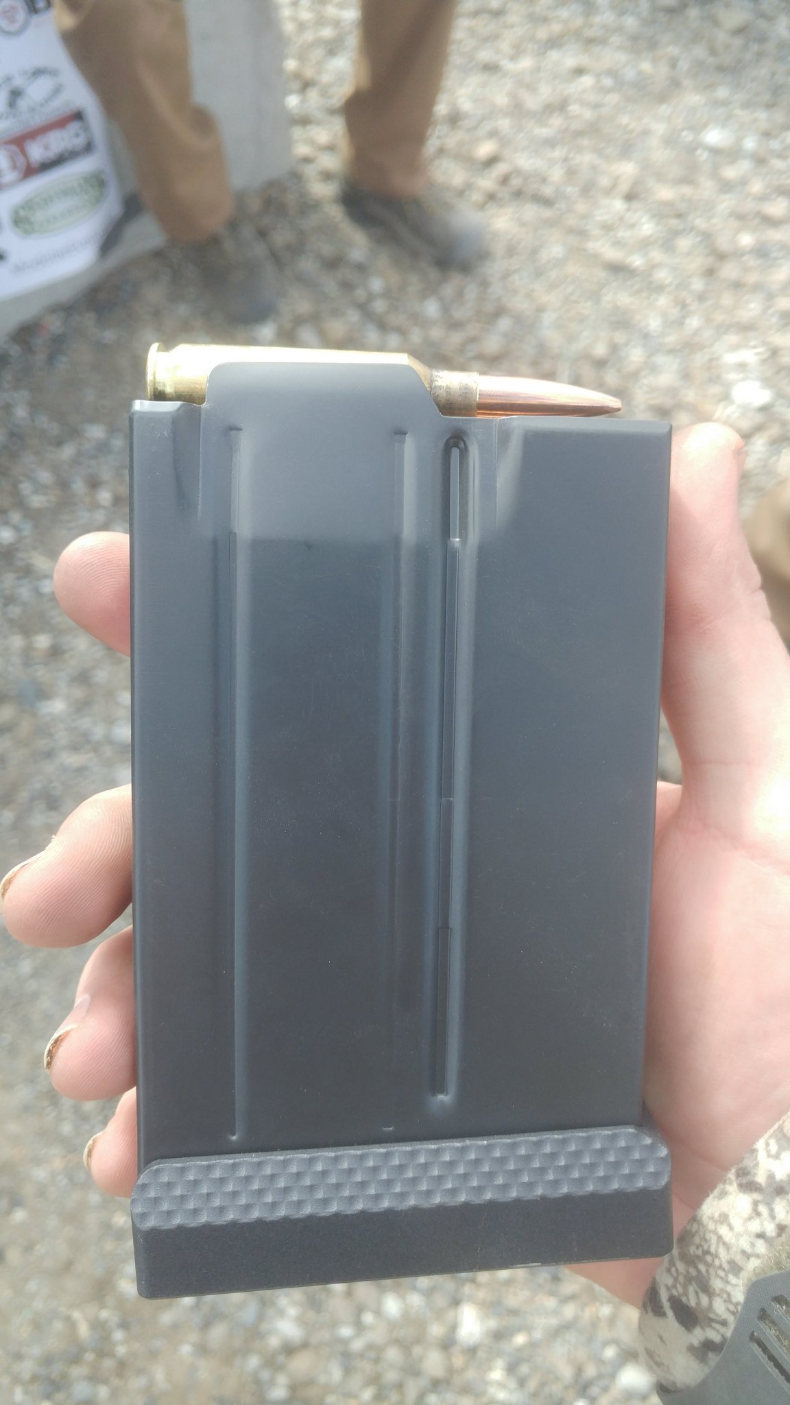

Package from MDT arrived today!! Came very well packaged with 2 stickers and a nice little card letting me know who picked and packed it.
These mags are very solid, heavy and well made. You notice the weight to them when you receive the box. Nice slick finish on them as well. Will be testing them with 6.5x47L in my Bighorn TL3 in XLR Envy chassis probably tomorrow and will report back. Looking forward to running these.

Are they 12rd or 13rd mags? Did you get a chance to compare them to ARC mags?
They are 12 round magazines that have the ability to fit 13 rounds of some calibers (like the 308). The mags we sent @padom were pre production and stamped "13 RND" where the actual production will be stamped "12 RND". How they compare to the ARC mags will be up to @padom to review. We have not tested them yet.

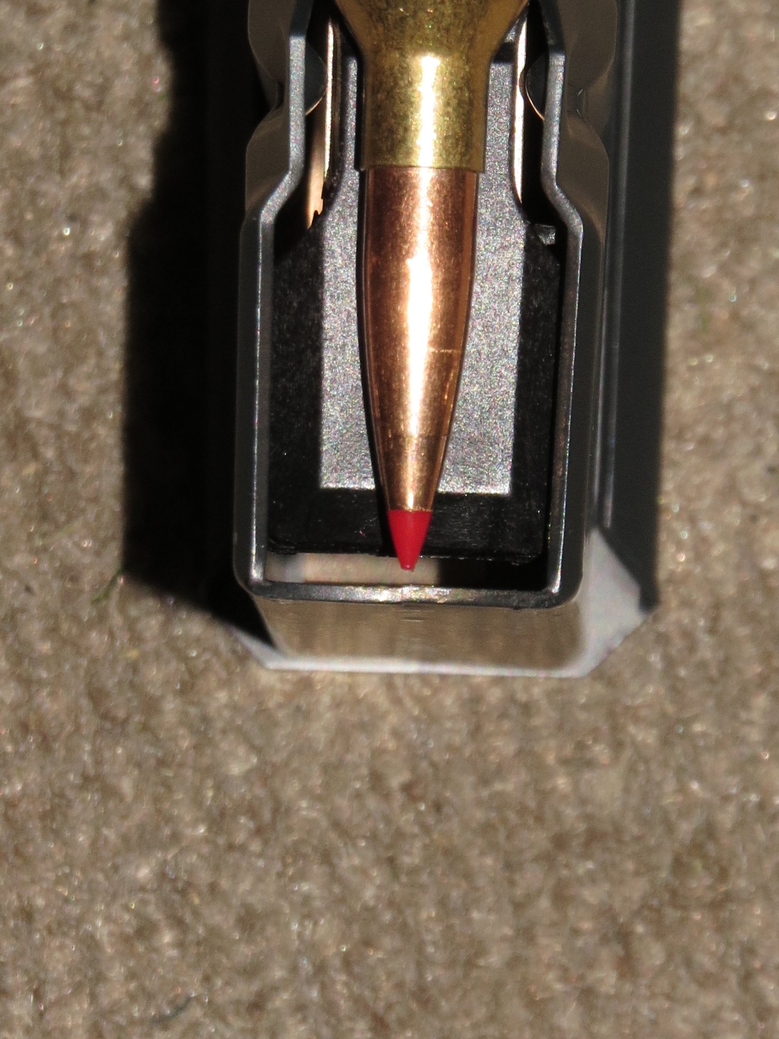

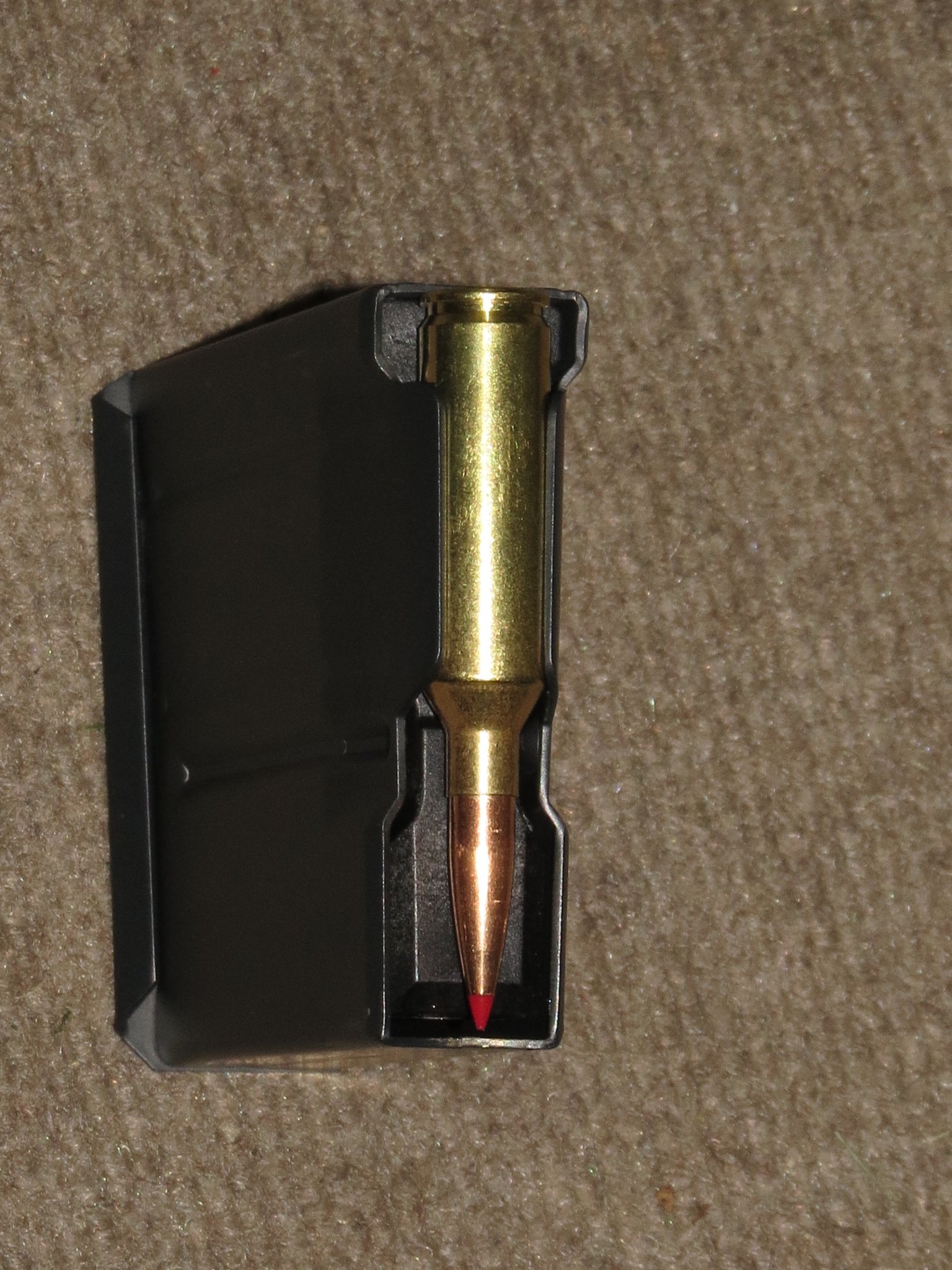

Thanks for reviewing the mags padom....this gives me a reason to pull out that HS3 Rem model 7 chassis I have laying around to build a 6.5 PRC using the 10 & 12 rounders. That round will definitely reach the internal COAL, may even have to hand load to get them to work, but that might work in my favor.
These are the factory Hornady 143's in the Mdt 10 round with no binder plate so they do fit . IMG_0289.JPG IMG_0287.JPG IMG_0290.JPG
