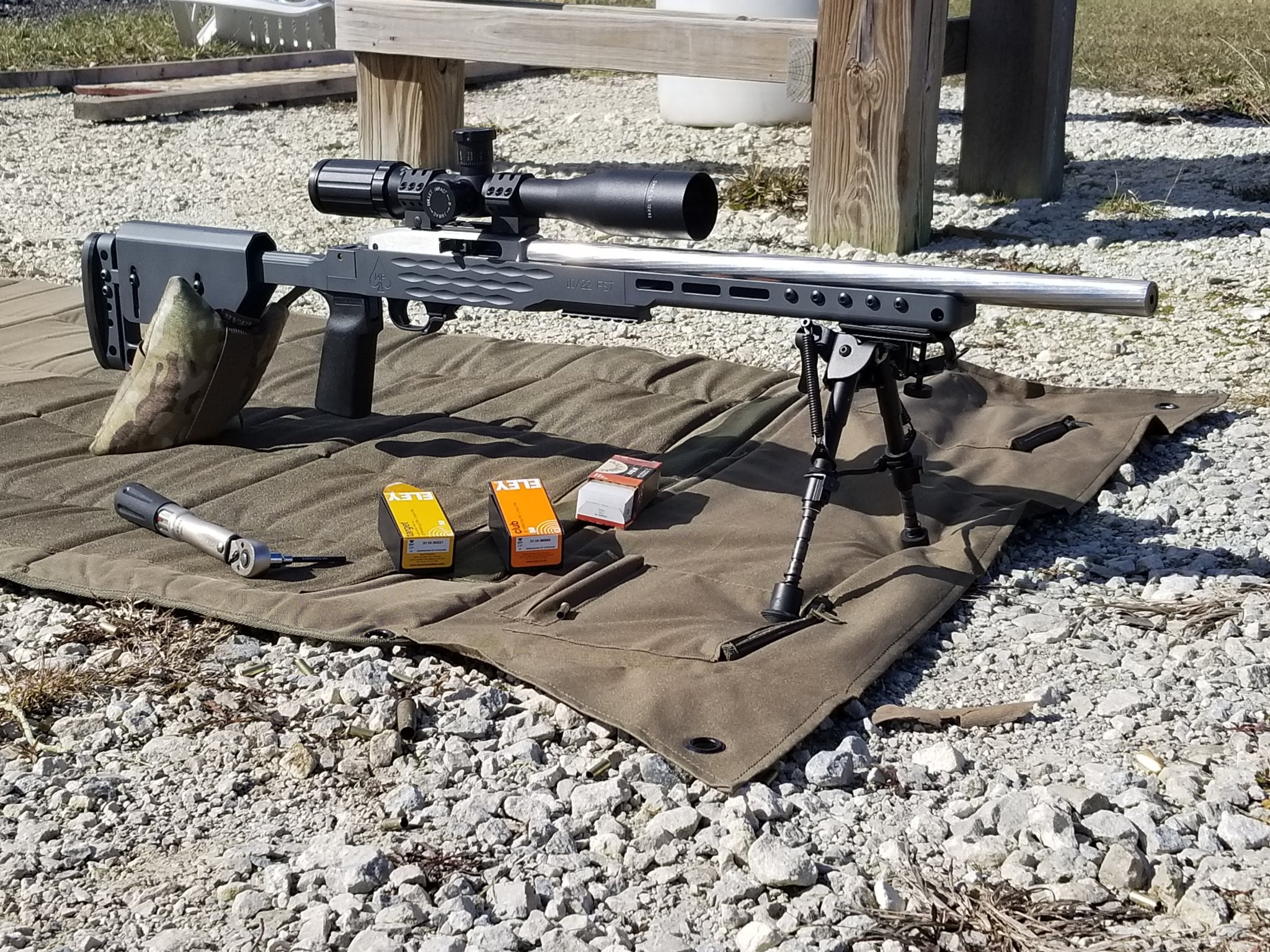

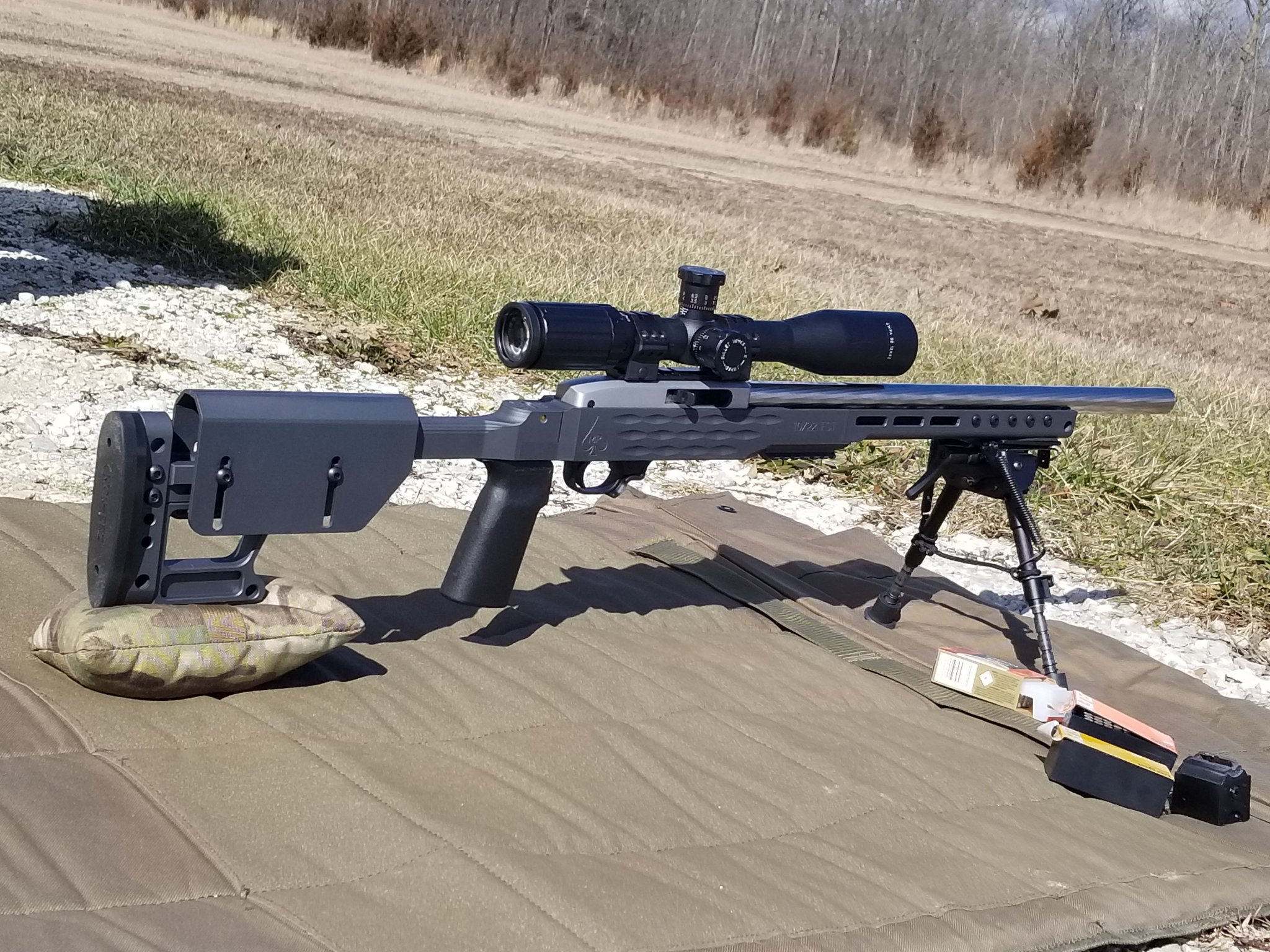

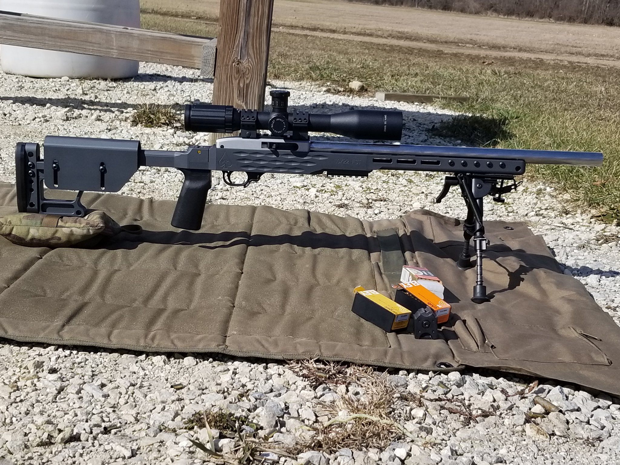

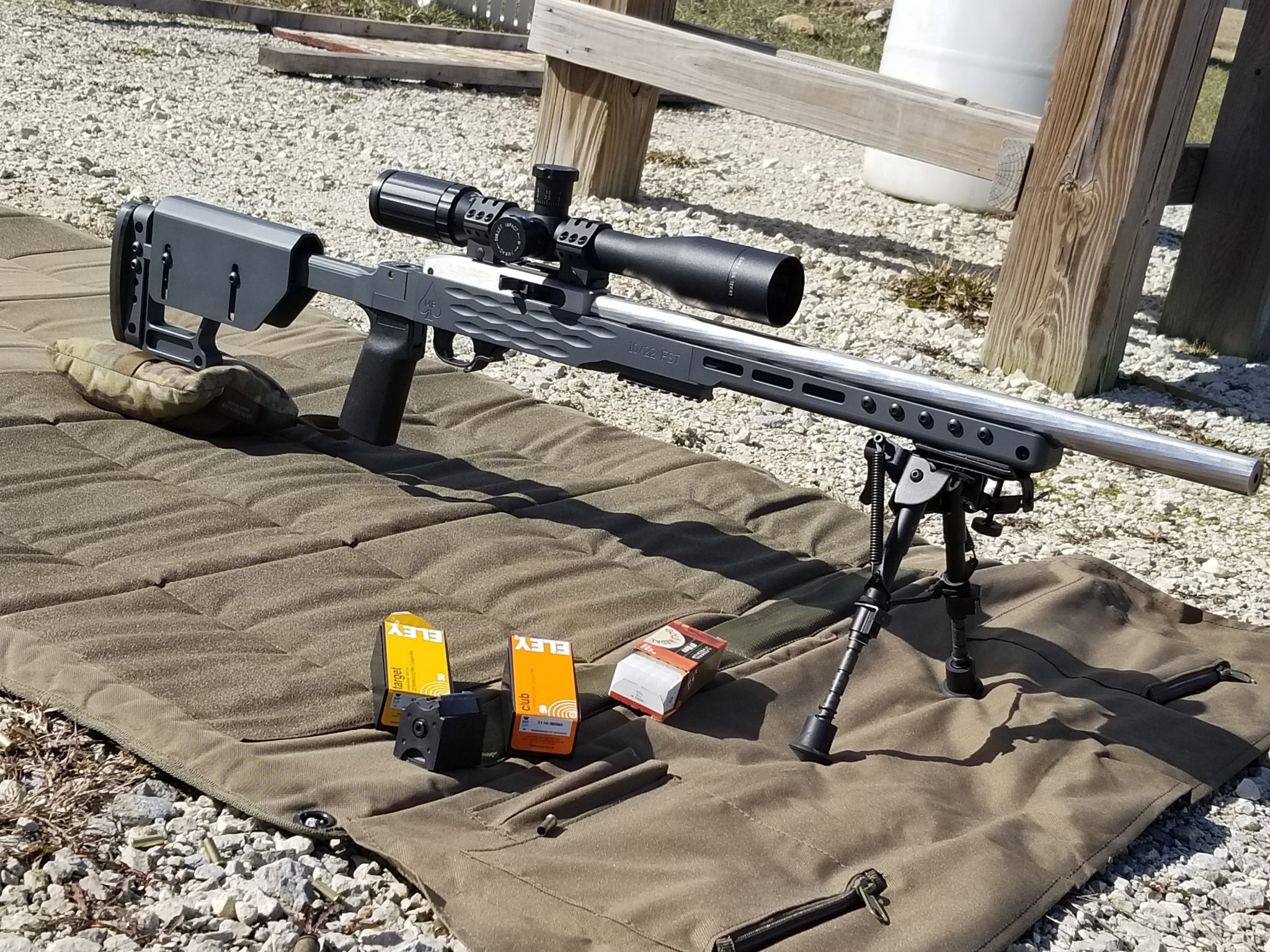

Here are some photos form the range trip. Rifle shot exceptionally well considering it was wearing a factory Ruger target barrel. Consistently .5-.6" at 10 shot groups 50 yards with the occasional .3 5 shot group with Eley Club (orange box). Slightly better groups were achieved with Eley Target (yellow box) at 100 yards, consistently .9 to 1.10" which is all that can be expected from the current barrel. I tried tuning action screw torque values to find a sweet spot for the rifle but accuracy remained unchanged from 20-60 in-lbs in 5 in-lb increments (2.2-7.0 Newton-meters). The ergos are great for prone or positional shooting. So far i couldn't be more pleased with my purchase. 20180310_103933.jpg 20180310_103943.jpg 20180310_103710.jpg

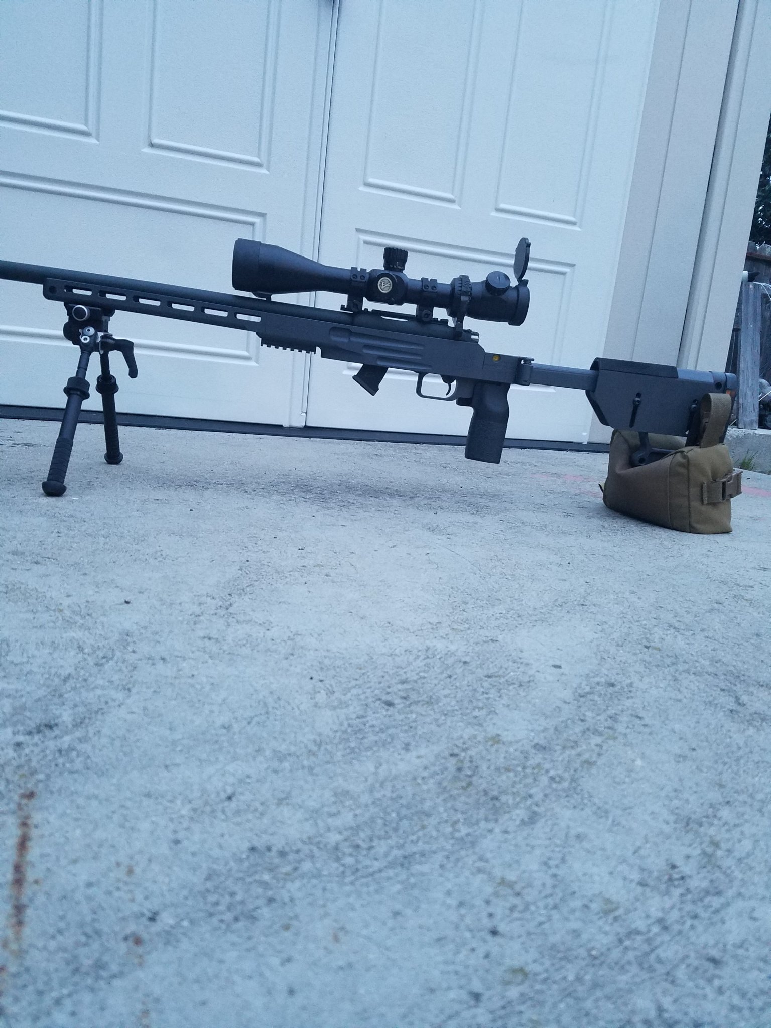

I like to use the MPA enhanced vertical grip and it left a weird gap on my MDT chassis when installed. Got out the black Sugru and after 10 minutes of arts and crafts, problem solved. I let it cure overnight and you can't even tell it's there. You might be able to use it to bridge that gap if you want.
