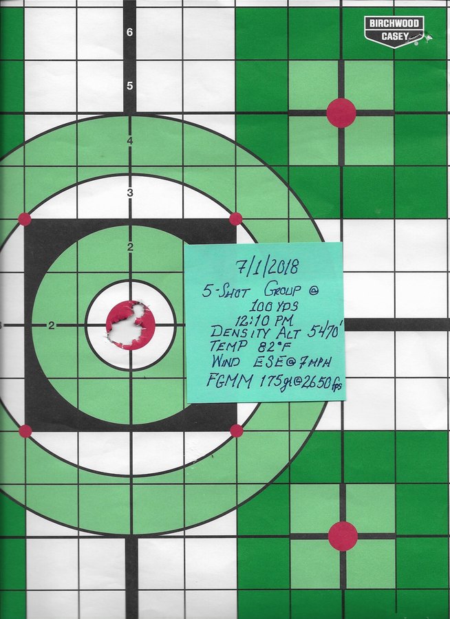

My recent results with FGMM using 175gr SMKs in my AI AT, sighting in for the MHSA Precision Shooting Training class. The flyer at 1 o'clock is operator error.
Harry, humbled operator

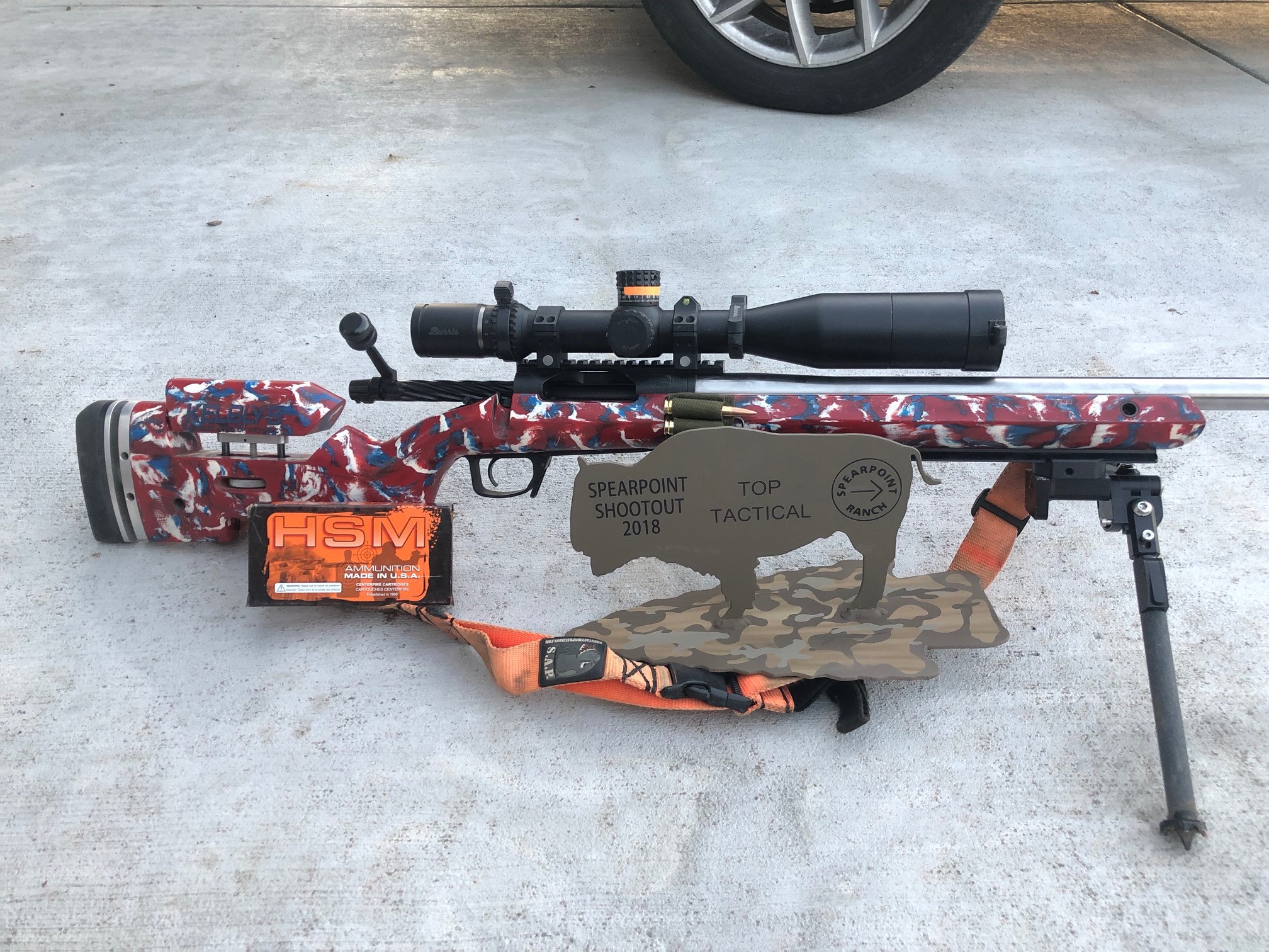

This year I have switched to HSM ammo. 178 Amax going 2720 out of a 28" barrel has netted 2-top 20's in PRS matches and easily taking the top TAC class.
They are decent priced and also offer a 155 gr bullet that shoots better than the 178's but was over the speed limit with my long barrel.
https://hsmammunition.com/match/
Not affiliated with them. A friend turned me on to them and they are legit.
