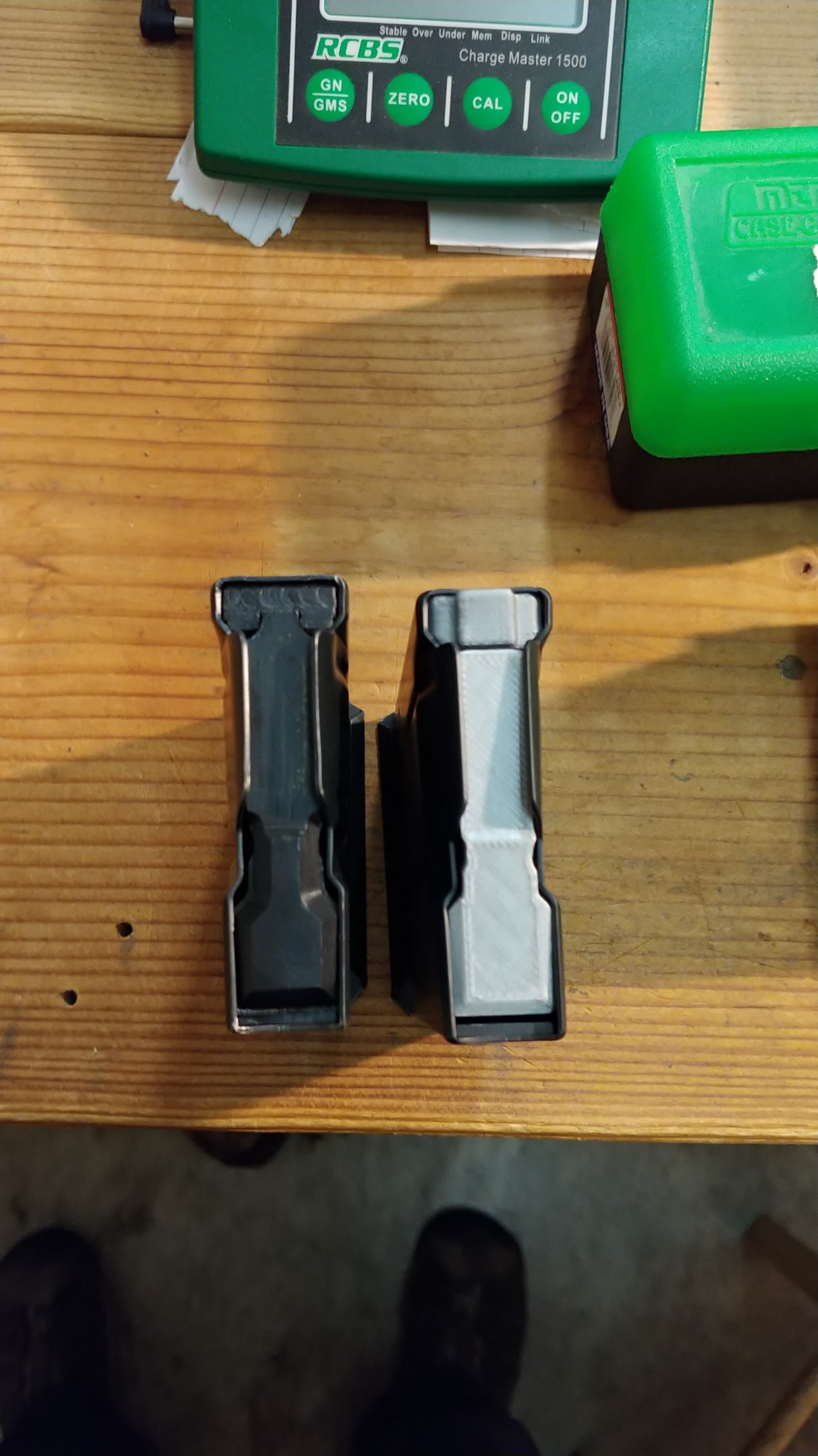

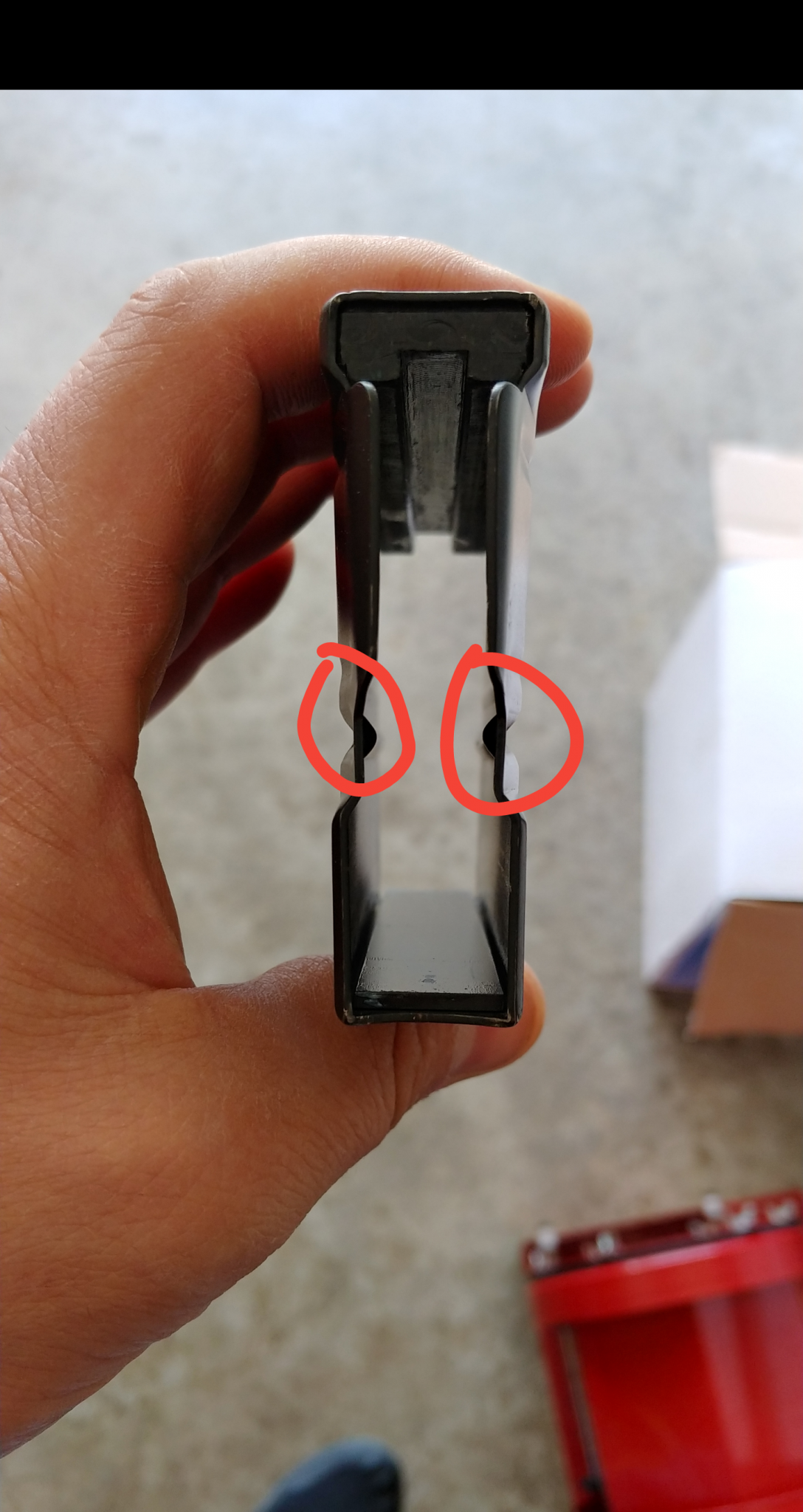

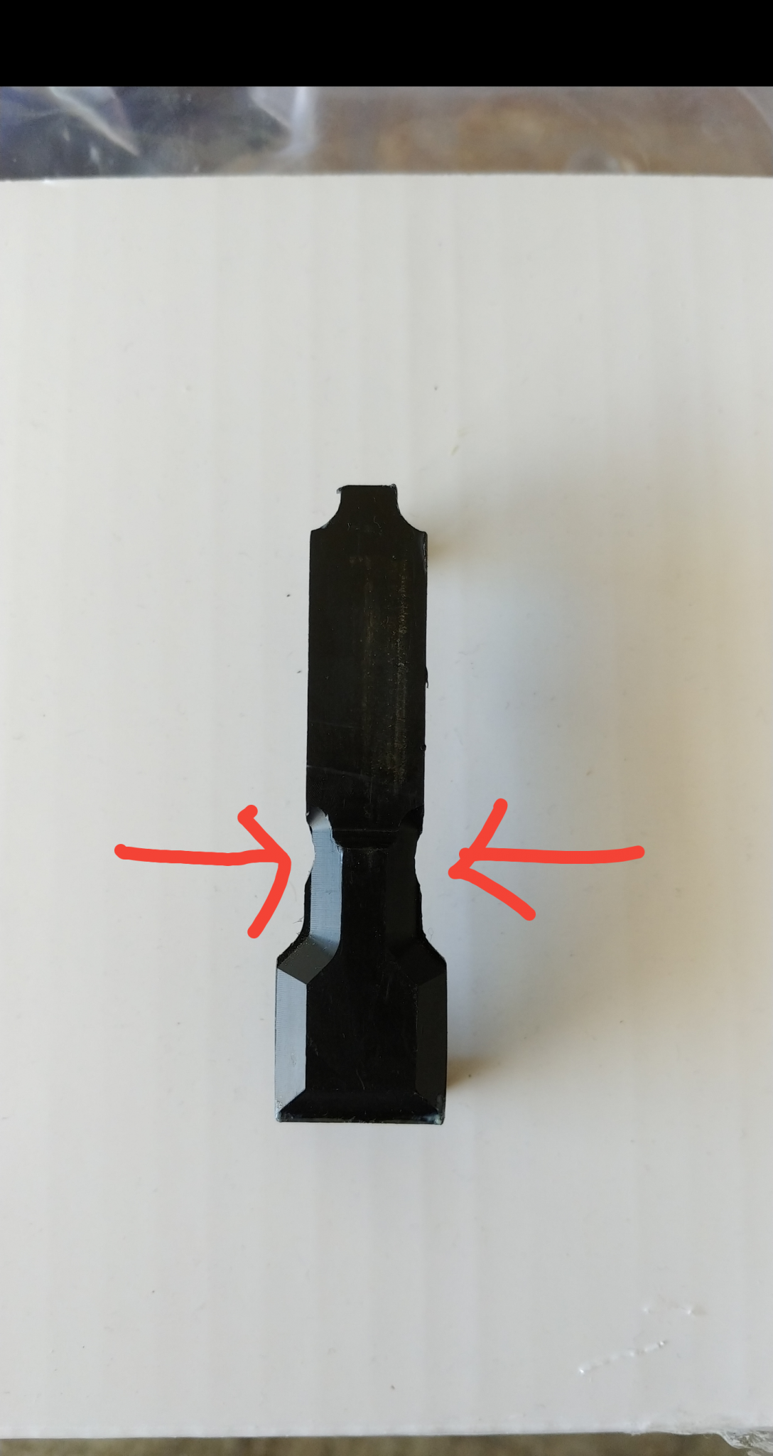

I have an AICS 10 rd magazine with the Primal Rights BR kit.
Wanted a lower profile magazine so I got an ARC magazine & an HRD Gear BR kit on the assumption that it would be an easy conversion.
To say it was not a drop in fit would be an understatement.
Three hours later it’s feeding fine in the workshop,the real test will be on the range though.

Finally got to test the ARC magazine & modified HRD gear kit today.
As I wrote previously it functioned flawlessly in the workshop but today on the range I had two nosedives on the 4th & 7th rounds.
Back to the drawing board.
