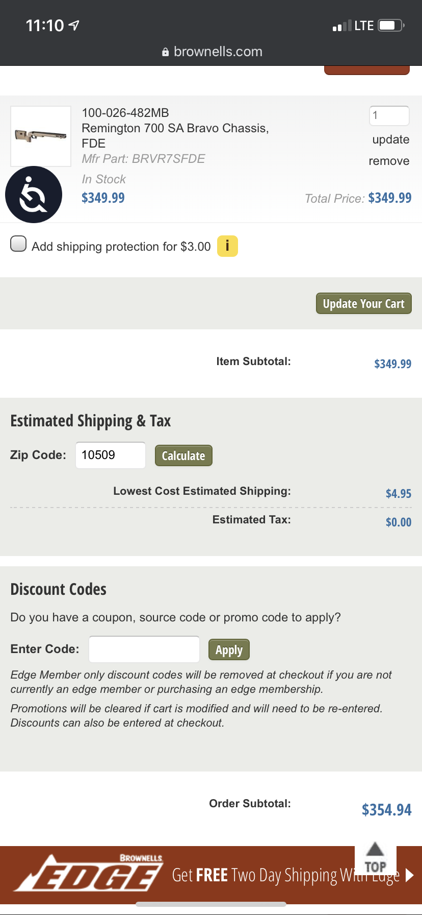

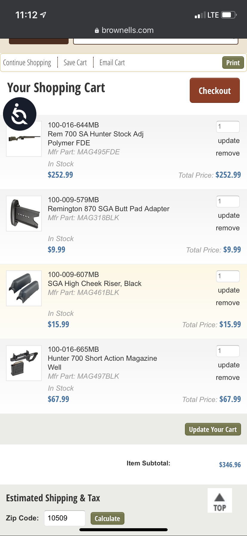

Magpul stock and bottom metal is 247+67=314
KRG bravo is 349 (With w3 backbone its 399)
So the 150 price difference isnt really accurate.

For magpul Hunter I think you need to add the buttom plate/trigger guard and cheek riser price to the cost, which bring cost closer, by all means Bravo looks better for me lol, and the alumni frame goes from action all the way to fore-end, which is more stronger, especially if you using a bull barrel. I mean the price difference is already close to $50, maybe not even a range trip ammo cost, then why don’t you get a better stock per majority opinion?
