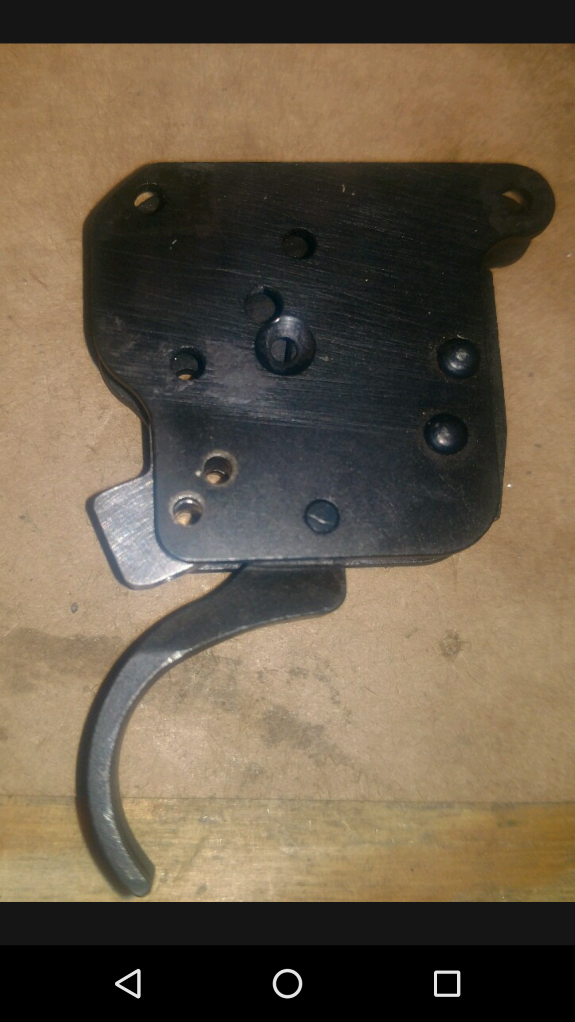

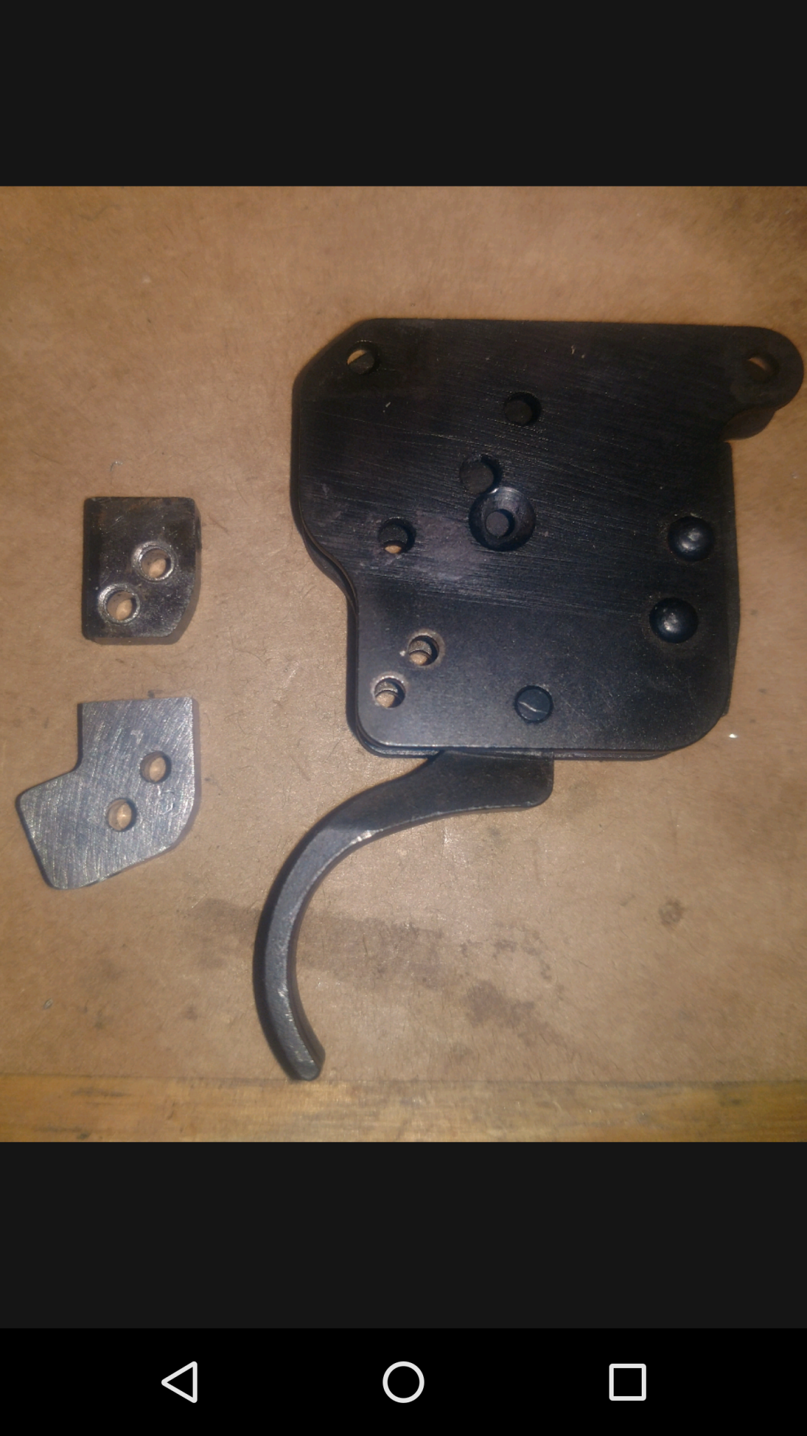

Hi guys, just wanted to post a couple m24 trigger mod pics in case anyone wanted to see them.

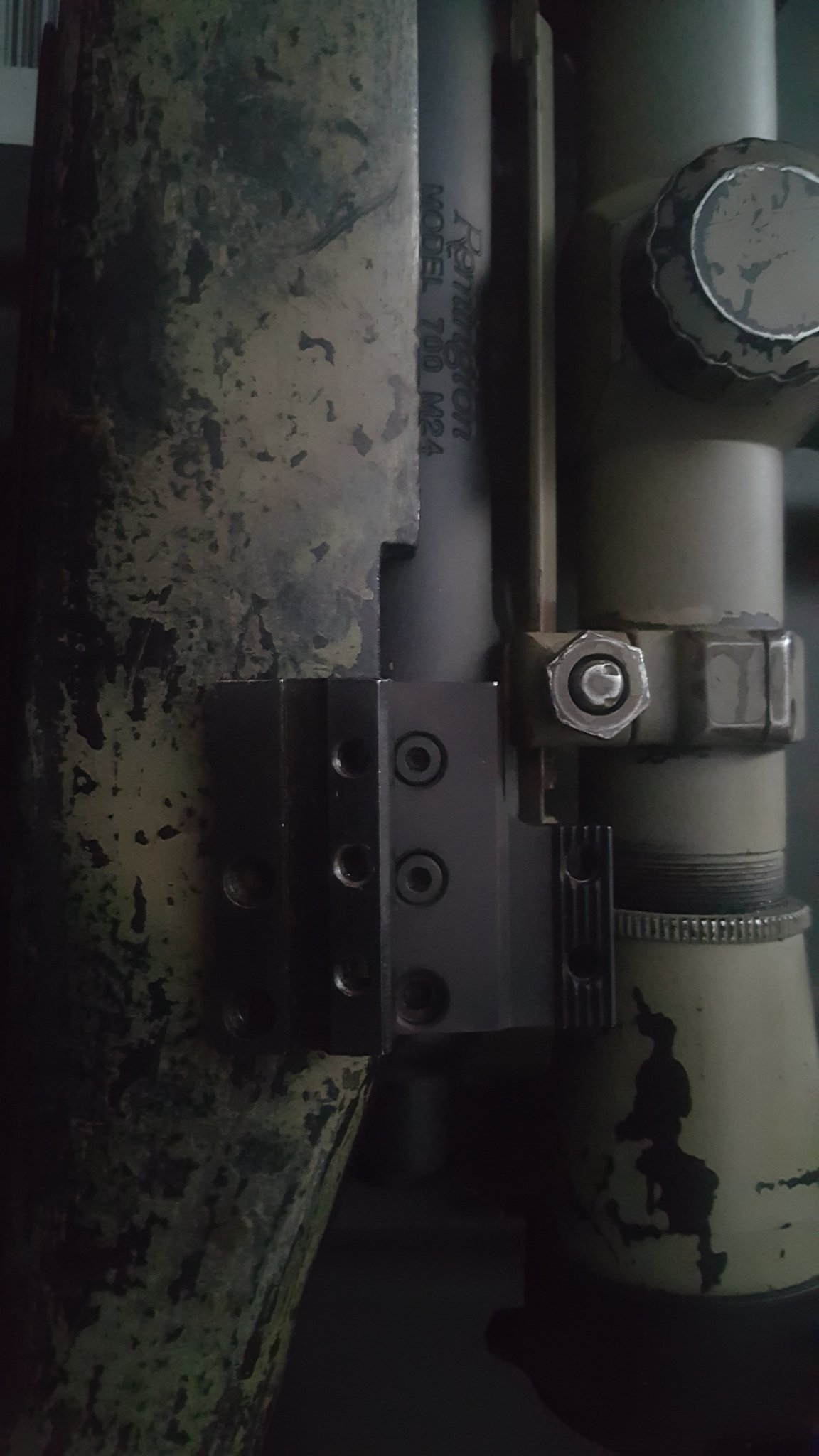

From my own research (and there are plenty more knowledgeable people than I), I don't think you'd be wrong running Redfields. As best I know, there wasn't any sort of mandated swap to OK Weber after a certain date. The group photo above was 2002. The other photo is obviously after that as shown by the uniform.

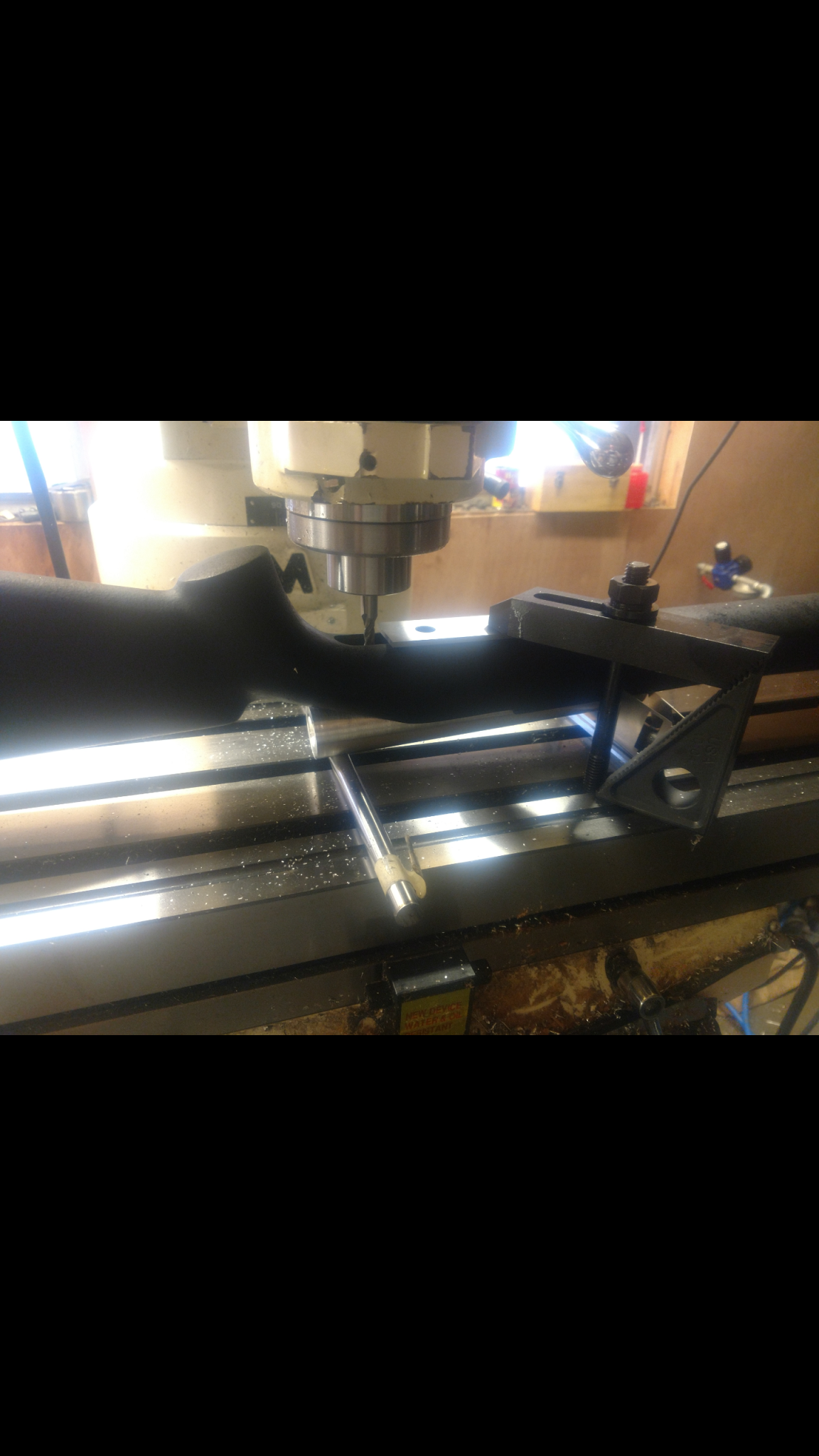

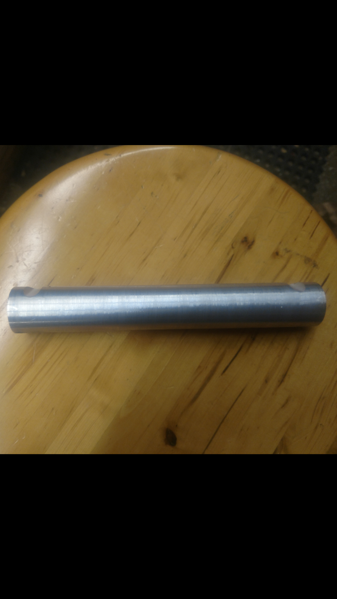

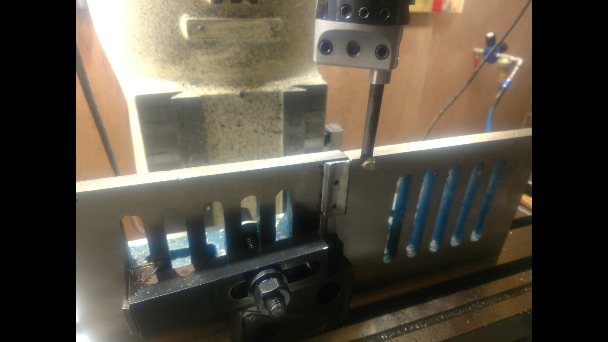

I don't remember why I ended up with the incorrect stock since it was purchased years ago, but the stock I have had the correct barrel channel but was inlet for standard Remington bottom metal. Following are pics of the setup I used for inletting. A piece of rod was turned to the diameter of the receiver and half inch notches were milled on both ends to allow the rod to sit on half inch bars so that it could be adjusted similar to a sine bar to get the required angles for inletting.

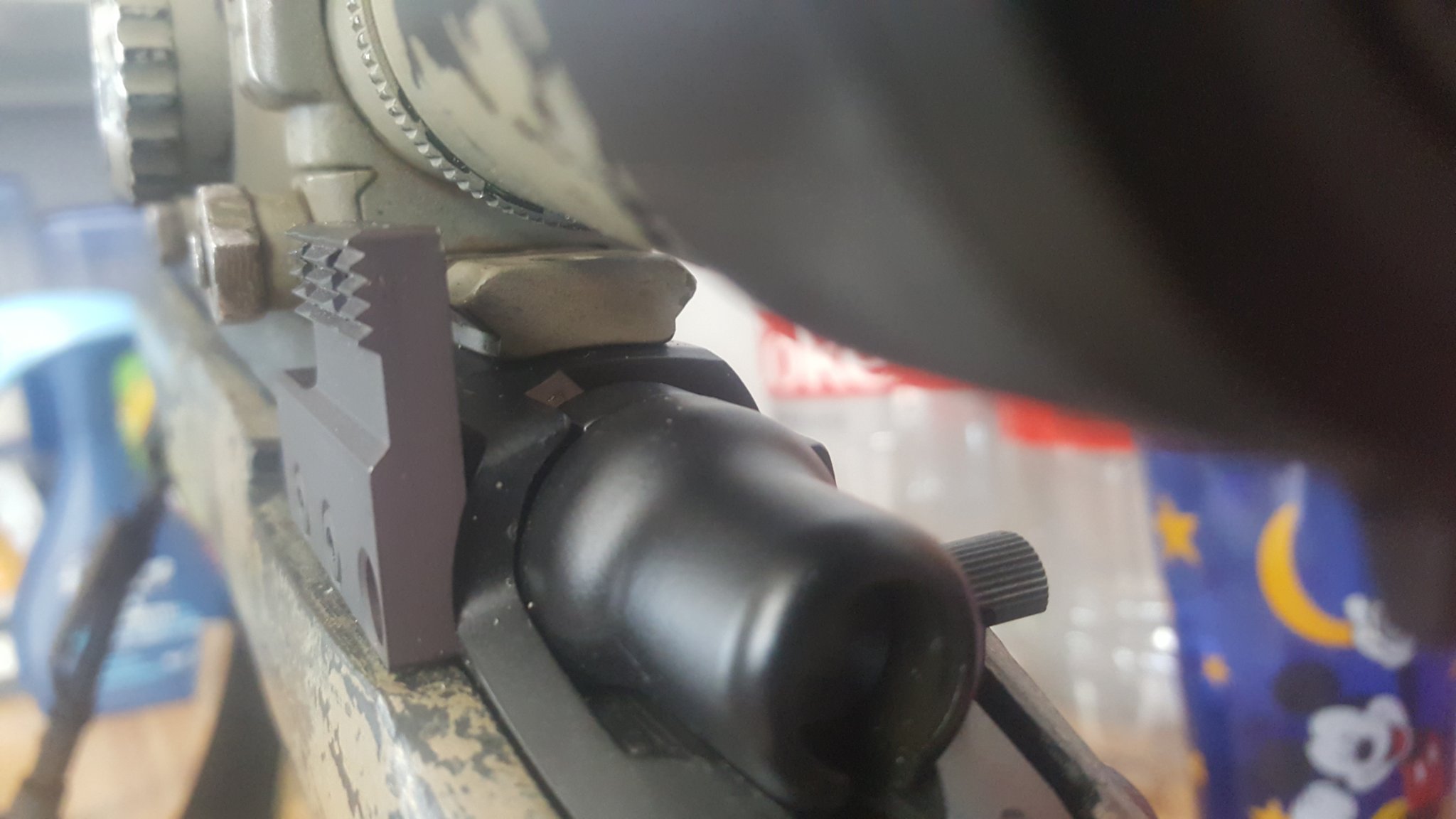

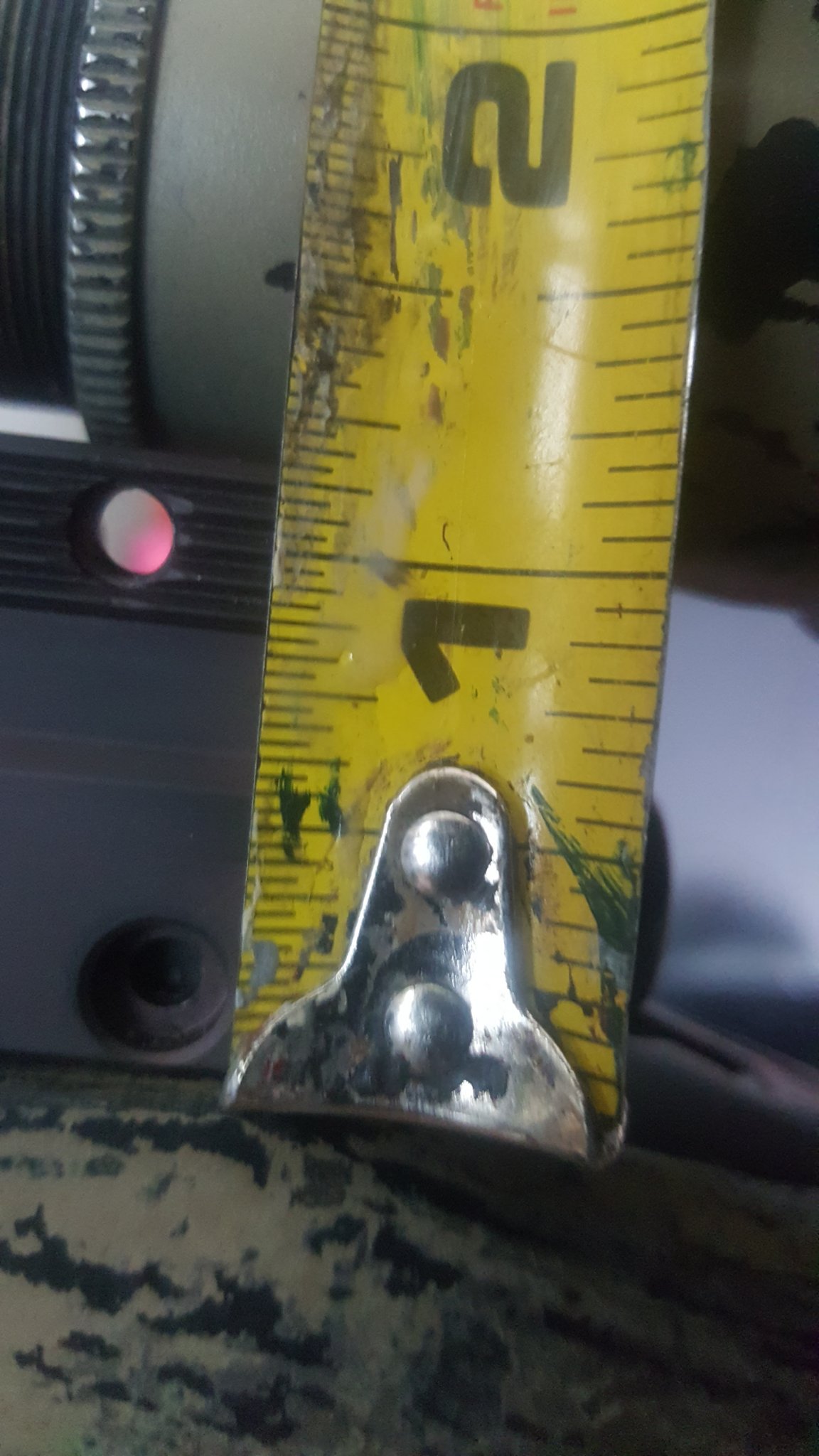

Thanks Marty, some measurements of the OK weber/rpa base would be great if it's not too much trouble. An end view pic of the rpa would potentially be helpful too, I haven't been able to find an end view.
I'm calling the Redfield close enough. I borrowed a sight to test, and it fits correctly. I think it's close enough that no one can tell it's not a real Redfield.

Here's a few. My calipers are at work so I apologize for the rough measurements. Looks like 1.75 in length and right at 1.125 tall

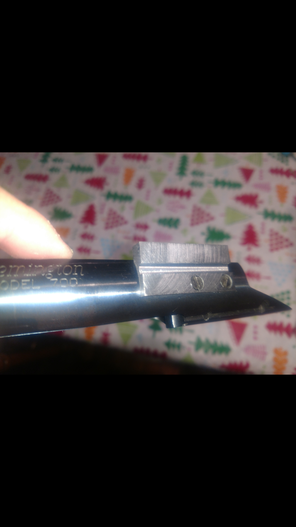

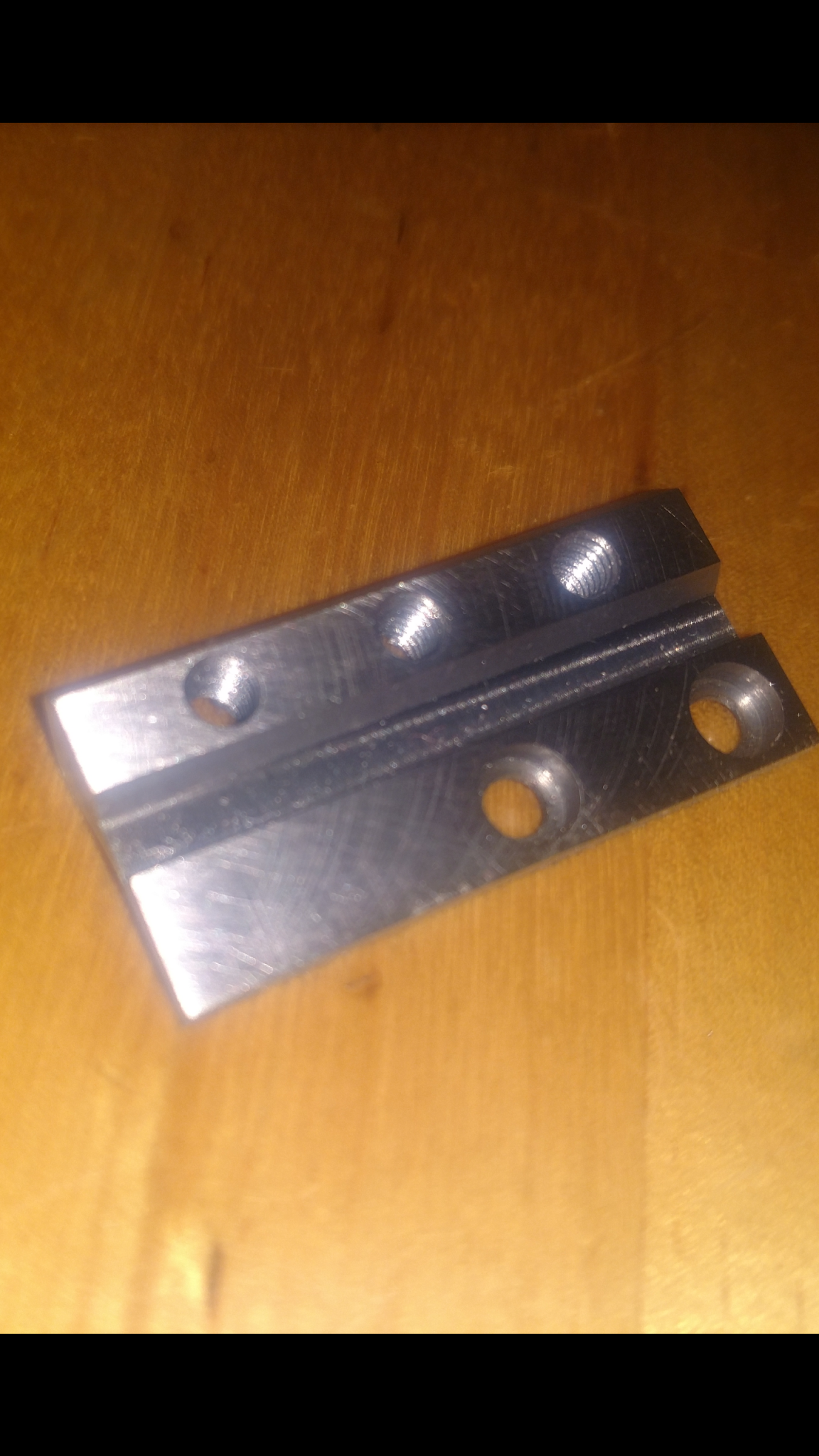

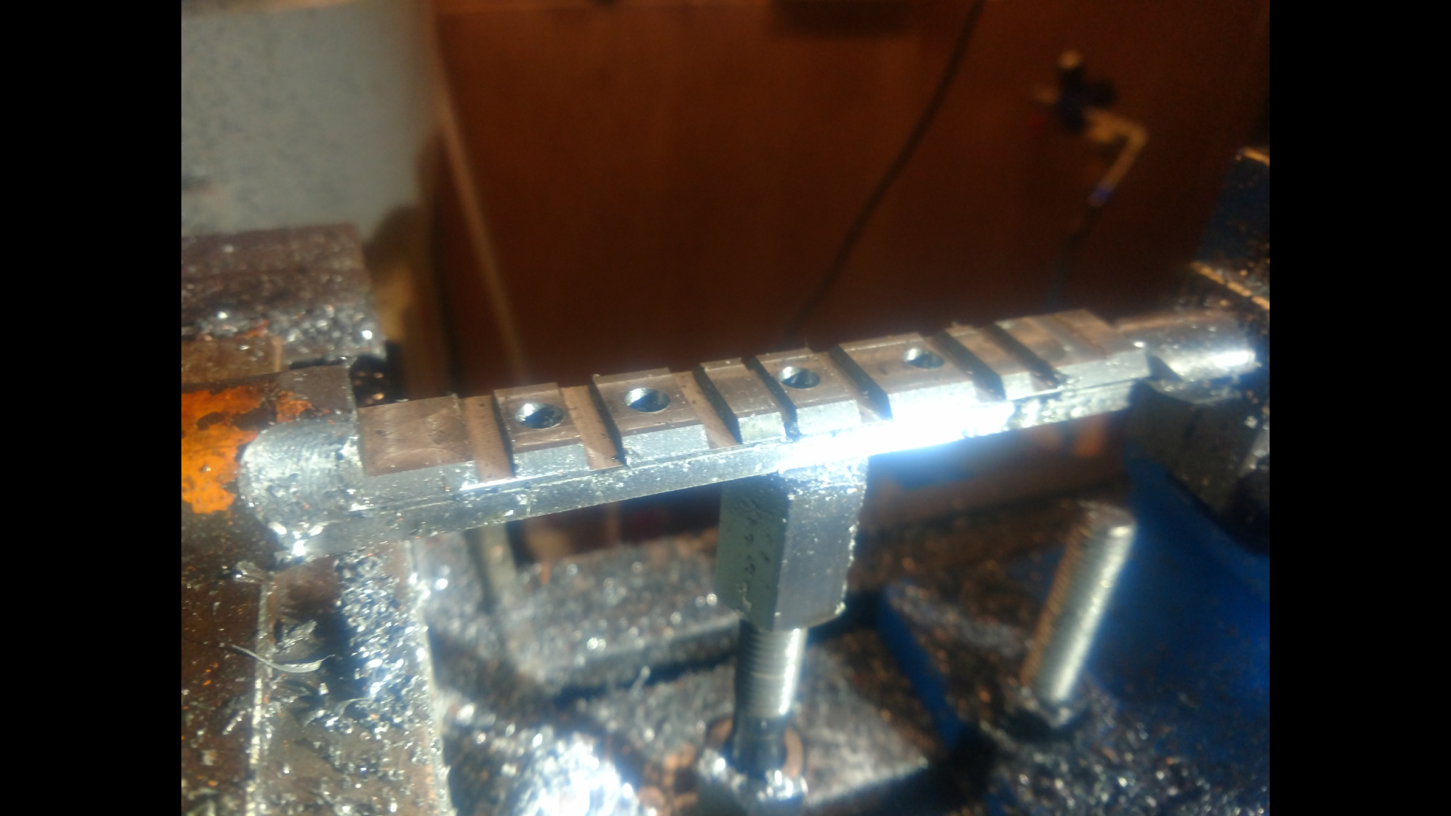

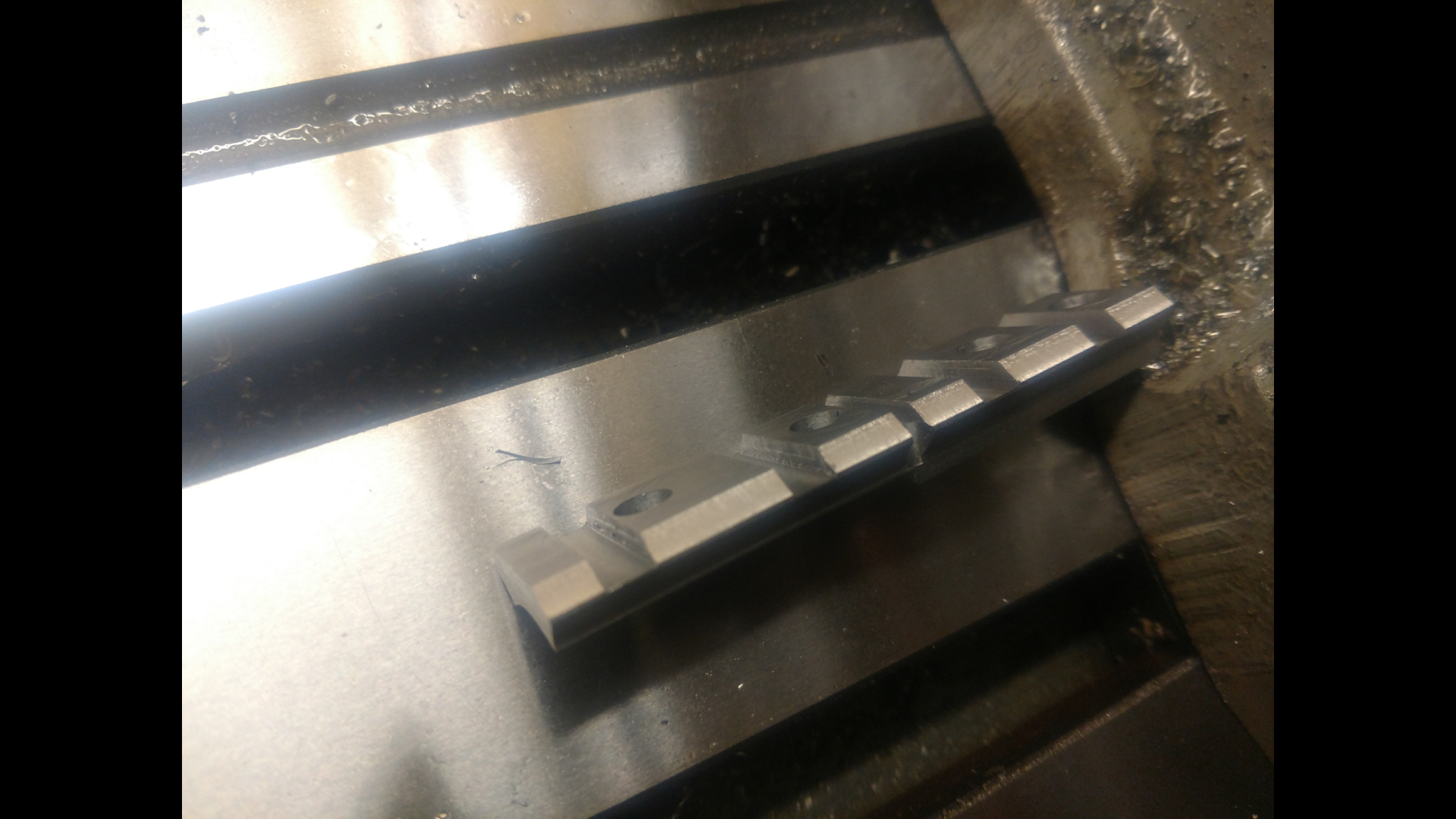

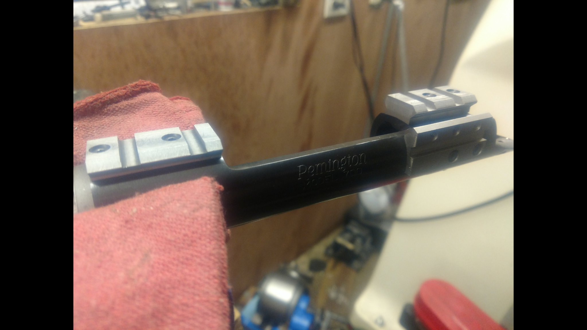

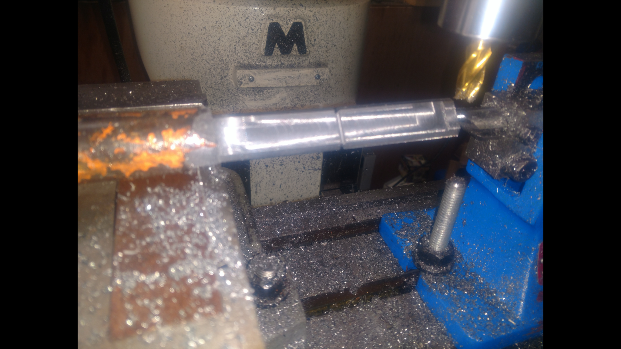

Here are some pics of the making of the scope bases. Tedious and time consuming, but saved the 60 bucks Leupold wanted for them. Not entirely sure it was worth the effort, but got some good practice in anyway...
