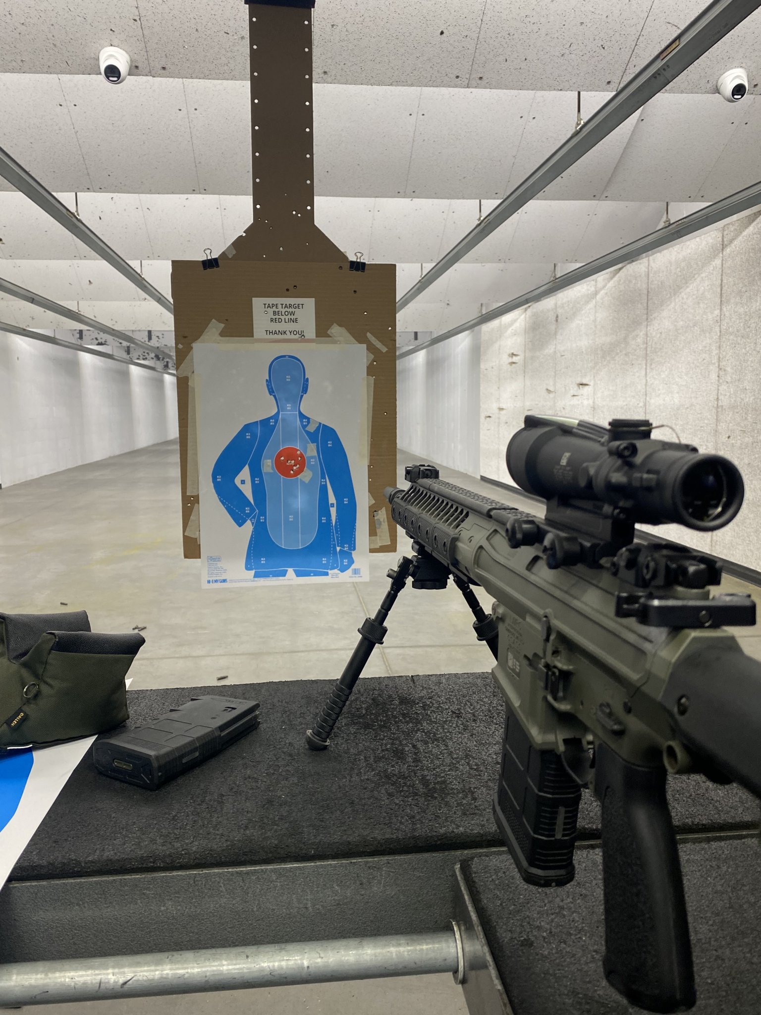

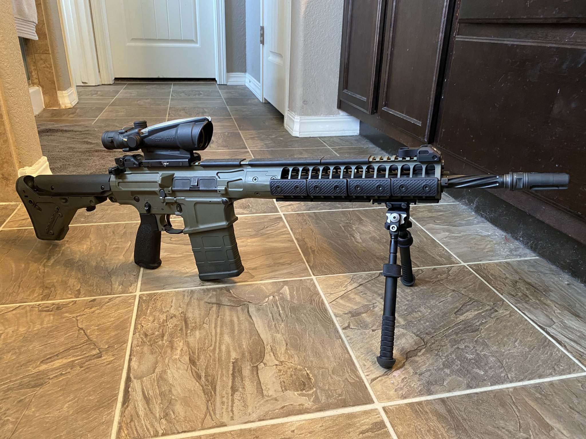

My rifle has been at LWRC for all most two weeks for rework/ repair, so hopefully when I get it back it will be squared away. If you get a chance could you try a box of the 178's and let me know how it goes it would be greatly appreciated.
I couldn't find any 178gr at my LGS to try out through the rifle. I'll keep an eye out for them if I stumble upon them somewhere else.
But here are a couple pics of the rig just for fun.
