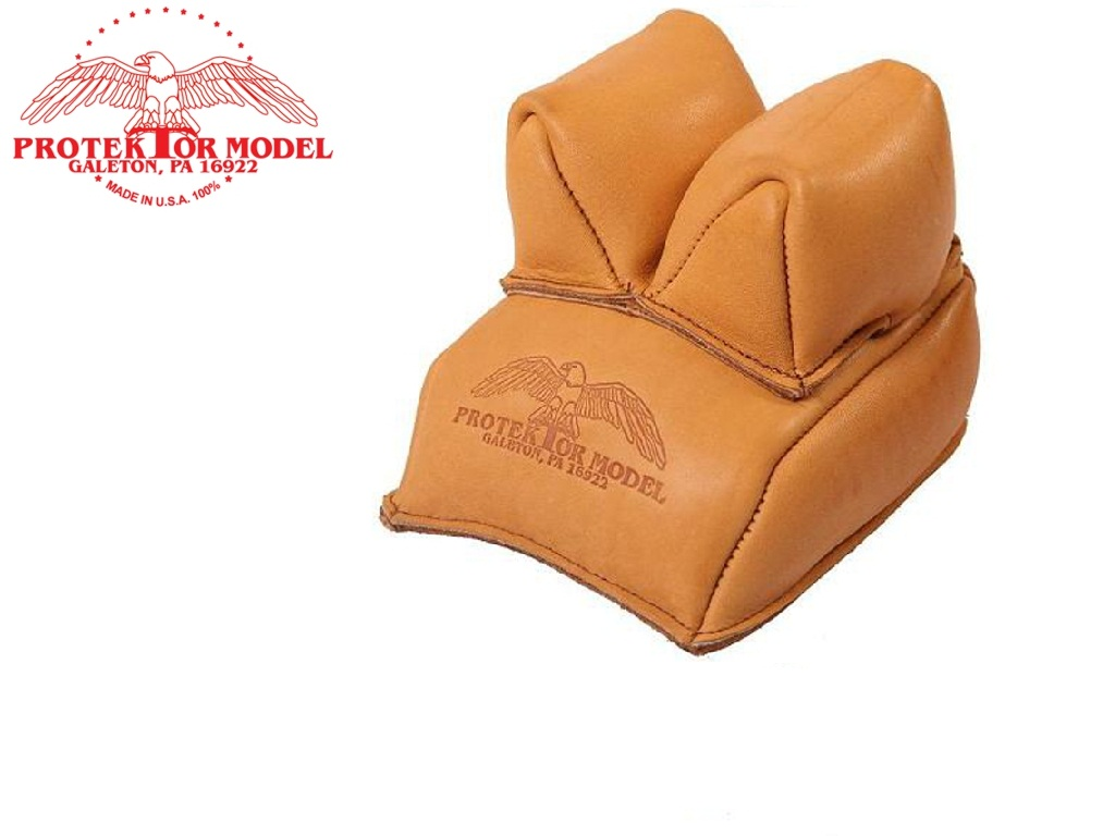

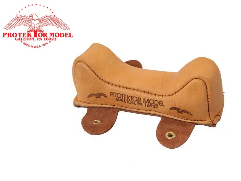

Hi all, I'm starting to get serious about shooting longer ranges, shooting more accurately, and reloading for accuracy.
I've always shot with less than optimal rests in the past, and I'd like to change that. Right now I'm looking for something for shooting off a bench so i can start doing some load development.
I was looking at the local outdoor store, and it seems they either have two bag sets like these: Dead Shot Set
or one really long bag that looks like it cradles most of the rifle like this: tack driver
Which do you guys like better?

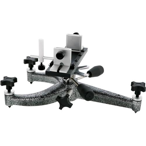

If youre not worried about having to haul it around and just want the best cheap front support I recommend the bald eagle rest, the aluminum slingshot is only 140 right now. I have the cast iron triangle and its great, just hefty.
Throw on a protector bag for it and youre golden.
You can use any rear bag you want but depending n your stock height a rabbit ear would be really nice.

I have found that I can shoot much more consistently and tighter groups off of a bag or bags. I've used a Wiebad Pump Pillow for the front and a Triad Tactical wedge bag for the rear which has worked pretty well. But I found that the pump pillow starts to lose its shape and droop after a couple of shots. I recently bought some Dog-Gone-Good bags after hearing a few guys talk about them on here but haven't gotten to try them out yet. But just from playing around on them in the house they are super solid and extremely well made. They are going to run you a bit of money though, but they are hands down way better than similar Caldwell bags like the Tack Driver. And for a about the same about of money for a front/rear set of Dog-Gone-Good bags, maybe a tad more, you could go the route that @spife7980 mentioned and get a metal mechanical front rest.
