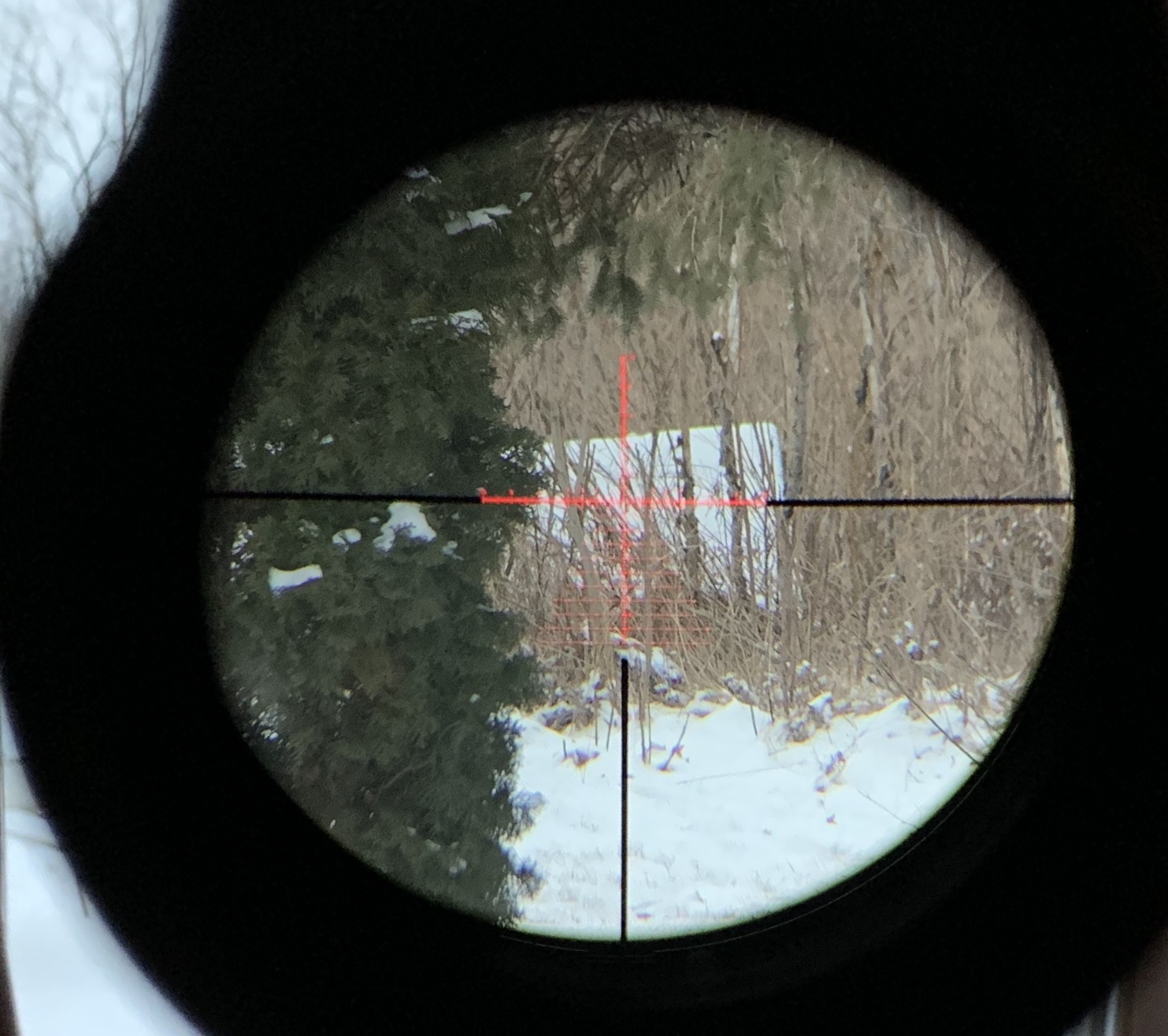

Illumination makes a world of difference on FFP scopes at low power.
AMG at 6x, absolutely fine for hunting...this is in daylight, with the illumination off...pretty damn hard to see with a cluttered bright background. With it around 50%, it stands out just fine.
Excuse the rushed iPhone photos, not the clearest. My Schmidt P4L fine reticle is about the same, and only the center X is illuminated. At 4x, I’ve never had an issue finding the reticle in any hunting situation.
