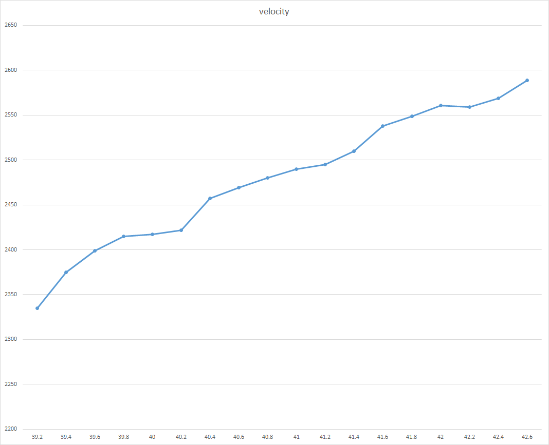

I shot a bunch of rounds through my new rifle build the other day looking for a node. 1 shot each charge, .2 grain intervals. Went from 39.2 to 42.6 grains of varget under 200 20x bergers I see several, but not very wide. Should I keep going looking for something wider? . 2589 fps is already cooking for a 200 grain in my opinion, but I have seen no pressure signs.
28" Bartlein gain twist ending at 10
Varget powder
Lapua Brass
200 20x Berger
Below are the shots
grainsvelocity
39.2​
2335​
39.4​
2375​
39.6​
2399​
39.8​
2415​
40​
2417​
40.2​
2422​
40.4​
2457​
40.6​
2469​
40.8​
2480​
41​
2490​
41.2​
2495​
41.4​
2510​
41.6​
2538​
41.8​
2549​
42​
2561​
42.2​
2559​
42.4​
2569​
42.6​
2589​

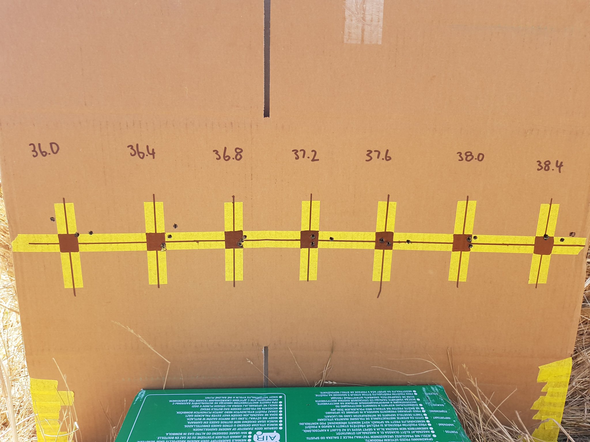

So you're pretty much shooting at small aiming point from left to right shooting lower charges to higher charges. You're looking not only for tiny groups, but most importantly, vertical dispersion. You want to find a charge where the one below it and above it all shot very similar, vertically.
Below, you can see 36.8 to 38.0 are almost all impacting the same, vertically.
(Not my image nor my test, got off the internet)
I'm sure someone could explain it better than I can. Nonetheless, it seems you have a gameplan already and that should also help you determine what load will be best. I'll restate that 39.8 to 40.2 seem to have very little spread, velocity wise. If you're fine with those MVs, it might be worth exploring some more.

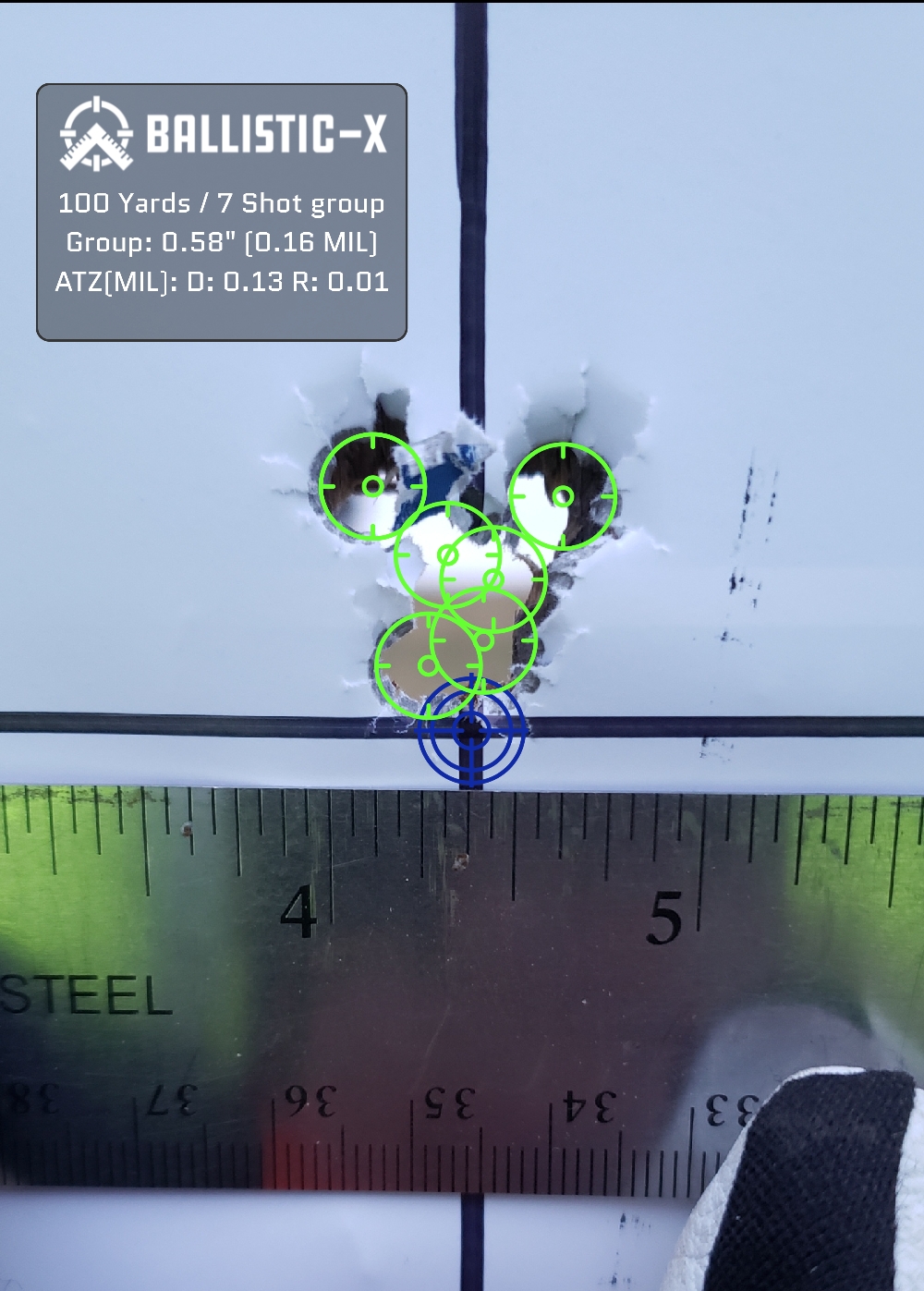

Here is my group from the first time I went out with the lower charges. I wasn't really going for a group but was surprised how tight it stayed with almost 2 grain charge difference. This was 7 shots, I had 3 FTF the first time around for some odd reason. Usually that is a non issue, everything I have loaded since has went bang:unsure::unsure::unsure: This barrel has about 50 rounds on it now

That does look like the easiest node to stay in so far, my issue is that the velocity is a little anemic compared to what I see could possibly be gotten out of it. I am a long/ELR target shooter so the faster I can go within reason the better. I loaded up a few more rounds working up to 44.6 grains. Id like to see what happens in the next node or two if pressures allow. My barrel starts at a 12 twist and ends at a 10. I am currently seated 4 thousandths off the lands for this initial testing. I had heard T rifling could help pressures, but I am almost 3 grains past max published data.
