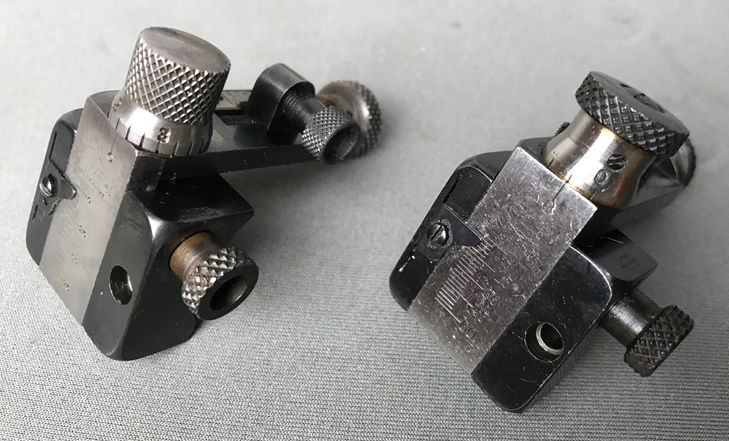

WJS - Scalloped over wood, straight bar....
WHS - scalloped dogleg bar....
I think I could use either certainly the WHS would allow some more adjustment if barrel/blocks are an obstruction.
The WJS Im looking at is NOS condition so Ill be paying a good penny for it. Anyone has either of these Im interested trying to save a little money.
Edit - RTH and I were typing at same time I agree with him WHS looks better for my build.
