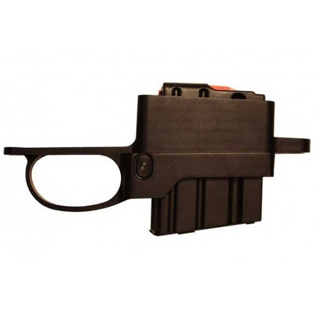

I recently looked into a 223 trainer for the first time, and I'm a bit dismayed at the dismal magazine options that seem to be available.
I'll probably end up using several of the MDT polymer 223 mags, but I'm quite surprised that no one has came up with a more efficient magazine option.
I get the excessive dimension front to back, as the mag has to fit in a standard short action mag well. That extra length is part of the reason I'm building a 223 on a 308 length action.
The (mostly) single stack nature, and the height/width of the mags seem ludicrously large for the meager 10 round capacity. It sure seems that there should exist some AW type mag for a 223 bolt gun, or at least a version like ARC's double stack/single feed 308 mags.
Am I overlooking some workaround to obtain a ~20 round capacity 223 mag in the form factor somewhere in-between a 10 round AI and a 10 round AW mag?
I own a dremel, a file, a feed lip bending tool, various epoxies, welder, etc. and I'm not shy about using them in the slightest. I'm not scared to experiment, but if someone has pursued this project before it would be nice to get a head start or a point in the right direction.

So it sounds like no one has ventured out into a double stack setup... darn!
I have kinda a hybrid use in mind. I’m not building my 223AI to launch “heavy” match bullets. I’m building a 1:9 twist more or less for a varmint slaying rig, but with some occasional use for practice or low recoil fun. I’m copying Ed’s idea of mirroring his trainer to his match rifle, so it’ll be setup with the same A5 stock, same length/profile barrel and same scope as my 260 match rifle. I figure that way while I’m giggling my head off exploding prairie dogs I can be practicing improvised shooting positions, target acquisition, and all that good stuff.
Sounds like most guys just are having good luck with the Accurate Mag mags... I like the price in the MDT’s so I was kinda hoping they were the deal.

Thanks for the input on the magazines guys. I guess AI mag length ammo and 20 round capacity just isn't doable.
I'd be pretty much starting from scratch, and i'm not that into it. If I got a 10 round AW mag the internal width would be to wide for the 223 rounds to stack correctly, even if I could get the lips bent around and narrowed up to hold them in.
