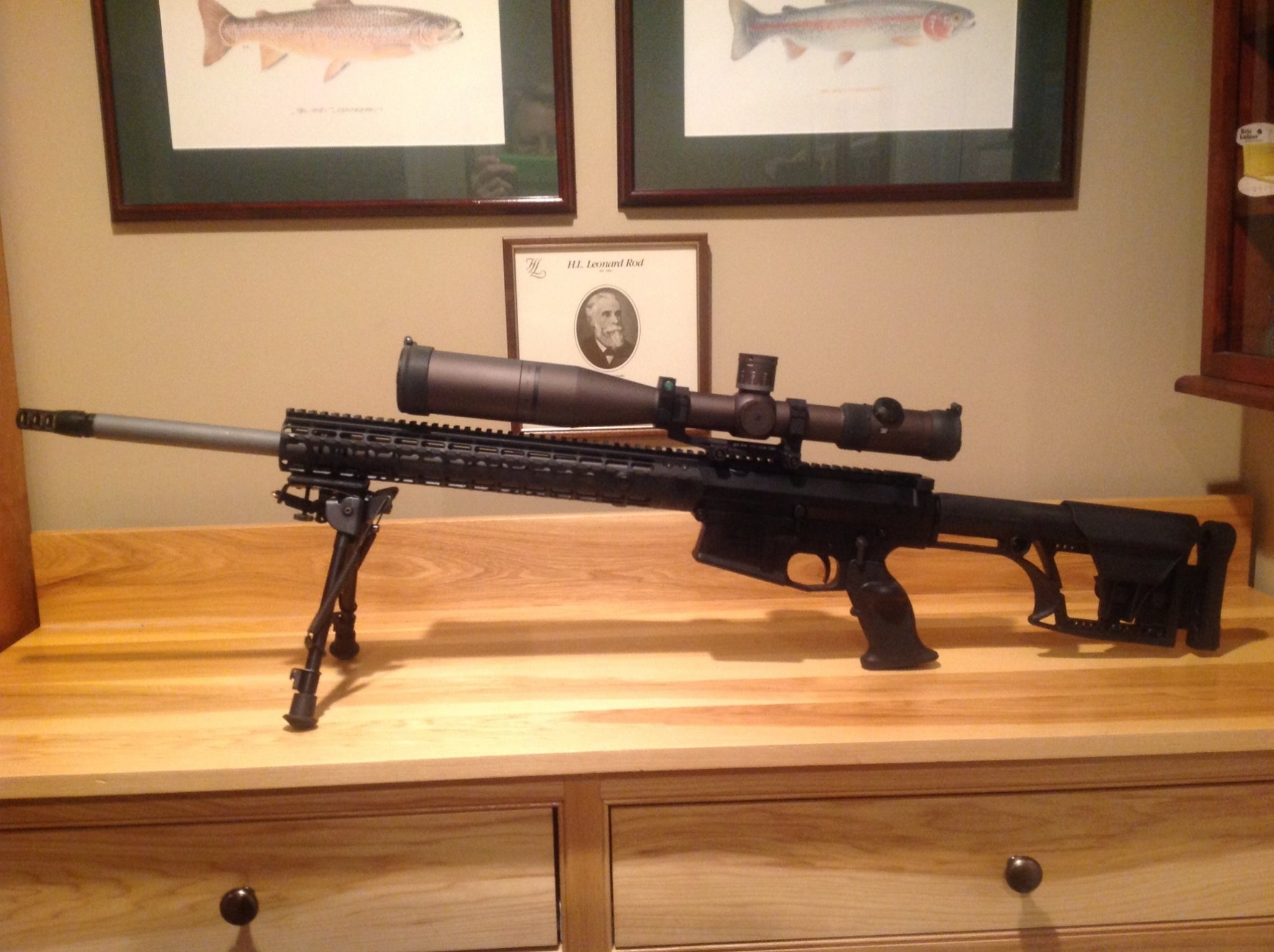

Great build, I recently finished a similar build using the Aero upper and lower, Luth AR rifle image.jpgstock, I used the Aero H P bolt, B A 22" barrel, Aero hand guard, MBT trigger. Have a few hundred rounds through it and it's completely reliable and much more accurate than I hoped !

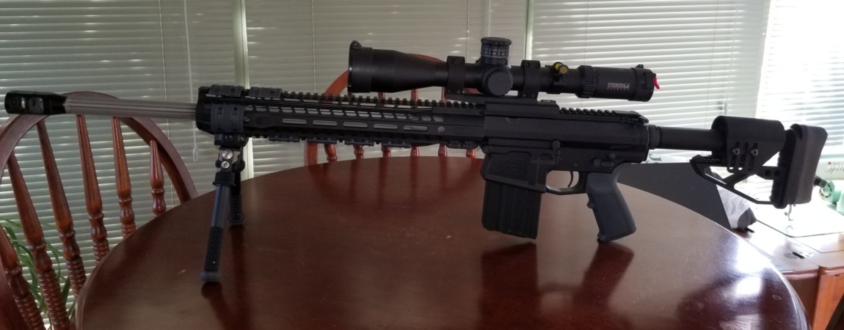

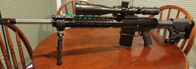

My 6.5 Creedmoor is built on an Aero receiver set. I really like that rifle. If you want to build, go for it. Accurate and nice shooting. Adjustable gas and heavy buffer. I have an SLR gas block on mine and a JP Silent Capture Spring. A standard weight AR10 rifle buffer worked as well. The SCS was standard weight, but I just changed it to a heavy configuration (1 tungsten weight and heavy spring). That made it a little smoother. If you go with an XLR stock, you'll need a carbine buffer and spring if you don't go with the Silent Capture Spring. This is the same setup I used in my 6mm Creedmoor as well (Just took it; the 6mm, out for its maiden flight today. Here's my 6.5 Creedmoor. A Saker 762 can is sitting in jail for it right now. One when it had a PRS and another with the XLR it has now.
Only other thing that's changed is that it now has a Steiner M5Xi 5-25x56 on it. That Steiner 3-12x50 now lives on the 6mm Creedmoor. If I can provide any info for you let me know. Build is Aero receivers, Rainer 22" Ultramatch barrel w/rifle length gas, JP brake, SLR adjustable gas block, nitride gas tube, Aero melonite BCG, SLR 15" intrepid rail, Atlas bipod, AR Gold trigger, Ambi selector, MIAD grip, XLR stock, JP Silent Capture Spring, LaRue LT745 20 MOA mount, Steiner 5-25x56 Military M5Xi scope.
