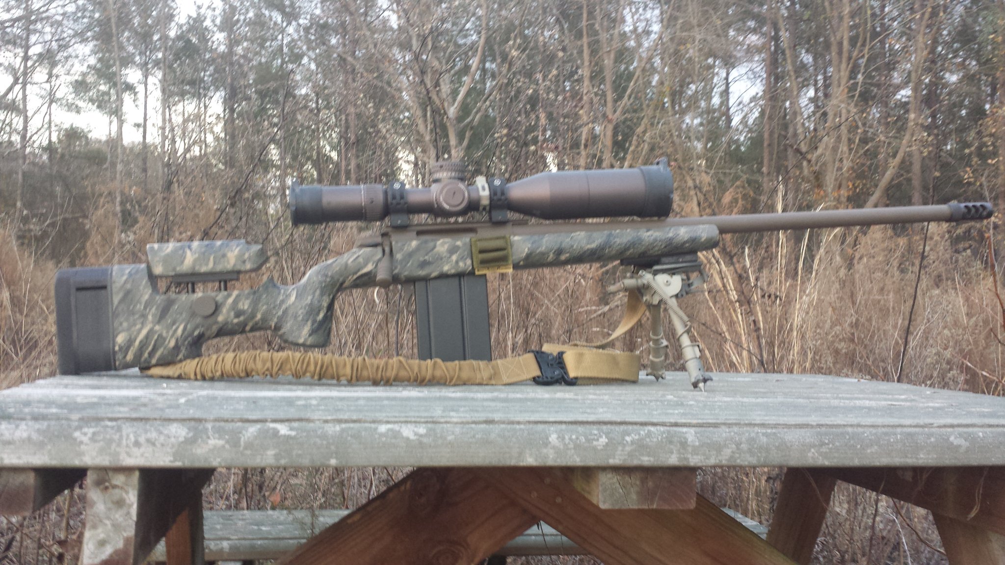

This was my first match rifle, Tikka long action .284Win shooting 180 Bergers in 10rd long action AI mags. Prone stages were ridiculously easy, i loved that caliber for that. But i gave up way too much performance on the positional shooting with the amount of recoil. I have since moved to a short action 6.5 Creed, and i dont feel hindered at all. I can now spot impacts and misses off of most positions with the reduced recoil. And i dont worry as much about losing brass lol. If i had to do it again, i would have forgot about my long action that i had in hand and started with something proven to work, instead of trying to shoehorn my long action into these style matches.
