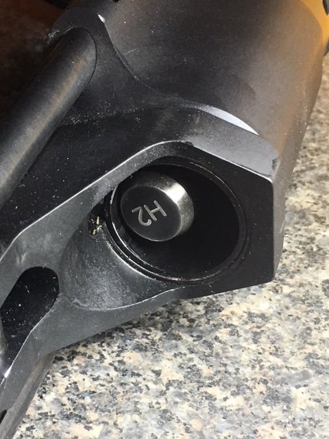

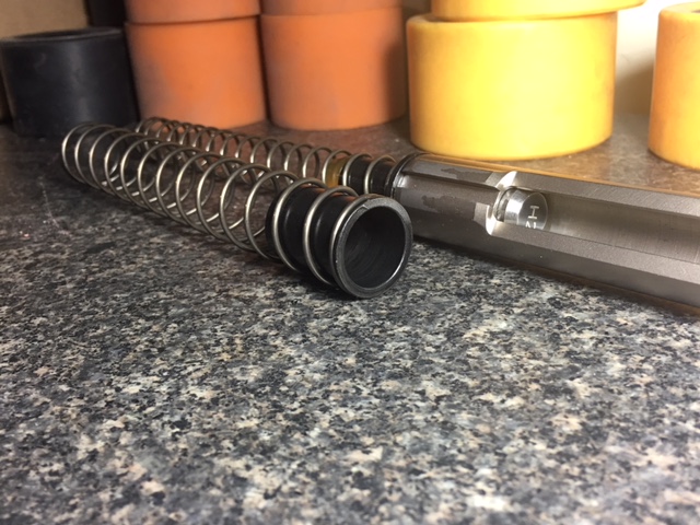

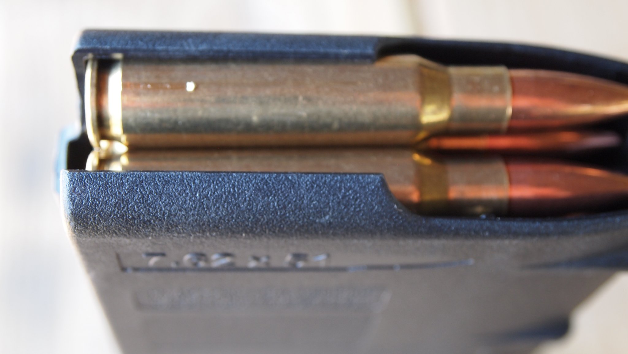

I make a 15rd LR20 that is shorter than the grip. Ask Market Garden about his experience with it as he was one of the testers of the prototype and used his in competitions. </div></div>
That would be great. Can you make them into 10 round mags or is that wishful thinking? I would be down to get a few of those 15 rounders for sure. They seem to be the ticket!
Thanks for the pics Market Garden </div></div>
The 10rd in the chopped down config is a little trickier. If I put a block inside the spring, it's short enough that it will bind up with the spring. If I make a mold that's the exact shape of the inside of the mag, it further compresses the spring to the point where an already-stiff spring may provide enough compression to cause problems with feeding. The other method would be attaching something to the follower but due to the design of the follower, that's pretty tough and less than robust.
Mind shooting me a PM with the details? I could use a few for when I'm doing some prone shooting.

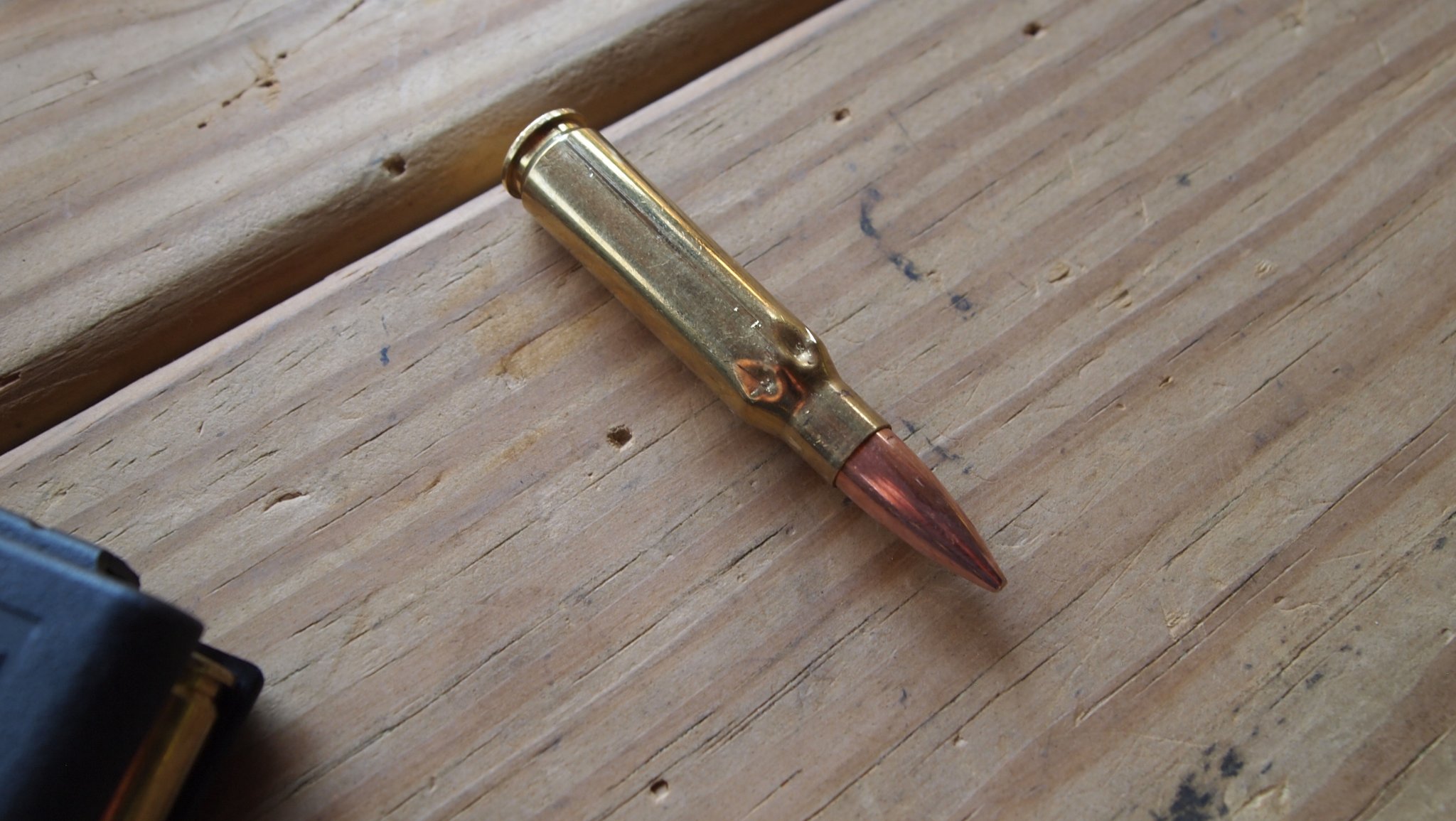

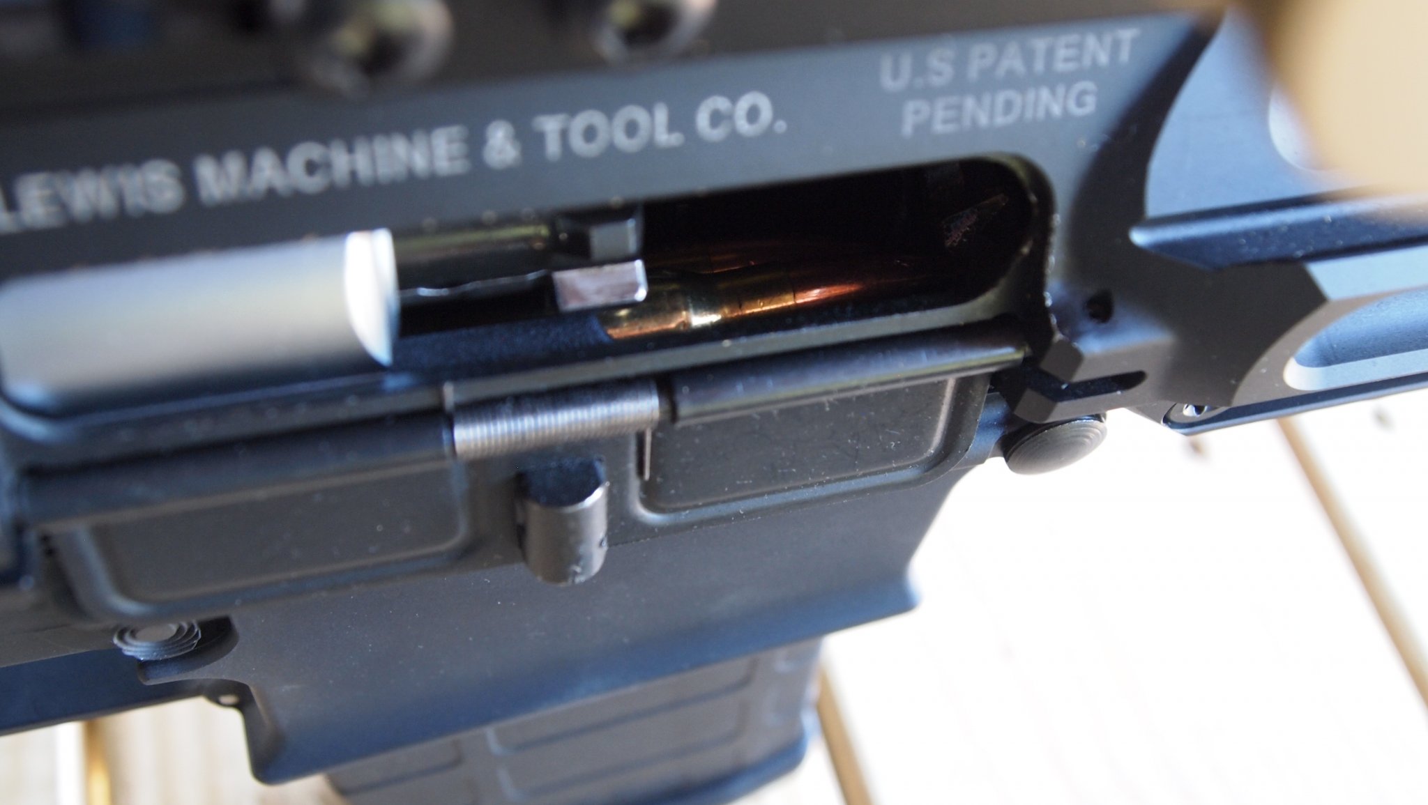

FTF - Failing to Feed.
My 16 inch full railer MWS has never been absolutely reliable since day one.
Probably should have thought about this earlier (2012) but shortly after buying the LMT I fell in love with bolt guns.
Wanted to get some muzzle velocity data today and I find my self straight pulling this POS on every round.
Hit the bolt release with one round in mag - Thunk - the round hangs up, I pull the charging handle back, round pops out of feed lips, I let go CH and chamber round.
Does it with LMT factory mags and brand new KAC mags I just bought.
Factory FGMM or my reloads, same, same.
My CQB spits brass like a full auto.
Where do I start to get big bro to do same?

The beat up brass occurs after the initial fail to feed.
When I release the bolt stop (or slingshot) the bolt rides forward, over the top round, than stops 1/3 of the way to battery. The bolt or carrier makes a scrape mark on the brass during its forward travel.
Than when I pull back the CH to attempt a second chambering I end up with a double feed requiring I strip the mag from the rifle and I think that is when the shoulders of the round get wrapped by the bolt lugs.
I think I bought my rifle in the heat of the late 2012/2013 period when AR makers couldnt get ARs out the door fast enough. Perhaps the part of the bolt designed to catch the case head and feed it is a hair out of spec.
They will make it right.
Occurs with LMT, Knights and Magpul mags.

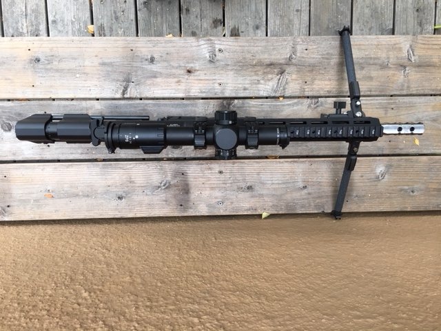

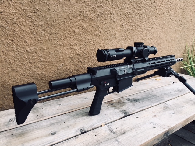

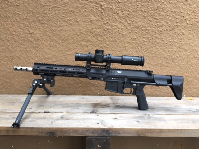

Here is my newly configured LM308MWS.....
MLKMWS monolithic upper receiver for large caliber rifle platforms.
LMT® 13.5″ lightweight stainless steel 1:11.25″ RH 5R cut 7.62×51 barrel.
SCJ Ti Titan compensator (barrel and comp will be pinned and welded to meet >16" ATF reg, then Cerakoted to match)
MVP Industries 7.62 NATO ARC Stock
Hogue AR15 / M16 15 Degree Vertical No Finger Groove Piranha Grip G10
ARC mount.
Minox ZP8 TAC 1-8 x 24 scope
RRS M-LOK Adapter Plate
Ckye-Pod
The M-LOK upper and 13.5" SS lite barrel saved 1.3 lbs. Total weight of the rifle with scope and mount is now 11.4 lbs. (not including bipod) Total length collapsed is 30.5".
Range Report forthcoming.
Thanks for looking,
Rasyad
PS...someone make an offer on my CQB upper HERE.
ARC mount.
Ckye-Pod
Thanks for looking,
Rasyad
View attachment 6932663View attachment 6932664View attachment 6932665

You built pretty much a 7.62 CQB weapon. Short barrel - check
PDW stock - check
High end 1x8 - check
BA bipod - wait whaaaaaaaaat?- Hold! Hold!
Is that just so you could take pics?
Out of curiosity, what’s the designated purpose of your MWS?

Robert..... The idea was ONE compact, modular rifle system for All foreseeable needs. I had my pick of weapons and the LM308MWS was it for me. At some point I will get a 20 inch 6.5 Creedmoor barrel for longer range. The Ckye-Pod stays off the rifle until needed. The Minox ZP8 scope is really awesome in the 1-4 range, daylight bright, comfortable, fast and all that. However, unless the light is just right I have learned that my eyes struggle with precision at 100 yds let alone longer distance. So the scope is on the block. I am looking at top tier 3-18 x 50mm or 56mm scopes and will run a 45 degree red dot in one configuration, and an Aimpoint or Eotech solo for CQB. Anyhow, those are my thoughts.
As an aside, I don't really have a collector bone in my body. I do care about optimizing the fit and function for me which keeps things simple. One rifle (LM308MWS), one shotgun (Benelli M4), and one side arm (HK 45c).

Talked through the problem with Gene at LMT. Very helpful trying to track down any issues.
Tried a few things with similar results.
Rifle on the way to LMT now and Im sure it will come back a well tuned machine.
Note - I usually use metal body KAC or LMT 10 round magazines but for this test Gene suggested I tried a new from the wrap Magpul twenty and it exhibited the same FTF as the metal mags.
I'd like to know the outcome of this, what they find, what serial number range your rifle is and anything else they say. My father's does the same exact thing although I think it's worked it's way past it now. Haven't shot it much lately so I'll have to check it out and see.

What buffer are you using with the ARC stock?

Does it run? would like to know how it runs off with that buffer system?

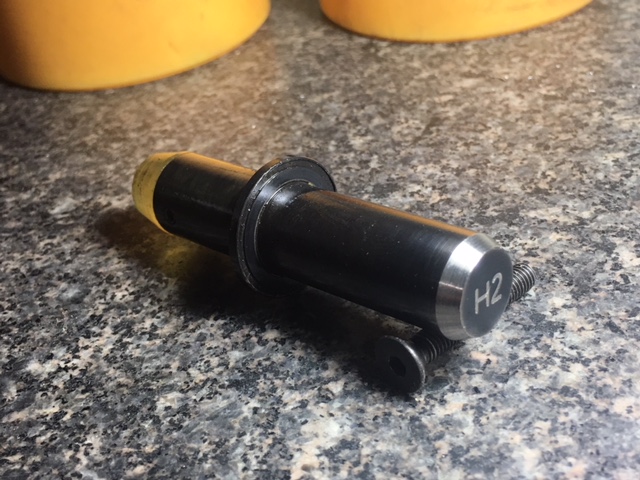

A couple of you asked about the function of the rifle with the MVP ARC Stock. I am using the H2 buffer as recommended MVP and the rifle cycles perfectly. As you can see by the photos half the buffer lives inside the OEM LMT bolt carrier. This is one of the ways MVP is able to make the ARC stock so compact. The ARC stock uses a 2 spring design that is very quiet and effective. The rear of the bolt carrier drives against the flange of the ARC buffer. In order to open the action the BCG must be held back while depressing and holding a spring button on the bottom of the ARC stock base. (yes this is a two handed operation) Releasing the charging handle allows the BCG to return to battery while the flange of the buffer is caught and retained by the spring button catch. With the spring compressed and the buffer retained the action can be now open normally. Assembly of the action is really straight forward. Close the action, push in the rear take down pin, and cycle the BCG. When the BCG contacts the buffer and compresses the spring the retaining spring button catch releases automatically and the buffer slides back into position partially inside the rear of the Bolt carrier.
I did have a small issue that I fixed (and let MVP know about). As you can see by the images I chamfered the leading edge of the buffer on my lathe. I did this to smooth the return entry of the buffer into the rear of the bolt during assembly. As shipped, the buffer would hang up on the end of the bolt and require cycling the BCG several times before the buffer would slip into place. With the chamfer, assembly function is now 100% reliable first time every time.
Rasyad
MVB ARC buffer and spring assembly.JPGMVB ARC H2 Buffer 1.JPGMVB H2 Buffer installed and retained.JPG

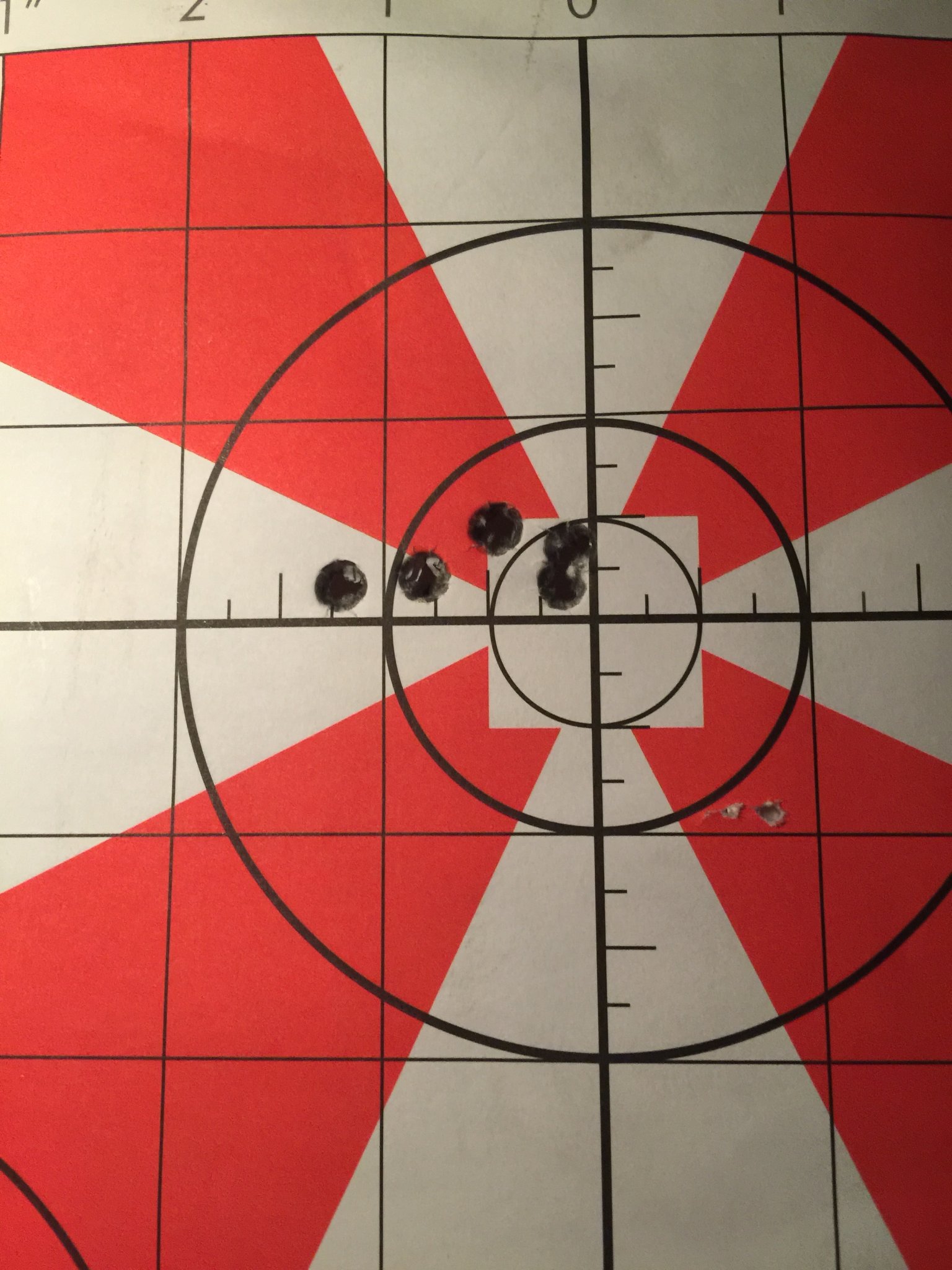

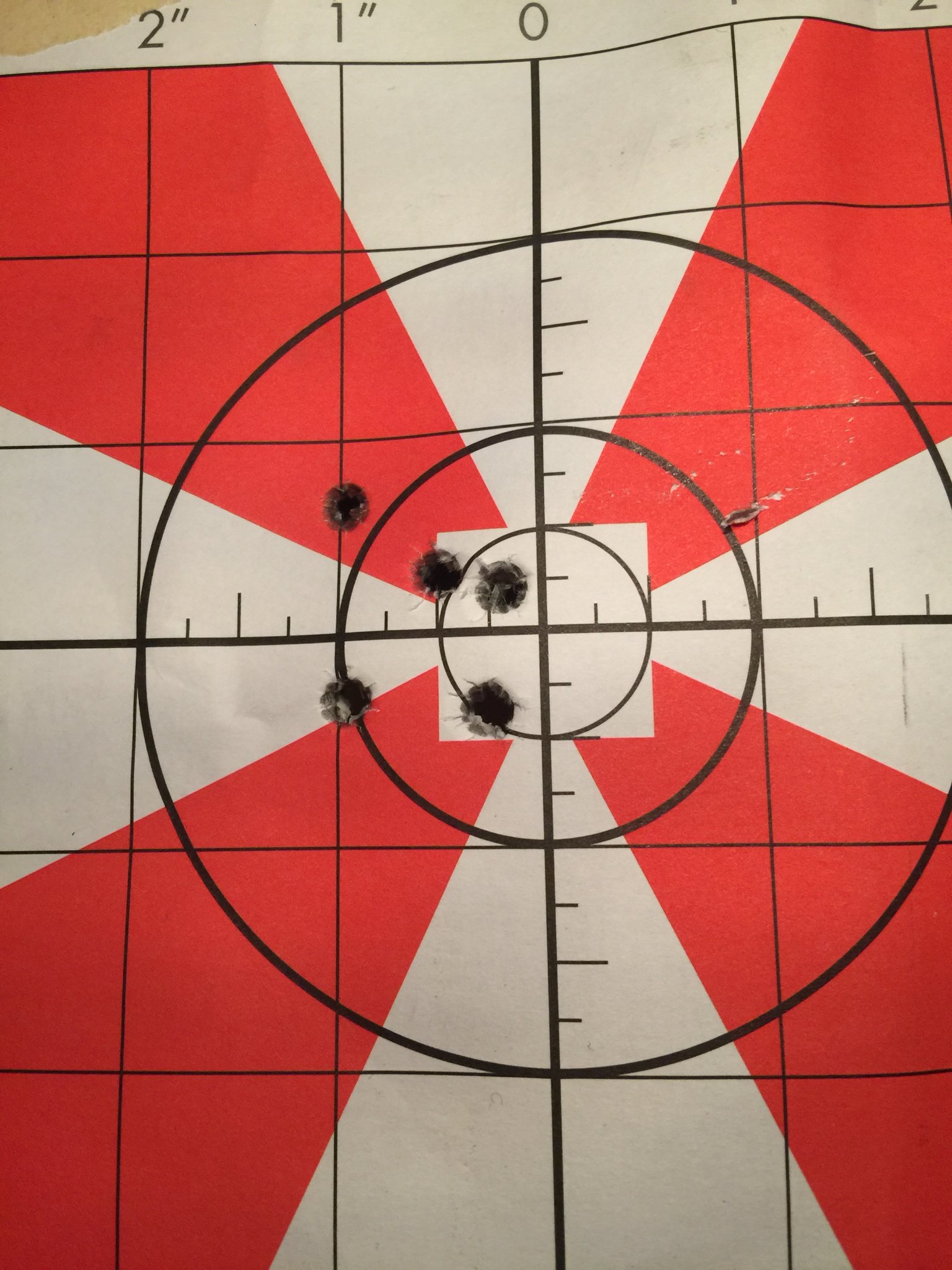

Just got back from the range after shooting a few groups with my 24" 6.5 Creedmoor LMT MWS. It's holding right around 1 MOA using Hornady 140gr American Gunner ammo. It's all I have at the current time so I'm going to run with it until I can get something else. The Chrono data I got from it was an average of 2727 FPS 92 deg F, 63% humidity and 30 in hg. I'll try and post some pics of the groups in a little bit but they are nothing to brag about. I was sweating my ass off in the heat.
Looking forward to your pics and thoughts as I am on the bubble on going with the 20" or 24' 6.5 Creedmoor barrel for the long distance option. Also emailed to see if I can get Nefarious Arms to convert a Christensen Arms CF barrel.

Nice shooting, how are you shooting (prone with a bipod and rear bag, off the bench with bags, something else)? I take it you like the 24" barrel, what was you thinking on length? I also have a question about recoil and muzzle rise. I understand the recoil is less with a 6.5 Creedmoor than the 308 so my questions are more about muzzle rise. What muzzzle device are you are using and are you able to spot your impacts?
My plan is to order a 20" barrel on Tuesday as I like the more compact length. My thinnking is that I am certainly going to spend more time carrying the rifle around than actually shooting out to or past 1000 yds for the next couple years. Also, I think that at my relatively novice level learninng to call the wind is going to be a much bigger factor in terms of hit probibility than the velosity difference between a 20" and 24" barrel. Thoughts?
