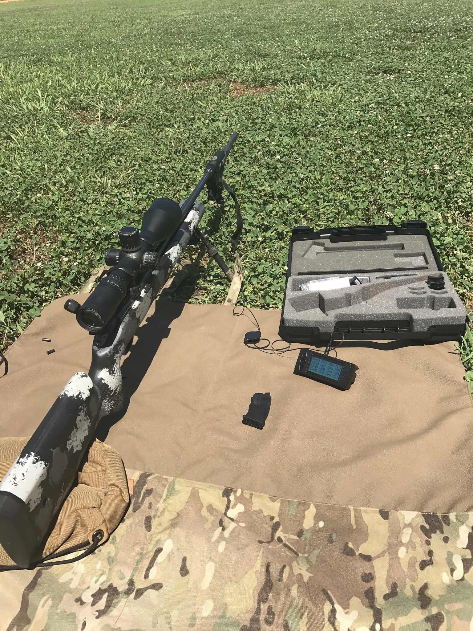

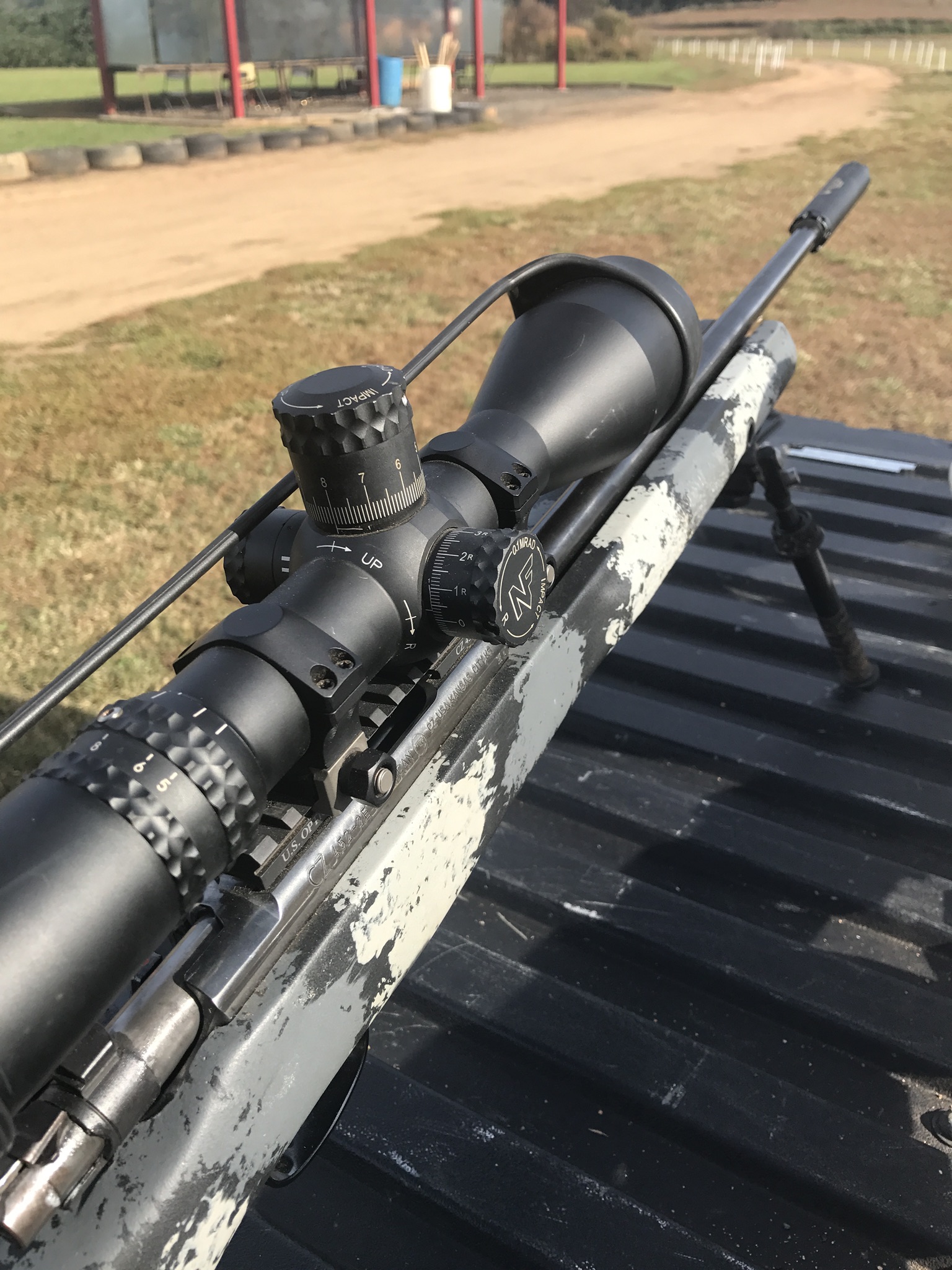

I bought a used Boyd’s tacticool for a RH 453 and modified it to fit my 452.
-1/2” forstner bit to cut the new handle recess.
-filled the RH handle recess and forend escutcheon w/putty, paint afterward.
-bedded the action.
-DIP 25 MOA rail
-Mueller 8 groove
