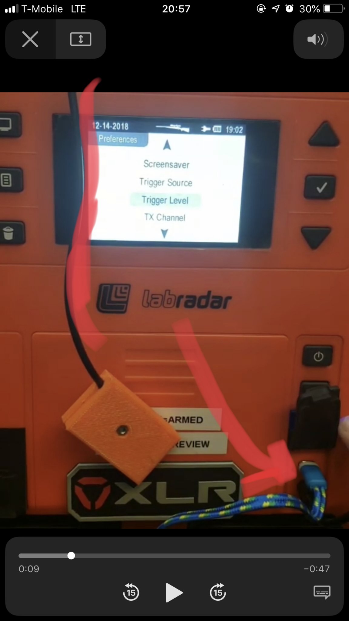

Does this plug into the USB port? If so, does that mean you can not use a USB battery pack to power the LabRadar? Mine tears through batteries, but the USB power lasts all day.
Thanks
It doesn’t. I know the video fooled me too until I traced the black wire from the sensor.
