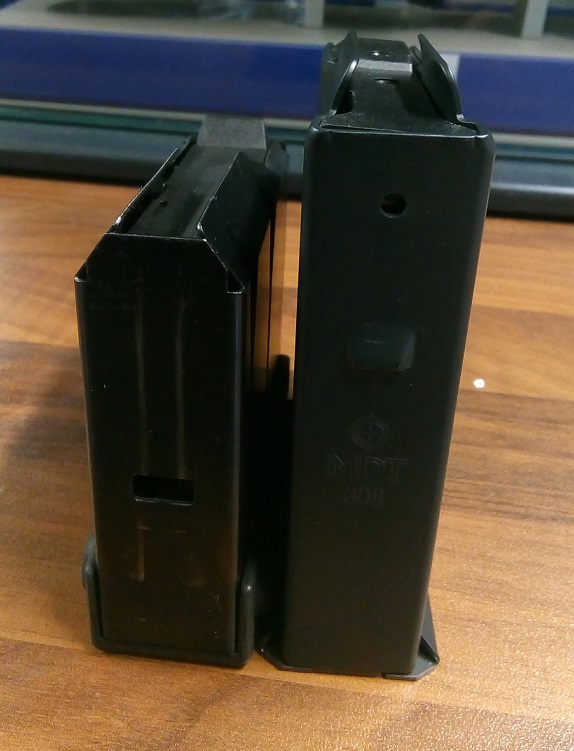

Check this out.
Size difference aint big for MDT 10-rnd AICS magazine and Tikka CTR magazine.
But take a look the material difference.
Tikka has thin steel material on the magazine, but MDT had beefy structure.
If you are competition shooter, where gear are getting quite hard beating, which one of these magazines can take competition beating? ctr-aics.jpg

Check this out.
If you are competition shooter, where gear are getting quite hard beating, which one of these magazines can take competition beating? View attachment 6941207
Exactly my point. The difference is real.

Big thing and importand thing is, that inevitably you will drop you magazine, and there will not be soft ground underneath, and that kind of thin wall magazine will bend when it drops to concrete or a rock surface.
I did get failure one of my Tikka magazine, when i used GRS Berserk stock, and i had to fix it a quitea bit with pliers, that i could make it work again.
Few times i have dropped these MDT magazine to rocky ground, and nothing happens.

That gunsmith needs to be good, who can do that.
KRG Bravo does not have bottom metal, it´s one big bottom metal down there, so im not sure how you could drop ctr bottom metal here, since the trigger guard is also one plase what connected action screws to the action.
This picture is Remington, but there are no big difference on how it looks.
The mag opening would have to be squared up as the CTR mags do not have the back to front taper that the AICS mags have. You would also have to buy the TRG mag release from KRG. Anyone that can run a mill can do it.

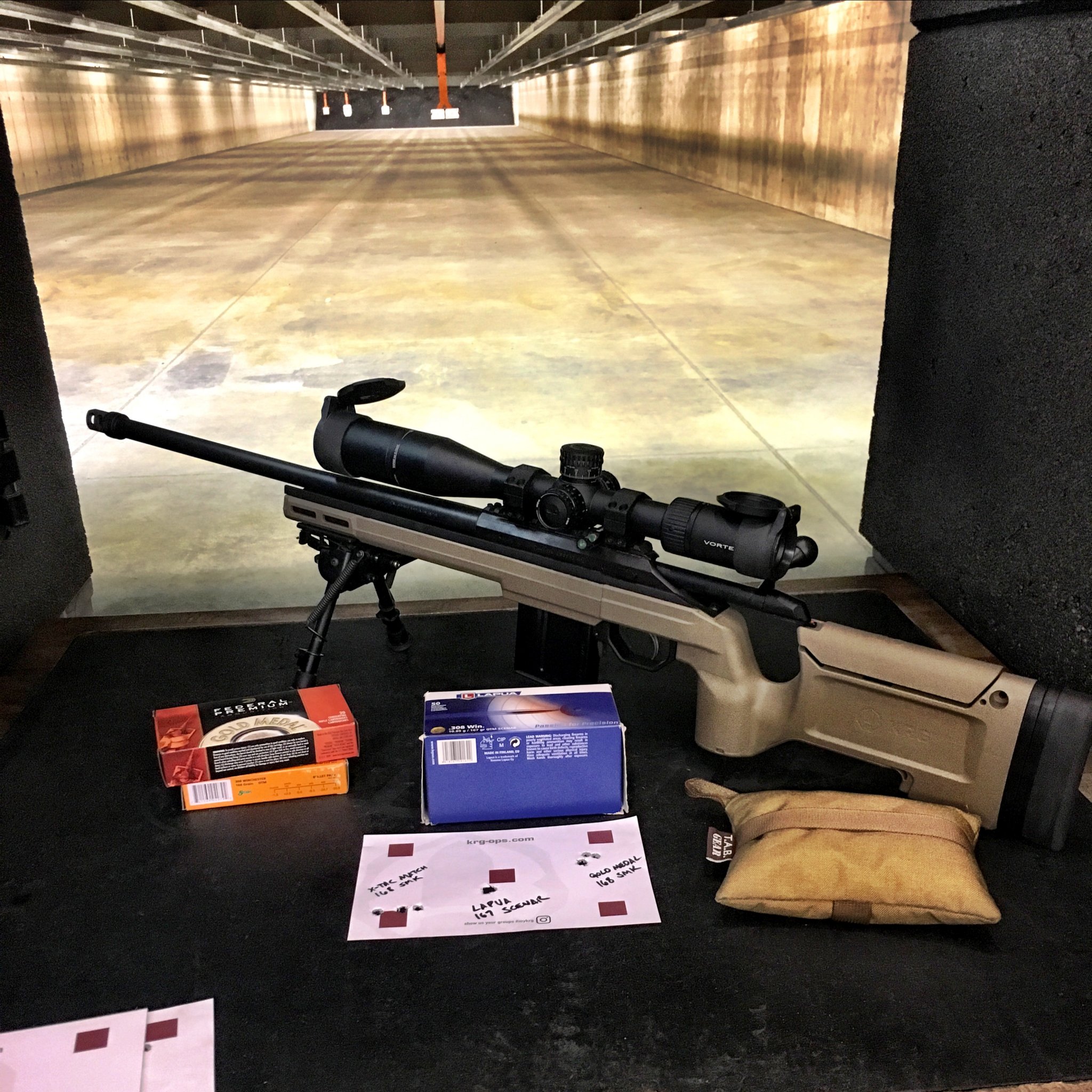

First session at the range since dropping the Tikka in the Bravo. Love the ergonomics compared to the CTR stock.
I also shot some Lapua factory loads with 167g Scenars that I recently ordered. I think the gun likes them.

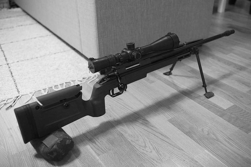

I swapt my 260rem Tikka for the KRG chassis.
Timney trigger, Kahles K624i scope, Spuhr mount, Atlas prs bipod, Tikka TAC A1 muzzle brake, Riffle stick grabbler feets, MKMachining goods in the scope.
It is about 2,2lbs lighter than same package with the MDT ESS chassis.
