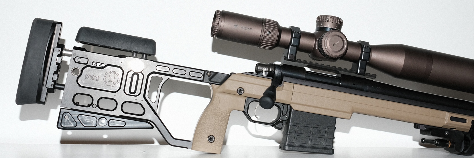

What would it look, if you add TRG folder from KRG to Bravo:sneaky:.
I just might have that money in the sock for that folder, or fixet.
I dont necessary need that folder, fixed would be great too.

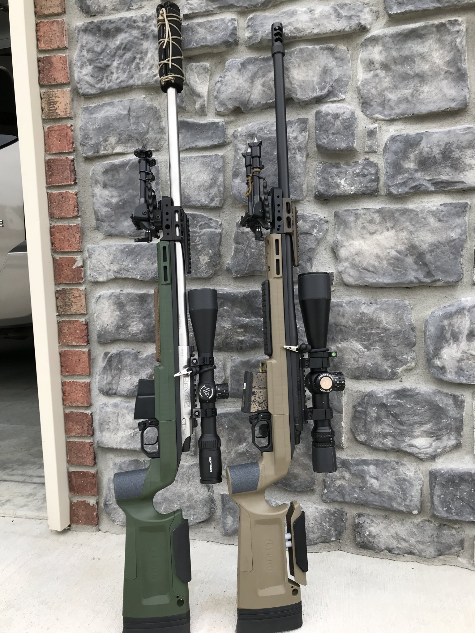

I haven’t really laid behind it or messed with it. But I tend to like shorter, for barricades and such. I sat it next to my XLR and it’s pretty much set up the exact same as far as LOP

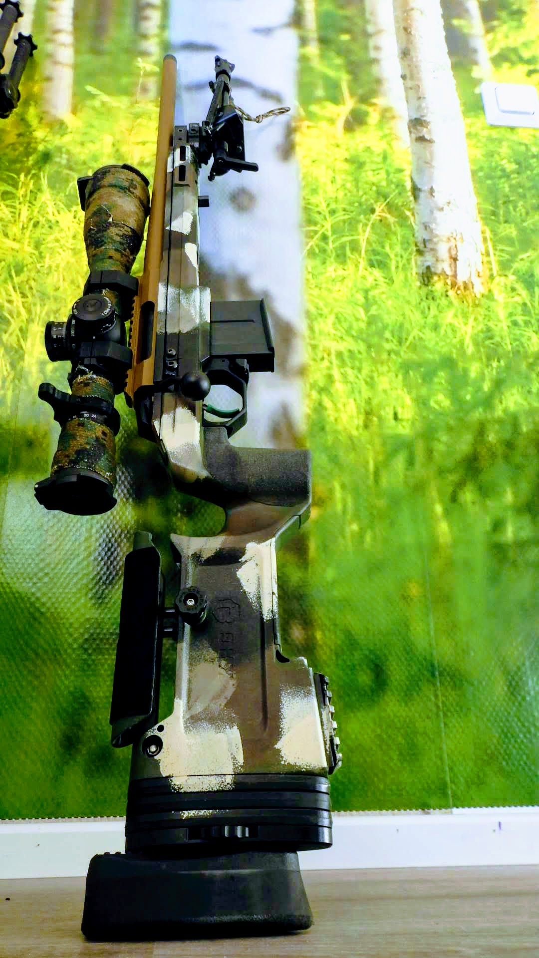

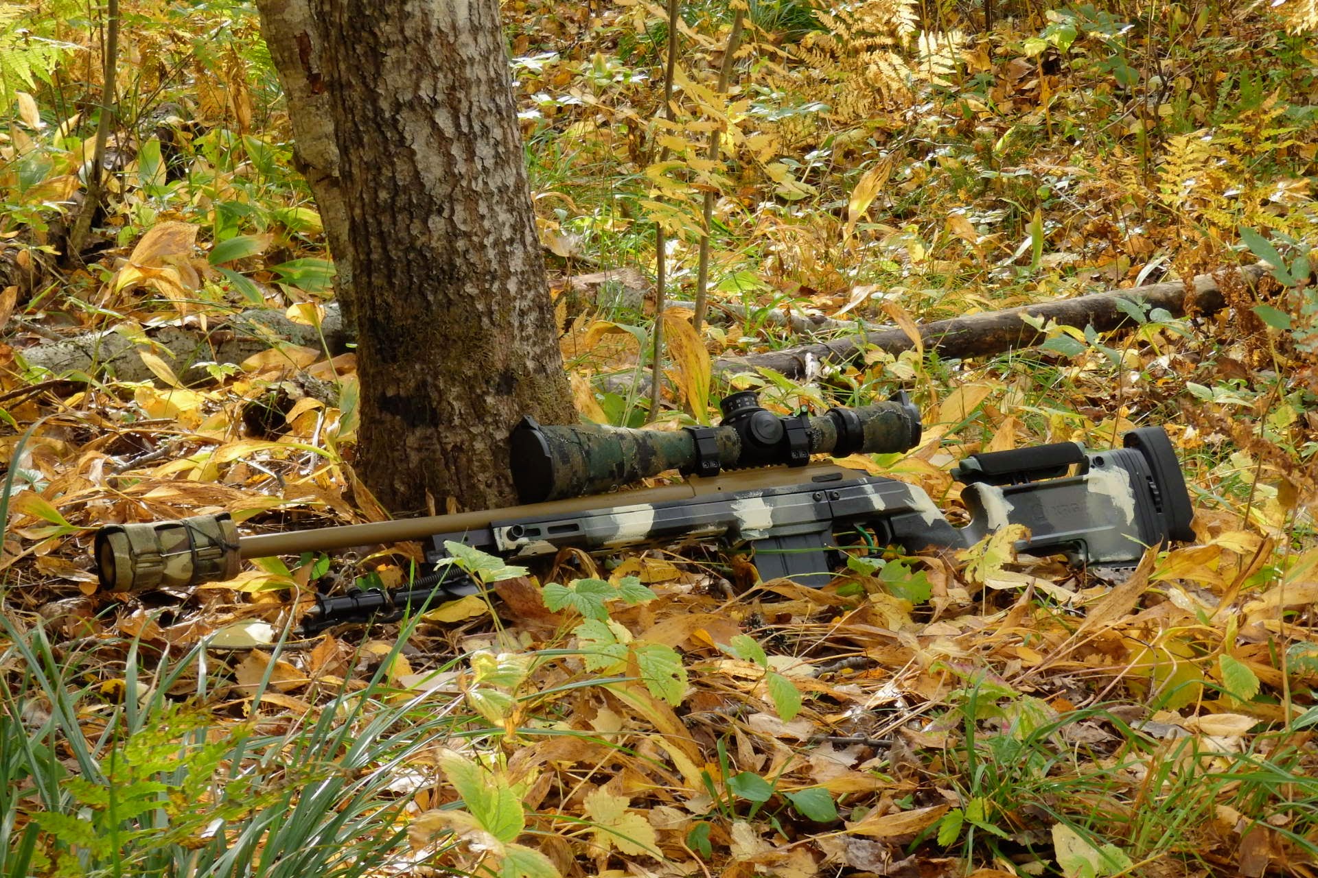

Tell me about the paint job on the bravo.
What is it and how did you do it?
Under the paint is Sako green base color.
Style how i did the paint job is simple.
Use sponge, expendable plates and good quality matte spray paint.
Use your inner artist and dab the color of the different colored plates and then to the stock.
I have done some of those old school camo painting, and those are PITA.
Too much tape work, and this style is quite good looking, they use this same style in the Manners stock painting, and there i go this idea to paint like the pro.
Most importand thing is to get good paints, matt, and be bold, you can over paint if you screw up the job.
And every one do the job like they want, there is no one way to do it, just execute your self, you will like it ;)

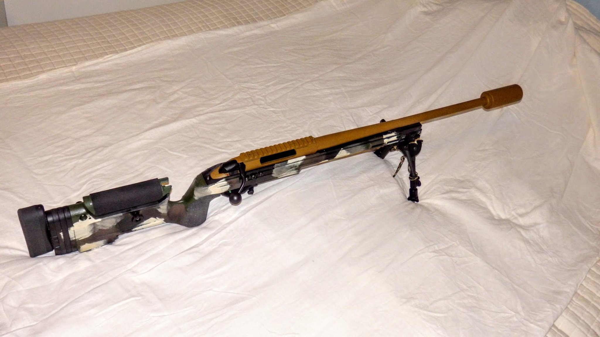

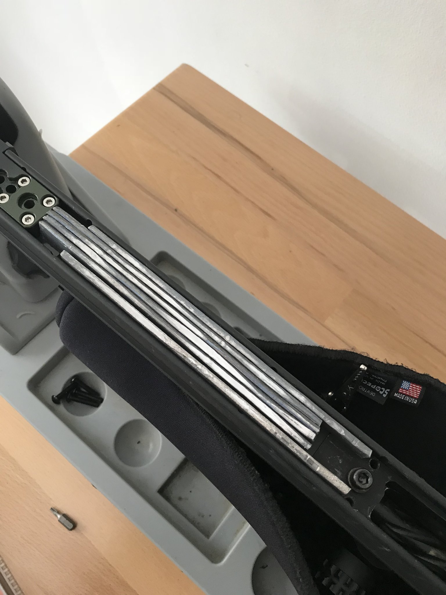

Alright gentleman, this is my final product after messing around with going back and forth for 2 weeks. Adding weight to rear, grip, and butthook, I lined the cavity with Saran Wrap and took #8 shot from shotgun shells, and covered it with excess Saran Wrap. As for the fore end, I went from adhesive wheel weights, to double sided tape and Saran wrapped #8 shot, to now and ending with lead decoy weights from academy. 3.5 oz each strip and had to trim to fit accordingly. Good thing with this lead, it’s soft enough to cut.

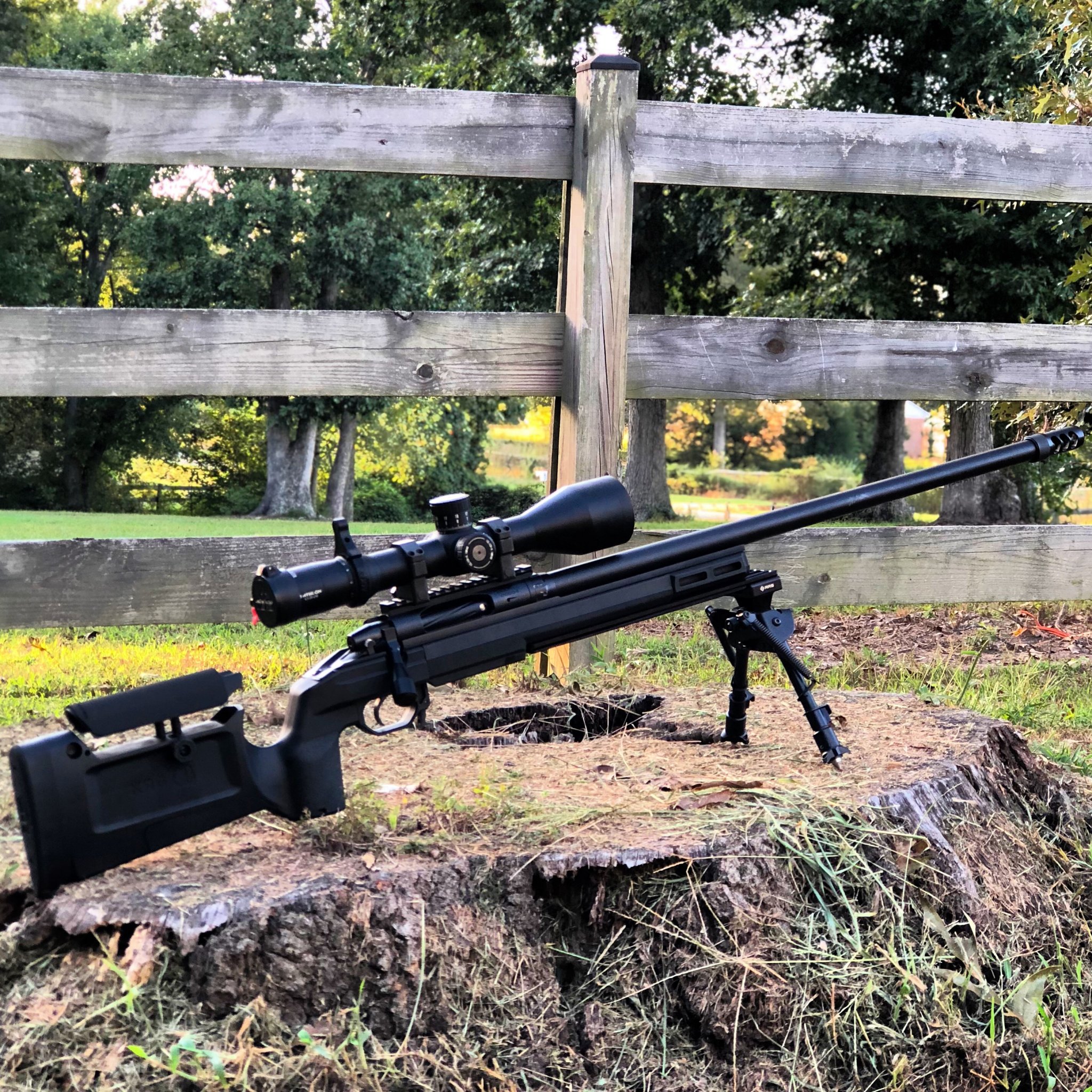

Could someone with a tikka post a pic of the cheek piece. I bought a used Bravo for a CTR and the bolt hits with the cheek piece about 1/8"-1/4" lower than I need it.

Thanks viking78. Looks like I'll get the dremel out later today. And nice rifles, also.
I think you could ask from the KRG, that could they send you the factory made cheekpad for Tikka, but it is almost the same you do it by our self.
All they do is dremmel and file them for now. New molded ones are coming sometime but for now that’s all they are doing.

The molded ones are coming in about 2 months roughly. For now we take the standard cheekpiece and cut it on the mill.
To reiterate, the standard cheekpiece does keep the bolt from traveling all the way to rear at some heights. However, this is due to Tikka putting long action bolt stops in short action calibers in most instances that we've seen.
You don't actually need the bolt to travel all that way rearward when you have a short action caliber (i.e. anything feeding from a regular AICS .308 size mag). With the correct bolt stop, the cocking indicator alone will still hit the cheekpiece but at a pretty narrow range of cheek heights which are higher than the typical shooter will use.

Thanks for the info guys. I have a set of Warne low rings that would lower the scope maybe 1/8", which would probably let me lower the cheek piece enough for it to clear. I chose to use a set of Vortex precision matched rings that are just a little higher because it is easier to remove the scope. Getting enough clearance looks like SN easy job with a dremel and file.

That is one way to limit the bolt movement, but it will cost, cheapest is 40$.
https://tikkaperformance.com/index.php?_route_=tikka-bolt-stop
Original Tikka T3 short action bolt stop you may find in the Brownells.
https://www.brownells.com/rifle-parts/bolt-parts/bolt-catch-parts/bolt-catches/tikka-t3-bolt-stop-kit-long-and-short-action--prod31611.aspx

I'd like to give a big thank you to the folks ar KRG. I emailed them about the cheek piece for a Tikka Bravo. The next morning I had a response. Today I received an order from them that I placed the same day as the email. To my surprise, there was a new cheek piece in the box. Can't ask for better customer service than that.

Skateboard tape on grip I purchased from my local bicycle shop. they sold it in 12"x12" sheets and it was cheap for as much as I got. foam with adhesive in riser. the link where I purchased it from.. https://holsterops.com/products/cheek-pad-for-rogers-super-stock I purchased 4 of them bc I knew shipping would be a little bit, I think $8.
