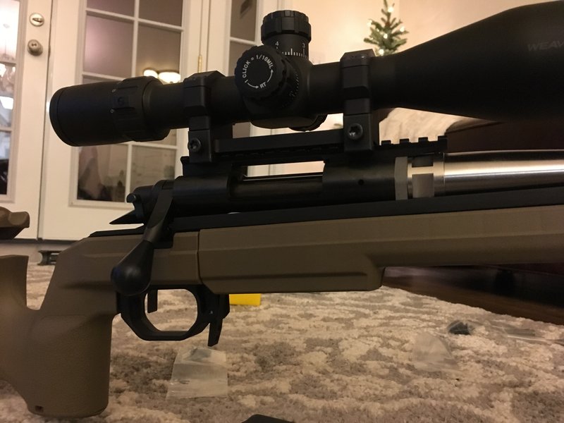

Wish I would have known the recoil lug pocket was gonna be undersized... it definitely won’t work with a .250 tapered PTG lug
It's not undersized if it fits a standard Remington lug.

Maybe he’’ is like me and thinks the Bravo looks better than the Xray. Or like me and others prefers a traditional MCM/MCS shaped stock. Besides that, its much less money compared to an Xray.
I’d like to see a 455 Bravo personally as right now I’d have to get a Tacticool to do it for me. For $150 more dollars I’d gladly get the Bravo.

There is nothing wrong with it but I’m getting a bravo stock for my center fire rifle so I would like the same stock for my rimfire trainer.
I understand, but I doubt they'll make the Bravo for the 455. They should be so close in feel that I don't think you'll go wrong with the 180-xray
