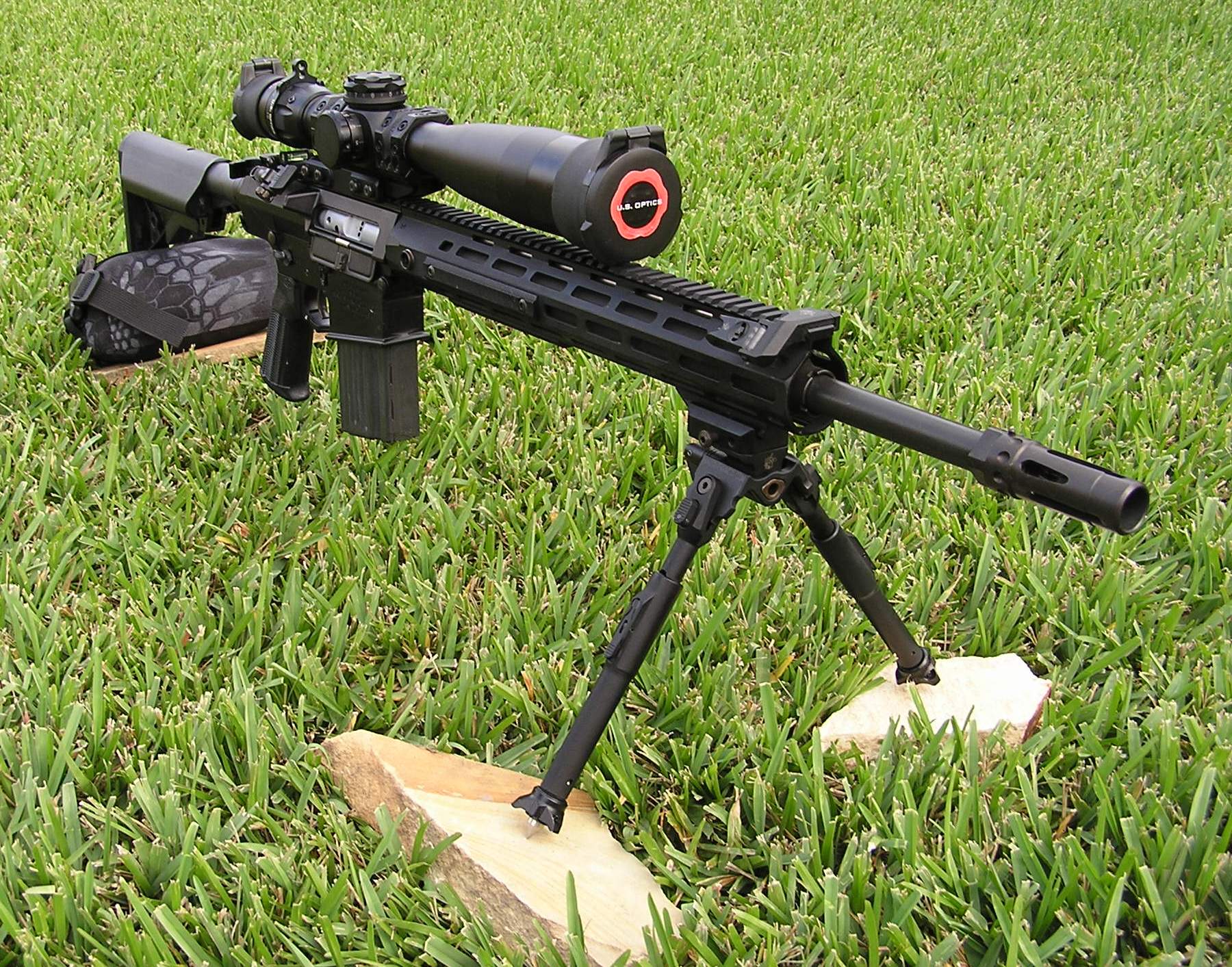

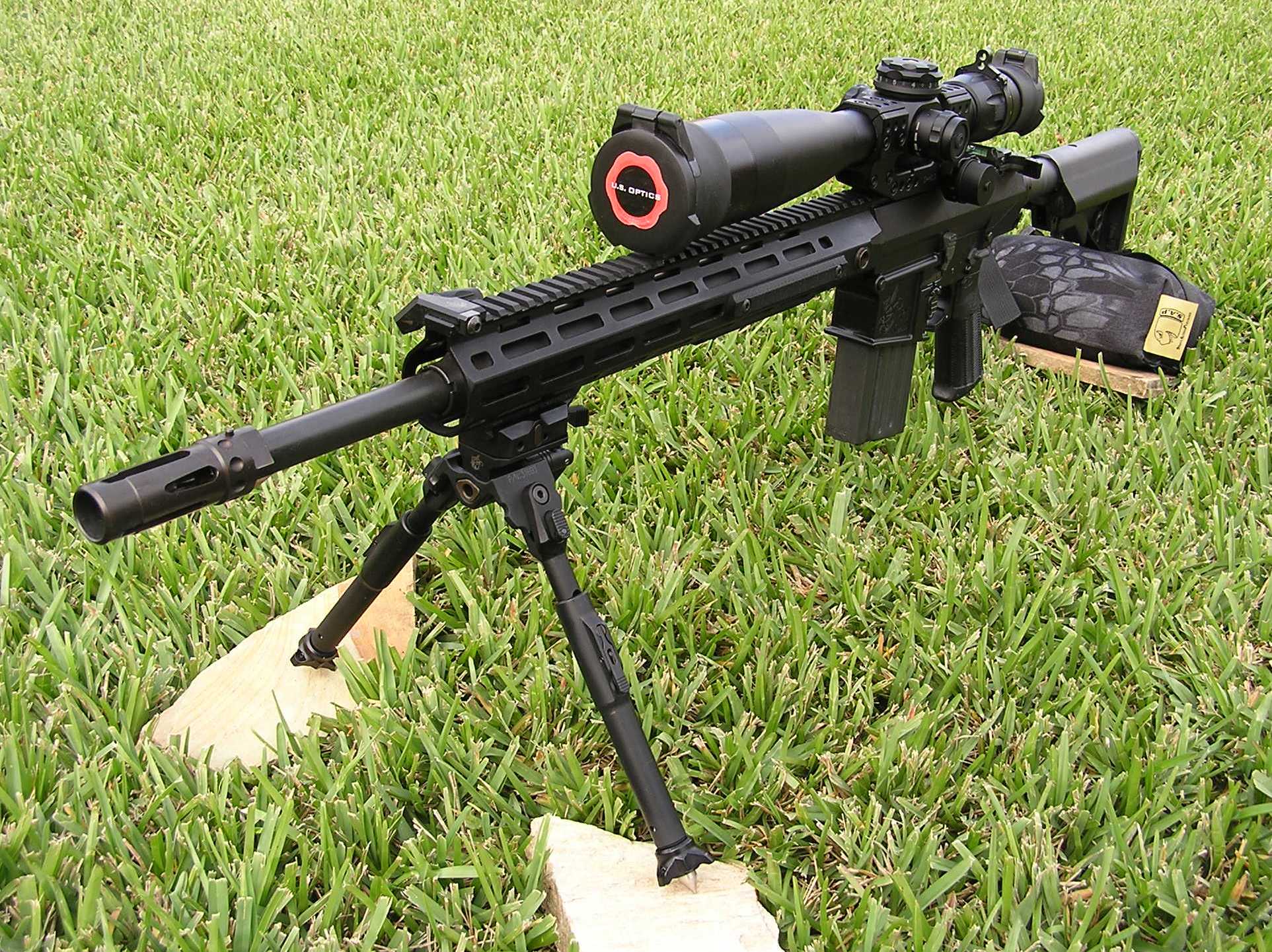

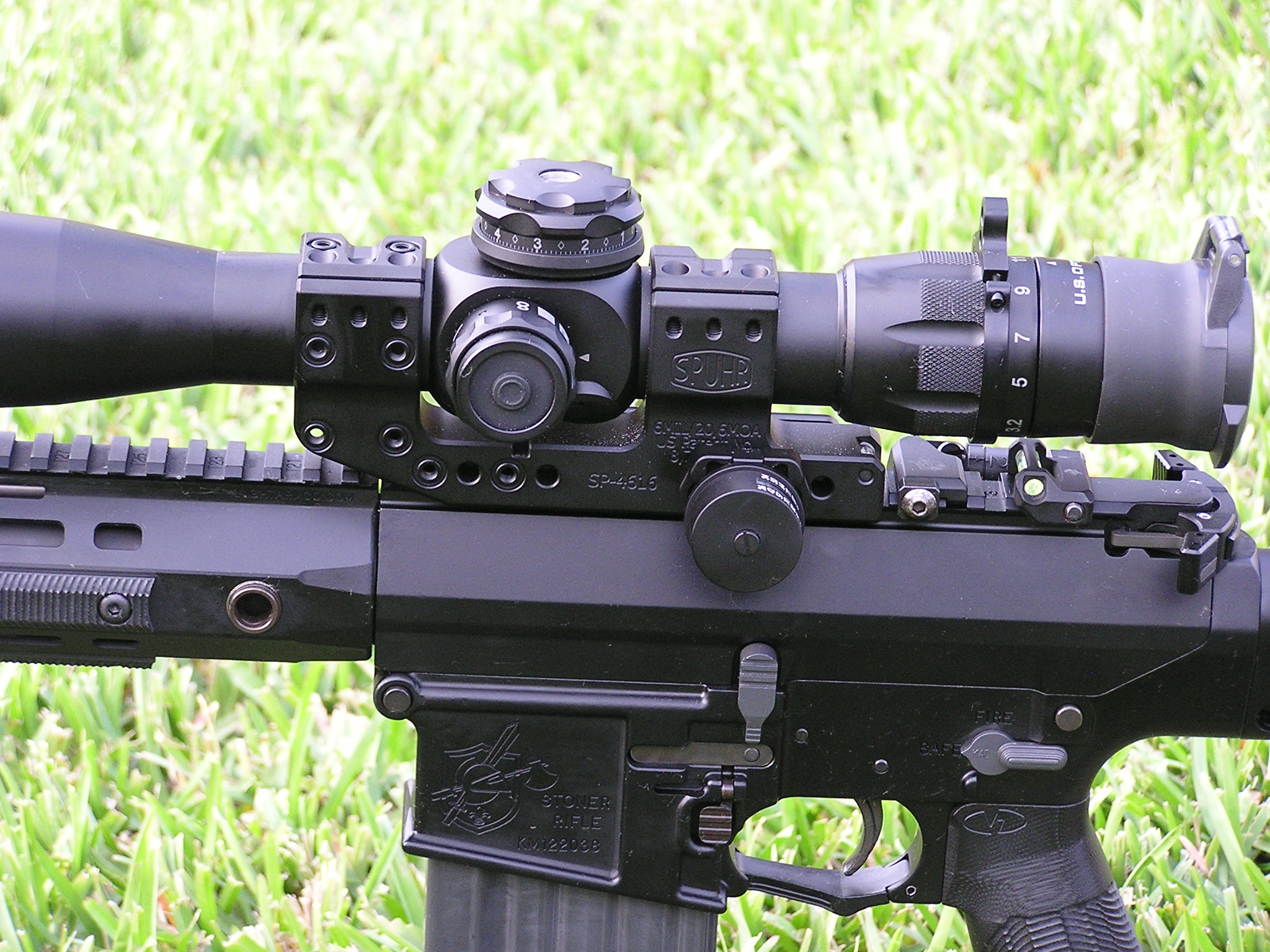

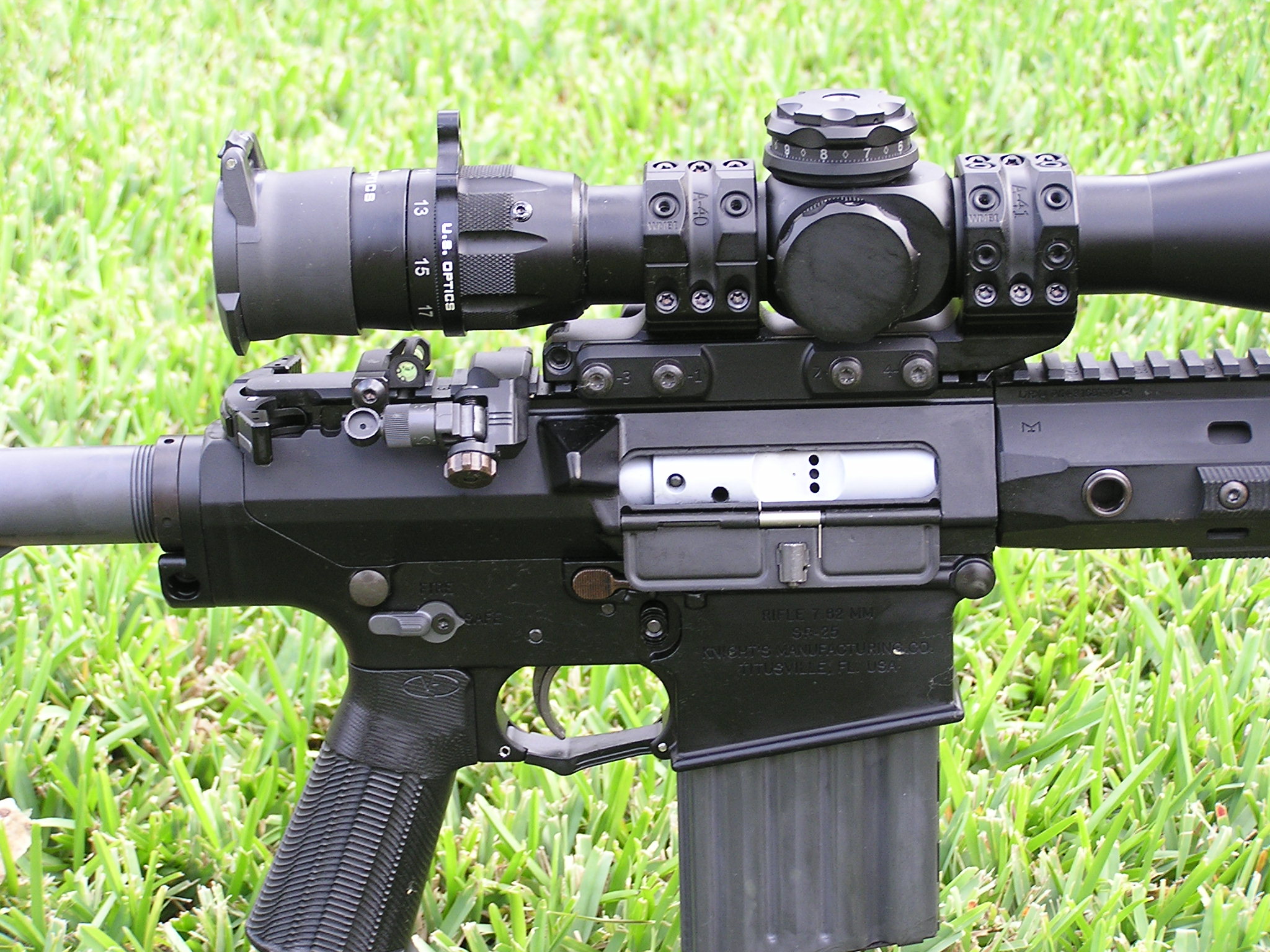

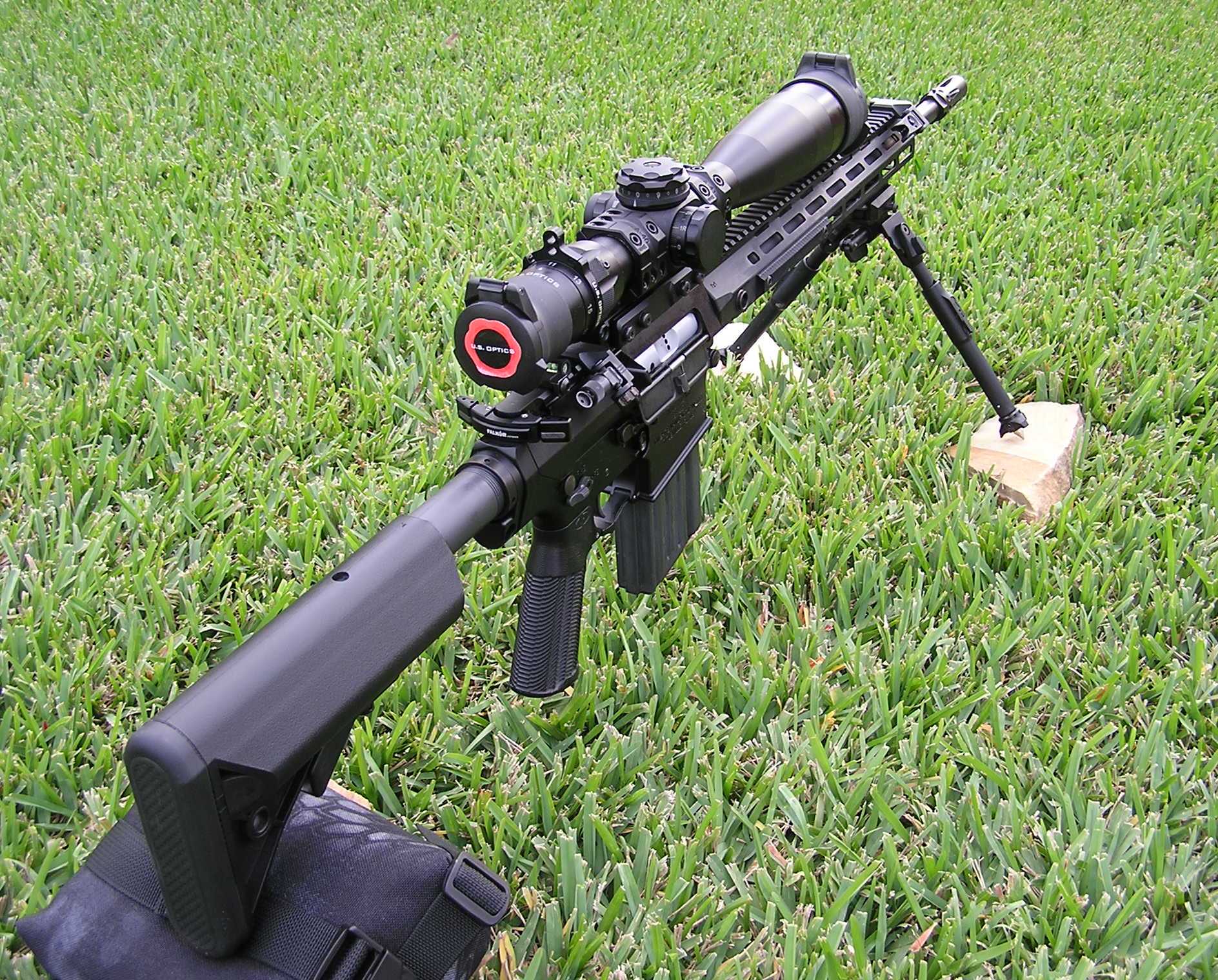

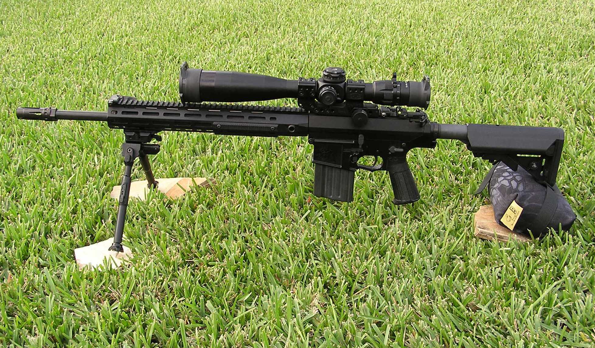

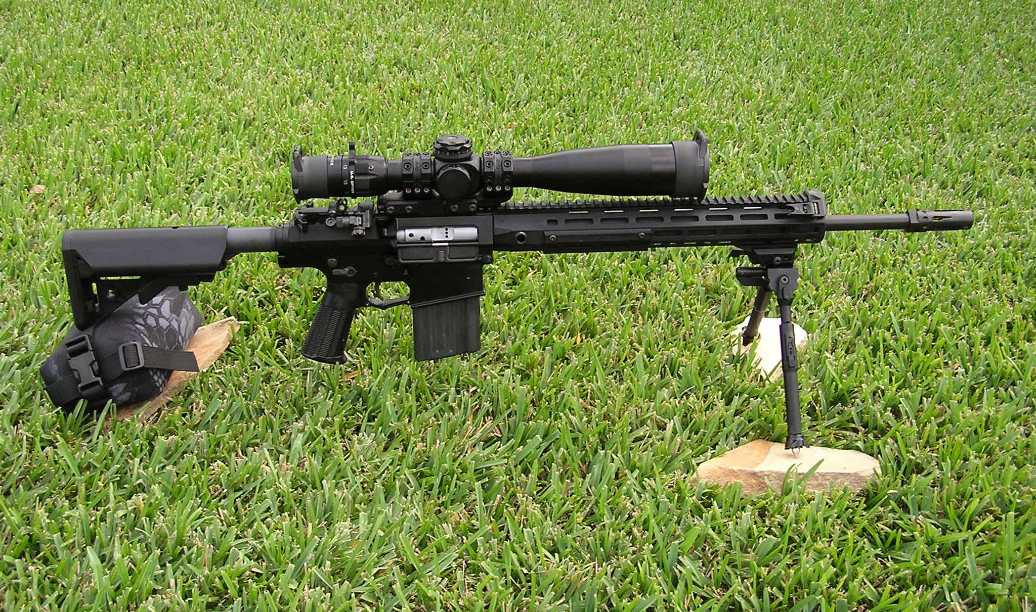

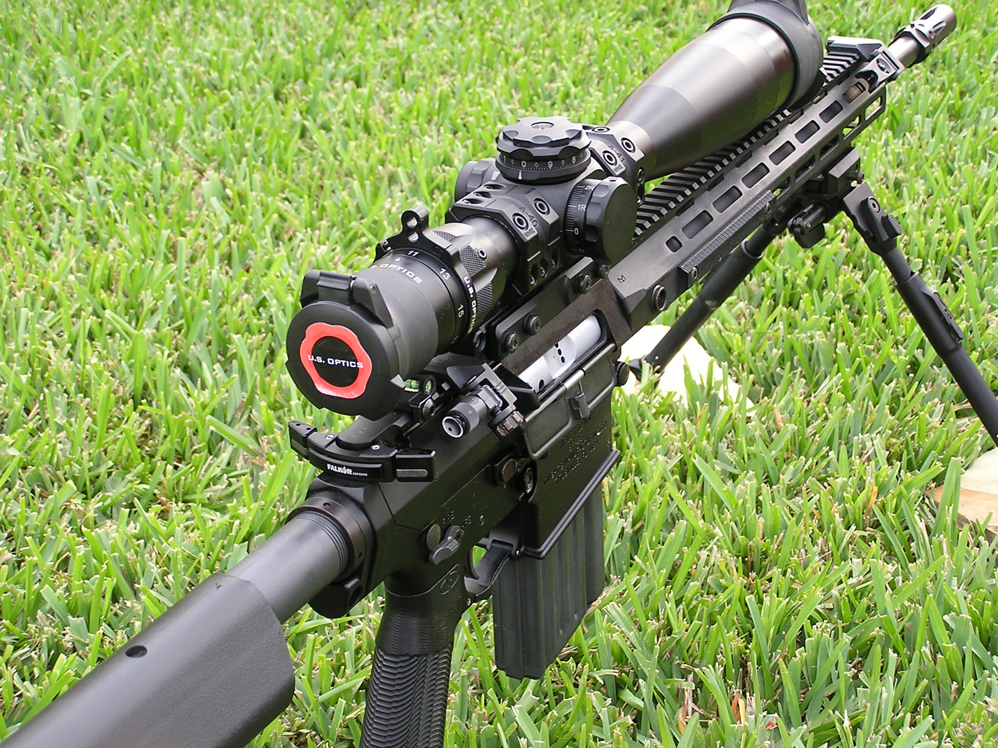

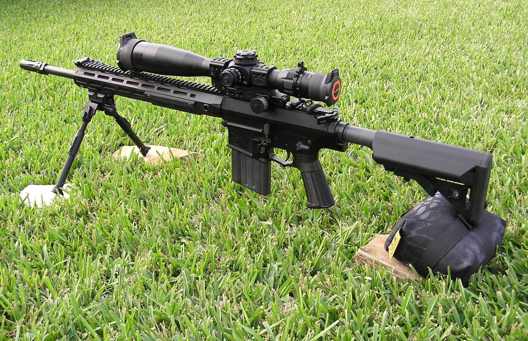

I sent some pictures of the rifle to Spuhr and thanked them for their help in recommending the 4603B mount for the USO scope. I received a response from Spuhr and was informed that they actually do have a cantilever mount that would work with my scope. Apparently there was some confusion when I first reached out to them which led me down the 4603B path.

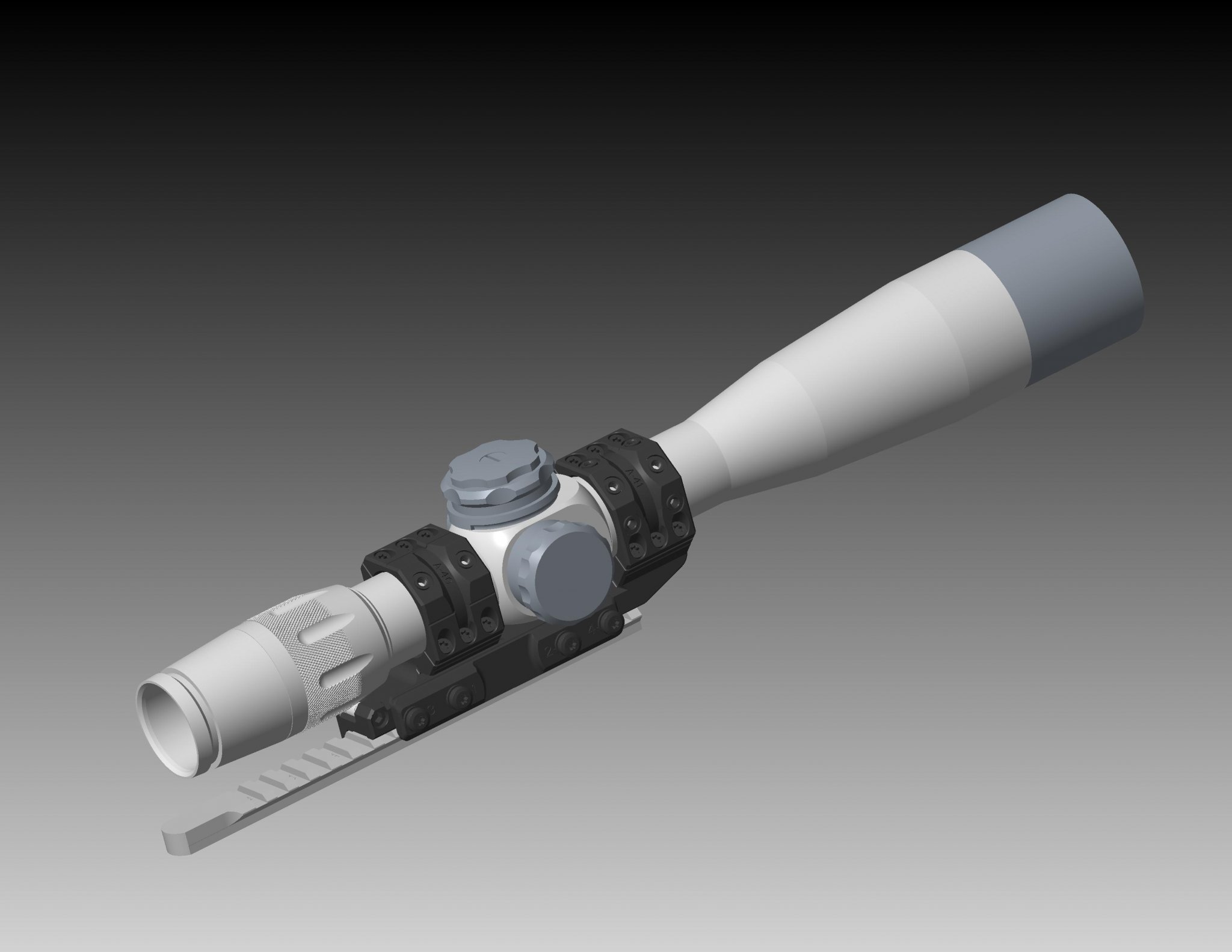

Spuhr has informed me of the SP-4616 cantilever mount and sent me the technical information on it. I purchased the mount and have installed it and it is exactly what I was looking for originally. With this new mount I am able to get to the charging handle easier and could probably go back to the KAC charging handle but I like the FALKOR so I will leave it. If anyone is interested in a barely used Spuhr 4603B, let me know. I have also attached a JPG of the 3D CAD model I created of the mount and the scope. I have reversed engineered them and they are accurate. If the CAD models would help you, let me know and I can send them as STEP files or other depending on your CAD platform.

I went with the 4616 because I wanted to maximize the rifle and scope for long range, 1000 yards, so I wanted a 6 MIL/20.6 MOA mount whereas the 4016 is a 0 MIL/0 MOA mount. That's what was recommended and it made sense to me. I did consider the QDP but decided against it. I purchased the Fix-It sticks for the Spuhr mount so I can torque it to the correct values without having to carry a torque wrench if and when I do remove it.

But be careful if you level your scope to your body position and not the receiver. Otherwise its worthless as its bolted onto your rail.
Thank you. What I did was take my machinist level and ensured the rail was level and then verified the KAC anti-cant device was level as well as the level in the eyepiece of the USO scope. All three matched. There is a level in the end of the Spuhr mount but it is hard to see which is why I purchased the KAC device. The eyepiece level in the scope is also difficult to make out unless there is good lighting.
