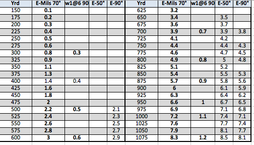

Adding to that.
You do not need DA cards coming out your butt either. With the same logic as above, you generally can find out the actual elevation or station pressure well before you get in your car or plane for your destination, be it a range or match. Same for expected temps, with that you can pre print a single easy to read card and have very good success even at matches. But if I was hunting the mountains and had no idea where I might really end up after I left the house, the Kestrel is really important.
In the same relative location (other than a hurricane), you'll find that station pressure never really changes day to day much less through the year to effect shots at most PRS ranges. Temp also had a wider window than people think, especial 600 yards and in.
So another vote for not needing a Kestrel.. But they are very good learning tool and can provide near click accurate results without the planning.
Below is an example of a "rifle mounted dope card" I use one like this year round at my local club matches with great results..
This has a huge 40° temp swing and you can see just how little the dope changes <600
