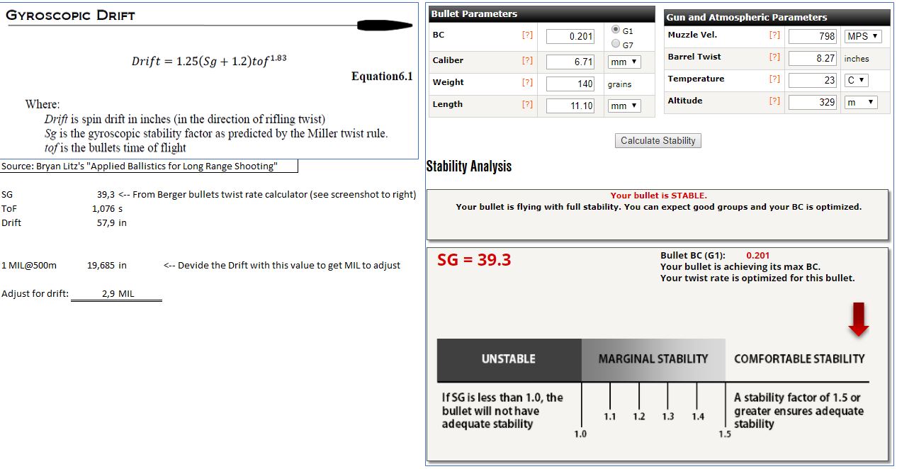

OK. I have now made the drift calculation myself (see attached picture), and it yield a drift of 2,9MIL, when using the parameters stated above.
I am pretty sure of the BC, Caliber, Weight, MV, Barrel twist and temp, so I tried to vary the altitude and bullet length.
Changing the altitude doesn't change the SG and hereby the drift much, but changing the bullet length does!
I think its the 11.10mm bullet length automatically calculated by the Kestrel that is the problem. When I change it manually to 32.79mm (which is the actual length of the Lapua Naturalis bullet according to JBM ballistics "Bullet length list"), the spin drift is reduced to 0.19 L MIL!
The questions are now:
Am I right?
Is it the actual bullet length I should physically measure with a caliper, and feed into the Kestrel?
Why is the Kestrel automatically calculating the bullet to be 11.10mm long?!

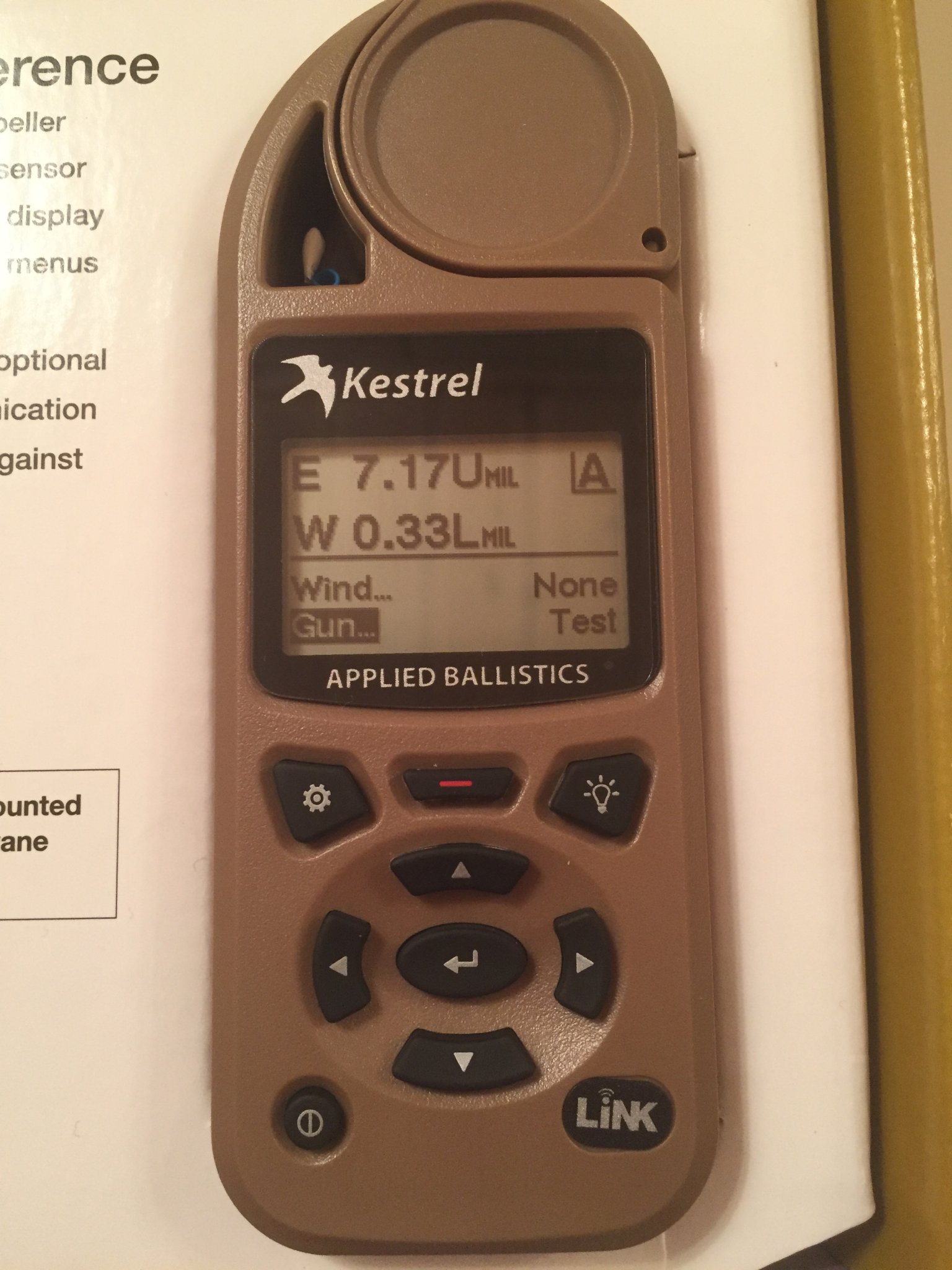

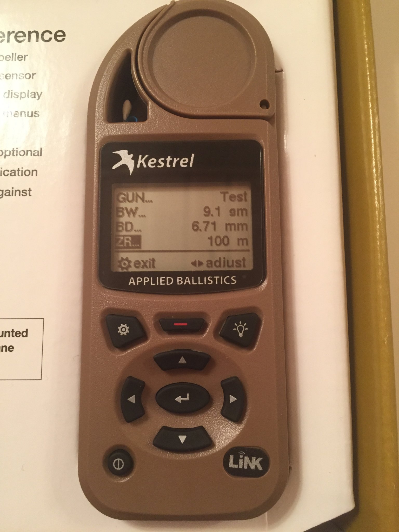

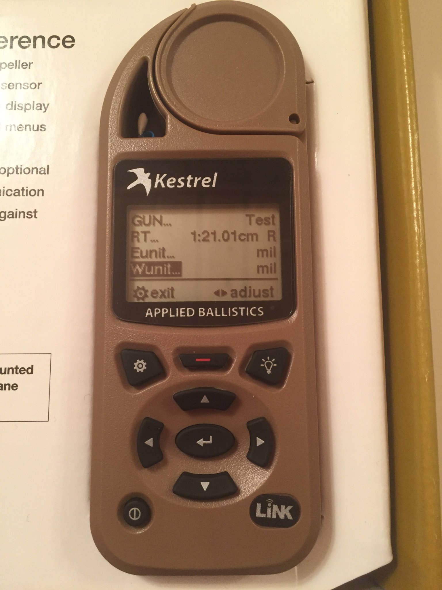

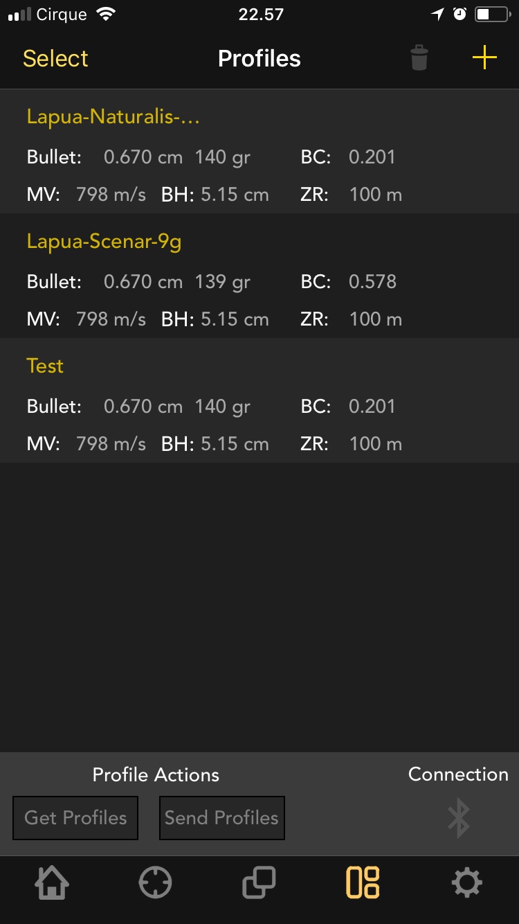

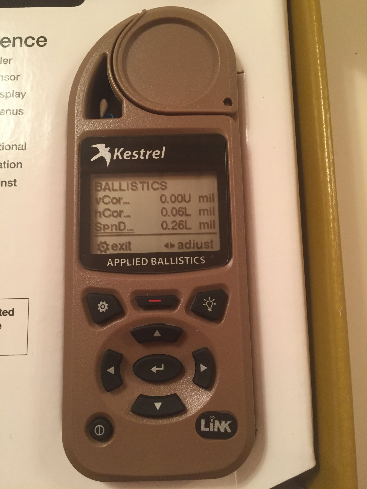

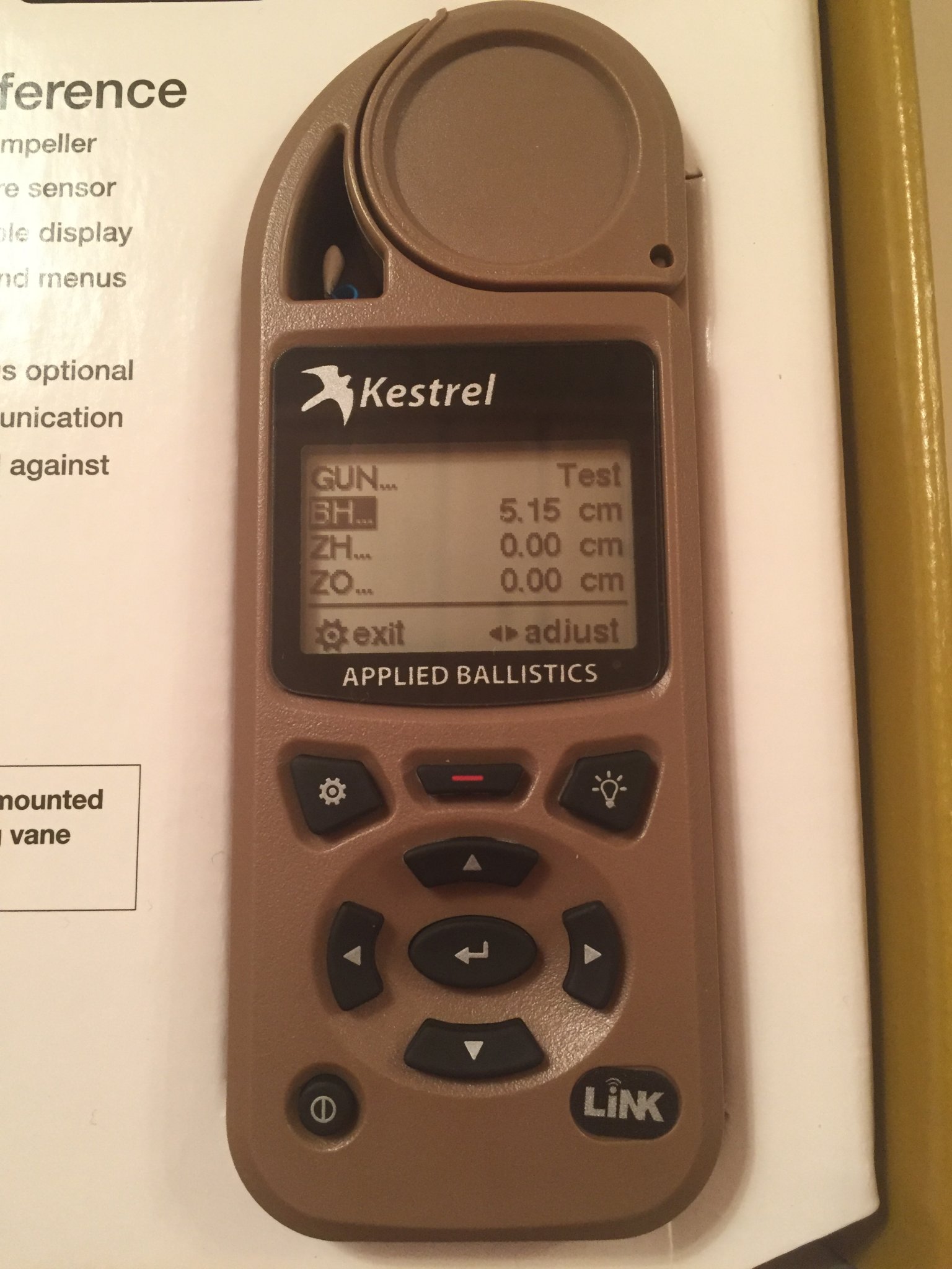

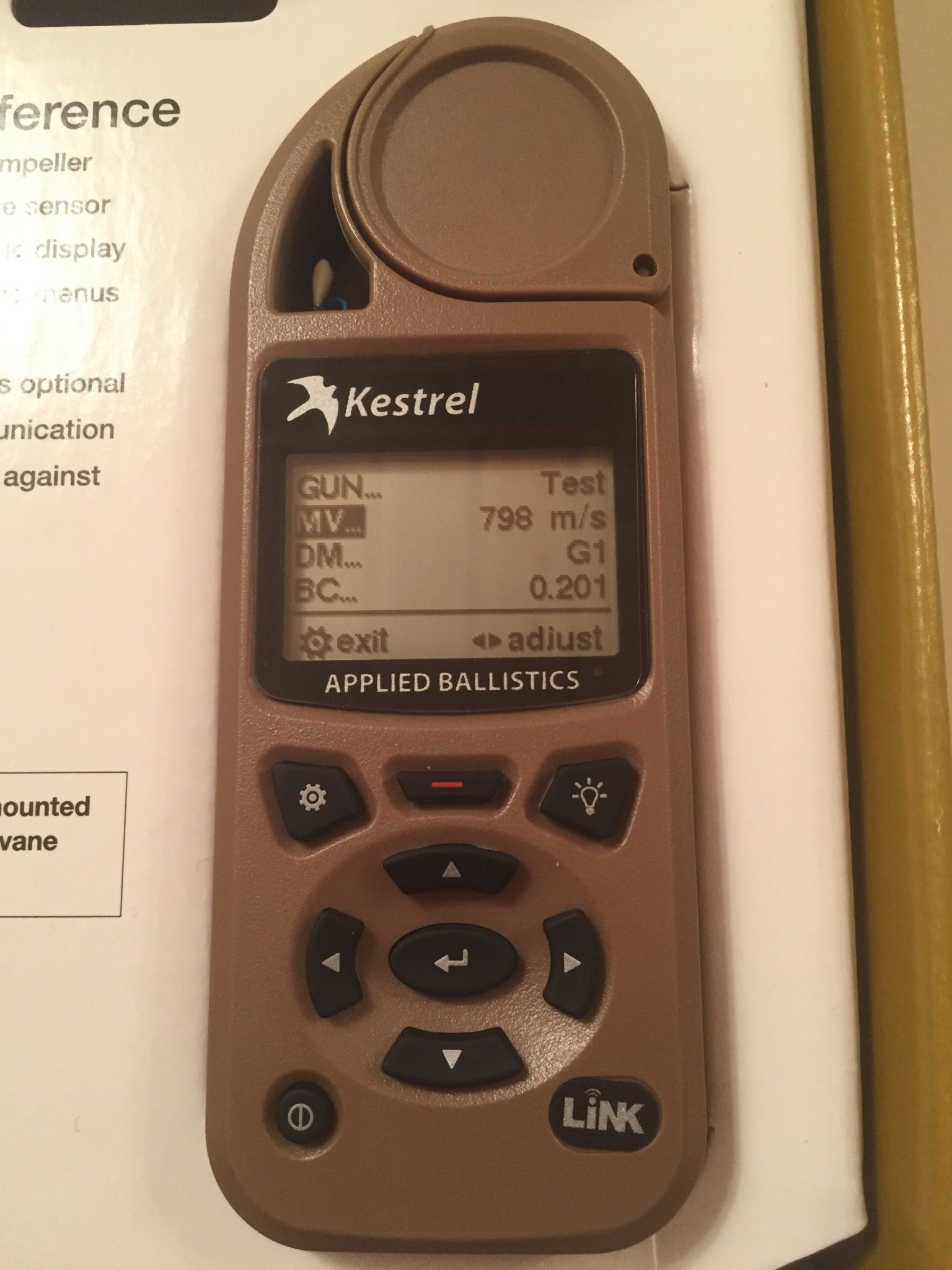

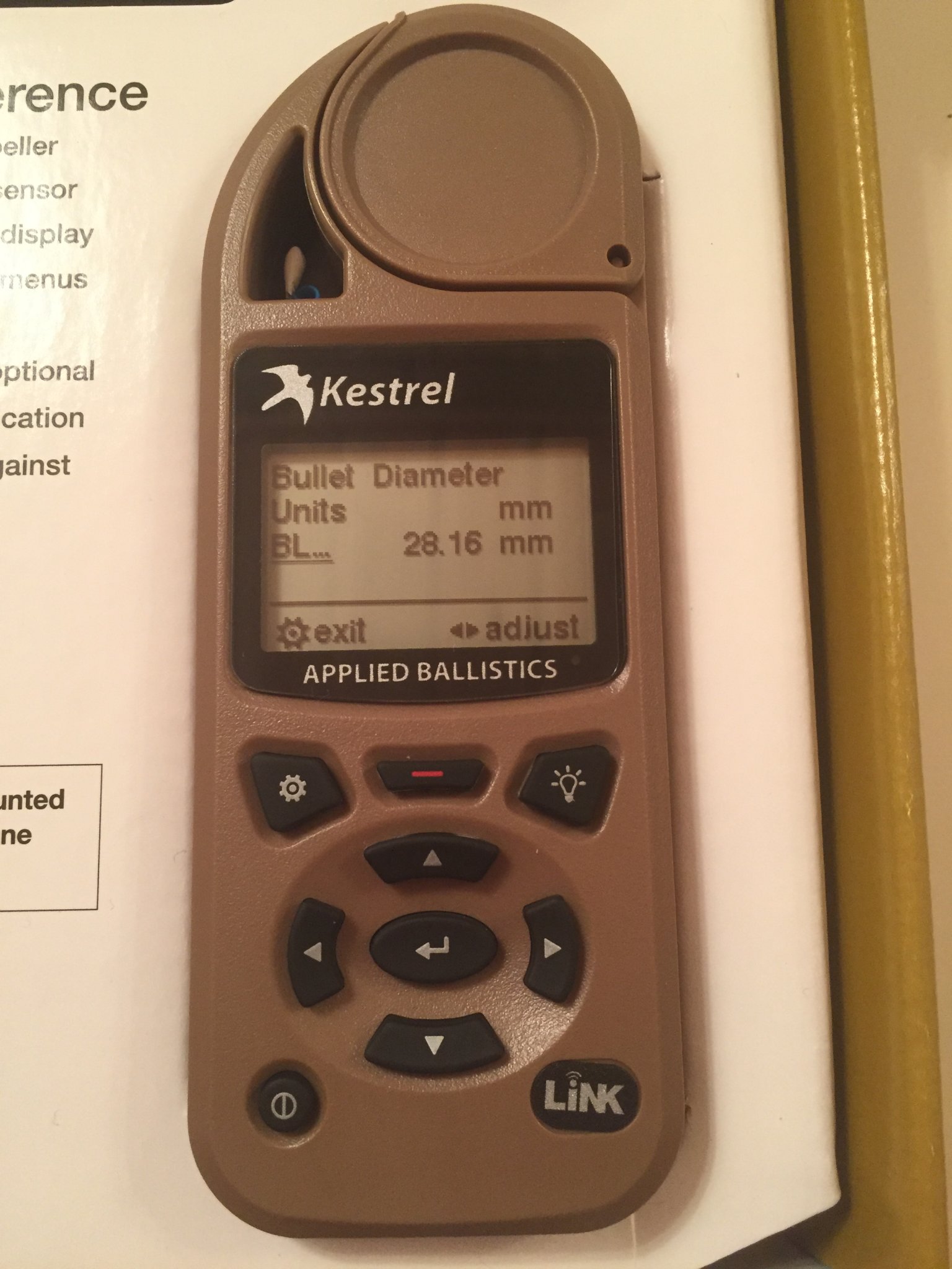

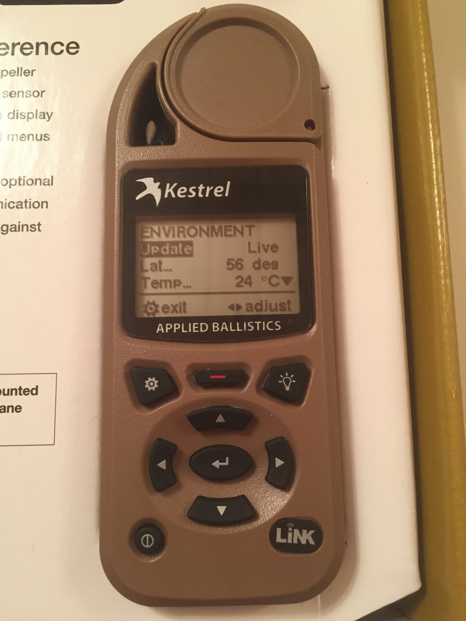

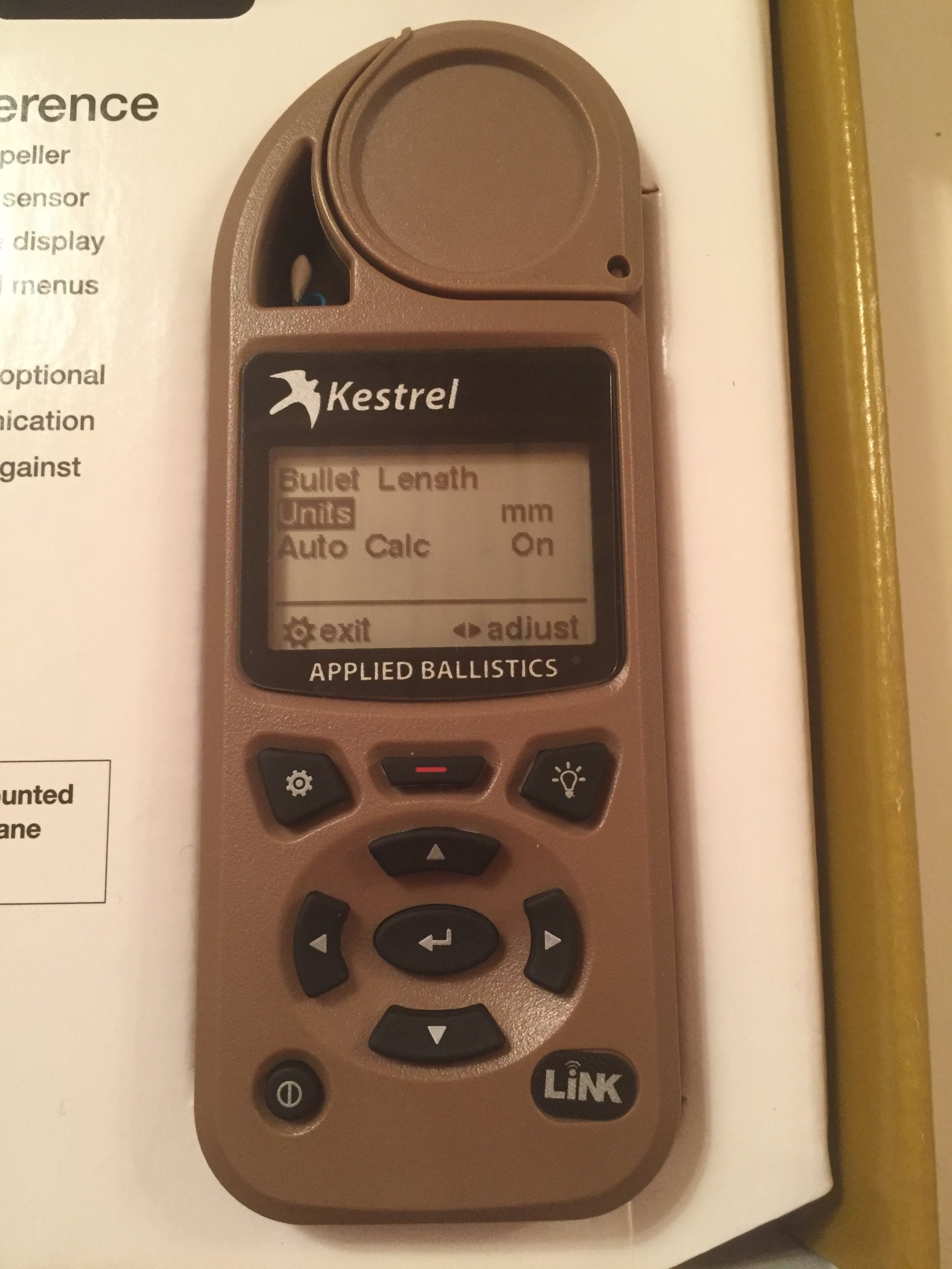

Hi Kestrel Ballistics,
the gun profiles I have uploaded is shown in the screenshot below - do you see any entry error? - it is not possible to enter the bullet length in the app, only directly in the Kestrel.
I have transferred the "Test" gun to the Kestrel, as you suggest, and now it looks like this (at SP: 1007.5 mb, RH:34% and Dalt: 435m):
IMG-5156.JPGIMG-5157.JPGIMG-5158.JPGIMG-5159.JPGIMG-5160.JPGIMG-5161.JPGIMG-5162.JPGIMG-5163.JPGIMG-5164.JPG
Does that seem right to you? I guess you have other environmentals, than I currently have, so it seem plausible since it is not way off to what you are getting - right?
I believe the wrong bullet length that was automatically calculated by the Kestrel for the Naturalis profile was just a glitch, since it is now calculated to a more correct value of 28.16mm (even though it is not equal to the actual measured bullet length of 32.79mm).
What is best length to use. The value calculated automatically by the Kestrel, or the actual measured bullet length from tip to end as a manual input?
Thank you for the support.
NB: After having imported the "Test" gun, I did turn the Kestrel from manual bullet length calculation to automatic, before it arrived at 28.16mm, so maybe that is what did the trick.

Dennis - I have gone through several tests trying to duplicate the issue you saw with bullet length but was not able to do it.
If any users out there have had similar issues and can help us duplicate the steps to reproduce, we will certainly fix this.
One other note, there is a setting in the Kestrel LiNK Ballistics app that called Bullet Length Auto Calculate. You can set this to NO and then in the profile you will have the option to enter the bullet length manually. So you don't always have to enter this on the Kestrel itself. Click on the menu icon in the top right and go to Settings and you should be able to change this item for the future.
Reactions: DennisT
Thanks for the tip regarding turning off automatic bullet length calculation in the Kestrel app - that is good that I don't have to manually correct it every time the gun profiles are renewed on the Kestrel.
When I turned off the auto calc. in the app, then the bullet automatically calculated lengths showed for the 3 gun profiles I have created. Common for the profiles was, that the bullet length was "1.110 cm" (before I changed them to the right value) - considering that I have transferred the gun profiles from the app, and not created a profile directly on the Kestrel, I guess that the App has introduced the error.
When creating a Profile, I have not selected a bullet from the bullet library, but done manual input. That should be possible for you to duplicate, right?
Fresh installation of the Kestrel app (here BL Auto Calculate is set to ON) --> Set all settings to Metric --> New profile --> Input data manually (0.67cm, 140gr, 0.201G1, 798m/s, 100m, 5.15cm, 0.00cm, 0.00cm, 21.00cm-R, mil, mil, leave blank) --> Transfer data to Kestrel --> Set auto cal to OFF both in the App and in the Kestrel, and see what bullet lenght is shown. When doing this, 1.110cm should show, since that is exactly what I have done.

DennisT - Are you using Android or iOS?
Kestrel Ballistics
Commercial Supporter
Belligerents
Feb 2, 2018
456
340
69
Boothwyn PA
kestrelinstruments.com
Nevermind. It looks like it is an iOS app issue as I was able to duplicate it with iOS, just not Android. We will look into fixing. Thanks for your help in identifying this. 2.817 cm = 1.1 inches. So it looks like there is a conversion issue there where it is pulling imperial value but using metric units.

I think this is an issue with "BL Auto Calculating" and with conversion between metric and english units.
But I don't know if the Kestrel or the app is doing wrong...

Downloaded new firmware. Selected bullet length auto calculate and then selected Berger 140 Target Hybrid with G7. Turned off auto select to see what bullet length it pulled in...1.240 vs 1.407 on Berger website !

FW 1.37 did not fix the bullet length issue with iOS devices. We have an app update coming out to fix this. In the meantime, if you turn off Auto Calculate bullet length in the KLB app for iOS, this should load the correct bullet length until we can release the app update fix (which should be out this week hopefully).
