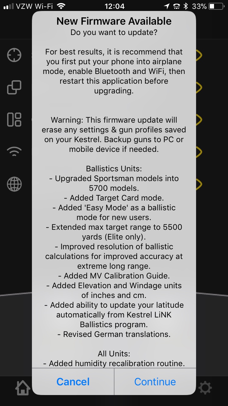

Link goes to the back ground and nothing happens. Tried a half dozen times and now I don't see the update screen pop up anymore.

Good day, may be help to uninstall app Kestrel Ballistics. Then install again clean app and after that i saw that new firmware popup on the screen.

I tried this deleted both links and bal apps and re intalled.no notification and on top of that all my gun profiles gone! Lmao
Hello, you can still send your gun profiles from Kestrel unit to your mobile phone via Kestrel Ballistics App. You need to conect it with BT and send back. Nothing is lost.

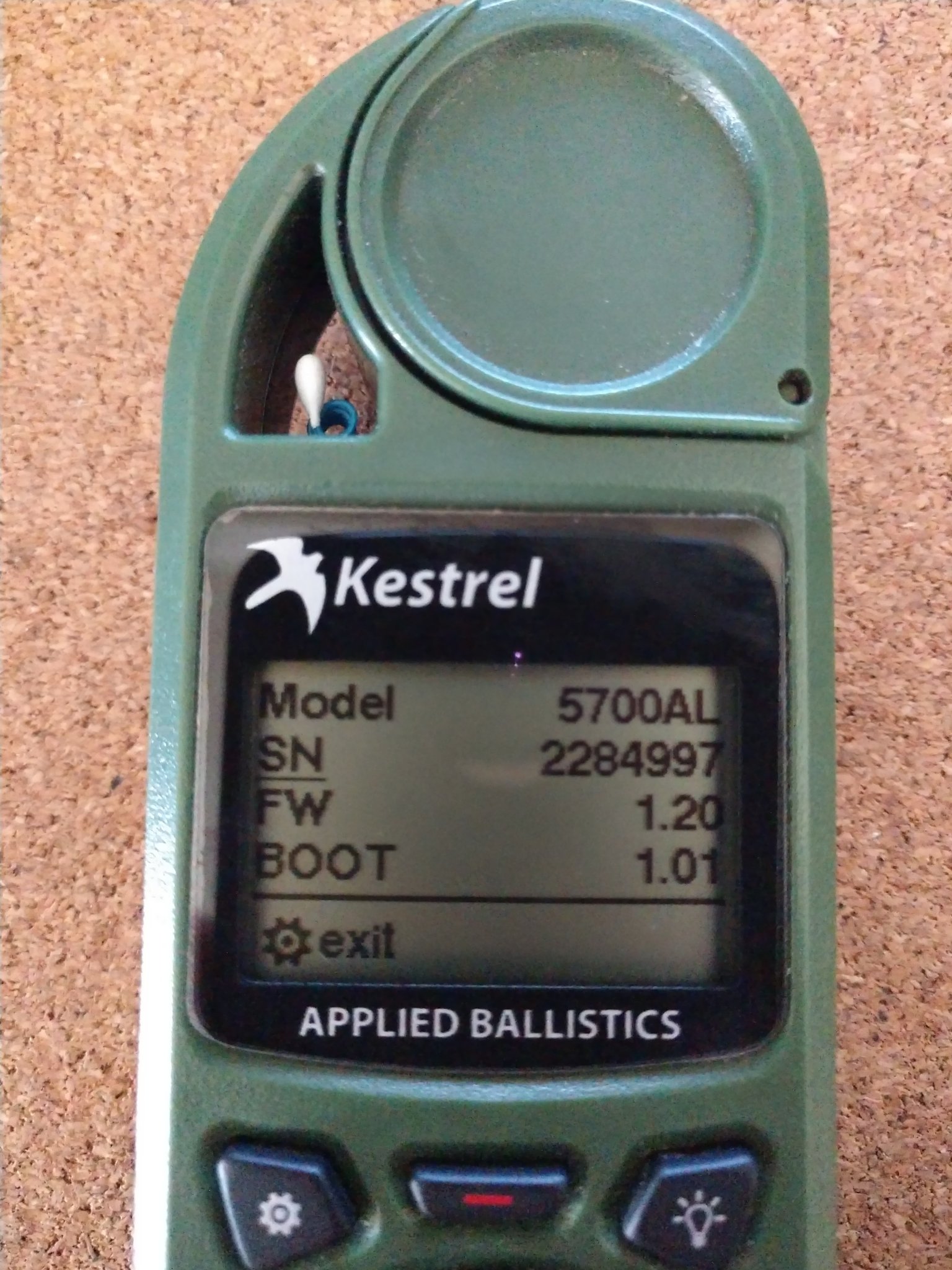

I had to uninstall Kestrel app to see 1.20 update. After that update starts. Without uninstall and install again i did not see new firmware. Thank you for corrected errors.

Sometimes the older firmware update file will get cached on the mobile device (so you aren't notified). You can try clearing cache for the Kestrel Link Ballistics program on Android. This isn't an option on iOS though. Also sometimes going to Airplane mode and back will make the program look for the new firmware update file. As a last resort, uninstalling and reinstalling the app will fix this as well.

1.20 should now be available. Sorry for the wait and we thank everyone for their patience as we want to make sure we are providing the best product we can.
Great, thanks
I am upgrading via the IR cable from my PC (I have a non-Link 5700)... is there a link to download FW 1.20?
Open the Kestrel LiNK app on your computer. Go to Help->Update Your Kestrel and click and run the link in Step 1. This grabs the 1.20 onto your computer. Then connect to LiNK and go to Manage->Firmware update.
Awesome, that did it. I'm all operational now, with all my guns moved over to the new FW. MV Temp appears to be working at least it is changing the MVs based on the temps. I especially like the new "Target Card" feature - very useful for me.

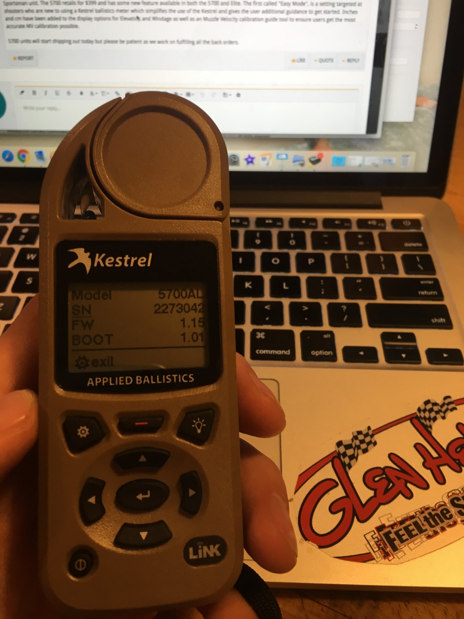

I've tried both the app and the kestrel link via PC. I've installed, uninstalled, followed directions to a T and I'm still on FW 1.17 on my Kestrel.

i cant get the firmware update to show in the kestrel link app when i connect, is there a way to manually force it?
