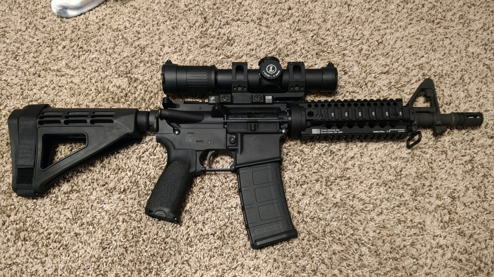

So I'm building a ar15 pistol 10.5" with carbine length gas system.
I've been hearing good things about the jp silent spring. Will it compromise any reliability and does it make a big enough difference to justify the cost?
TIA
