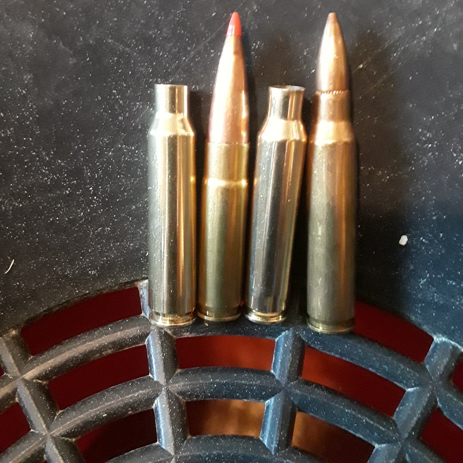

What it's worth, these were fairly clean range brass done for 4 hrs.
A couple of factory rounds for reference. 20181104_145343.jpg20181104_144307.jpg

I run the tumbler with no brass in it for a while when adding more wax. Have not thinned it to date with anything, just put it in, even older pretty dried out bottles of Turtle Wax.

Grungy brass I will use the FART wet tumbler with NO pins. Just hot water, dawn, and a touch of Lemishine. Spares me from having to separate the pins which I do not find enjoyable. The primer pockets are still not spotless and the inside of the case walls are not super clean but that’s OK with me.
Most of the time (90%) its just easier to dry tumble in walnut for about 3 hours. I’m happy with the end result.

20years of cleaning with corn and walnut. My results weren’t even close to as clean as with SS pins, dawn and Lemishine.
