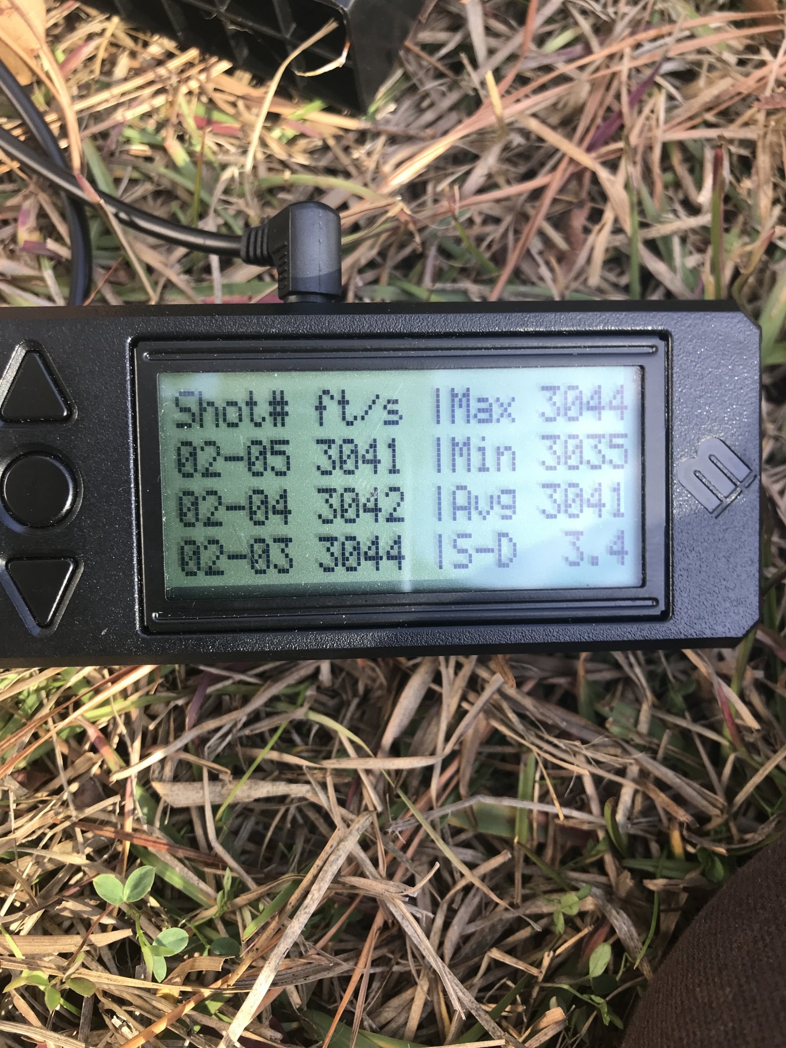

I run RL26 with the 180eldms at 3041. 68.5 grains but it may not be safe in your rifle.
28” brux
Only wish I had a 28” Brux. Sounds like a nice ride. Have you tried RL33? Thinking about it with the 162 ELDM’s as my twist is a 9.5 and not rated for the 180. How were your SD’s, ES and accuracy with the 26?
I have not tried RL33 yet. I have around 30lbs if RL26 left. I use it in my 6CM also.
This brux is a 1:9. I had issues with the 175 ELDXs due to the longer bearing surface but the 180s shoot well. The Proof is a 1:8.
.2s-.3s
The throat is just about toast. It has 1018 rounds on it. I have a Proof Steel that is gonna be finished out at 29” throated for the 195s.
The target picture is the last of load development chasing the lands.
.2s-.3s
Nice! My magnetospeed is so new it only has two strings on it and I love it. I have a Wilson Combat 6.5CM with a 24 inch tube so didn’t look at the slower burning powders. Is your 6.5 a 28” tube as well?

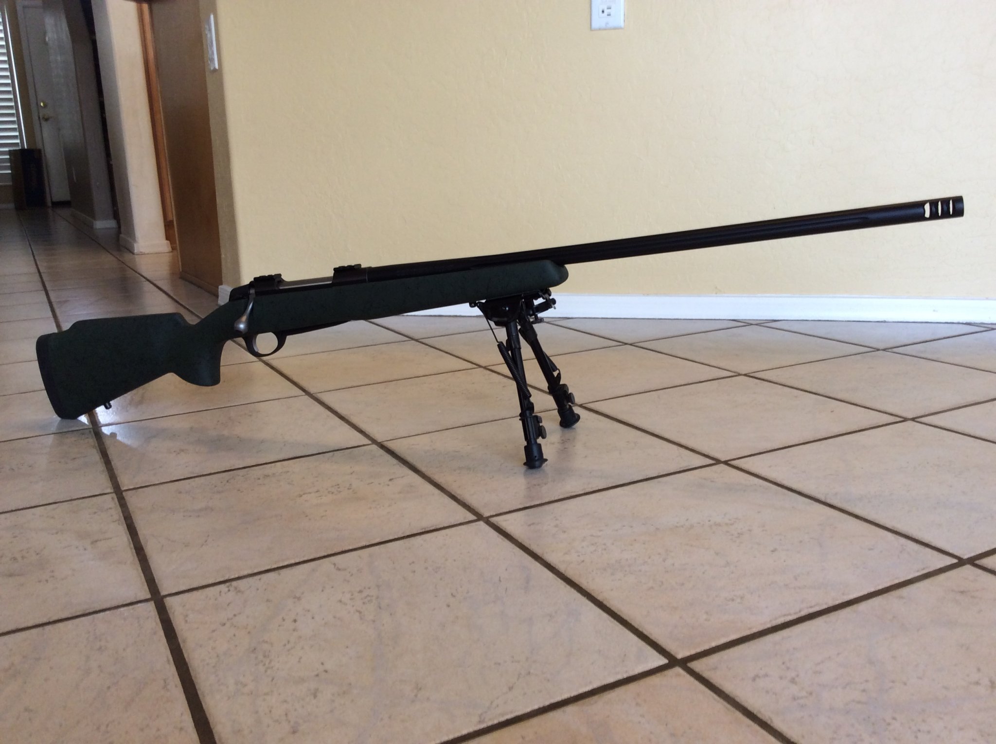

Just got her back from the smith for a new brake and open up the barrel channel. Stainless Lil Bastard, cerakoted to match the blued barrel. Phoenix Precision did a great job and if your on this site thanks guys! Now........Nightforce or S&B.......S&B or Nightforce, that is the question. She’s also getting an Atlas along with a Seekins one piece Picanny. This is my LR coyote gun for Flagstaff area in the spring. 2EC65BB2-0013-4429-8081-EDFC47C6F032.jpeg
